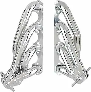

FRPP Stainless Steel come standard with REAL "Jet Hot Sterling" finish and have a lifetime warranty. :nice: Never met anyone who has had to use it. :rolleyes:
