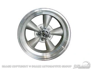

I’m thinking about buying either chrome or polished aluminum bullet wheels for my 100% stock suspension 65 coupe w/289. I thinking about saving $100 bucks and buying the polished aluminum?
This is the brand I'm thinking about buying:
http://cgi.ebay.com/ebaymotors/17-M...3911.c0.m14&_trkparms=65:12|66:2|39:1|72:2148
Anyone have any experience w/ this brand/company?
Also any comments on fitment greatly appreciated. I know I will require a wheel adapter. From dodgestang's fitment guide I should have no problems with the below setup?
Wheel is 17 x 8" - 29mm (backspacing) Replica Bullet style w/ 245-45-17 tire.

Why don't you just get these? They are what the "Bullitt" wheels are imitating, and you don't need spacers or adapters to use them. Besides, the backspace number you gave us must be a typo, a wheel with 1.14 inch backspace would be pretty weird.

They aren't painted, they are aluminum. And they don't require 1.25" thick spacers and dangerously long extended studs, they are actually made to fit your car.
If you prefer bling wheels, get these. 17x8, 4.5 backspace, perfect fit without spacers etc.
Then there's the polished version of the first wheel I posted:
