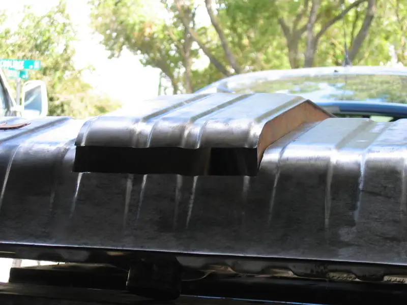

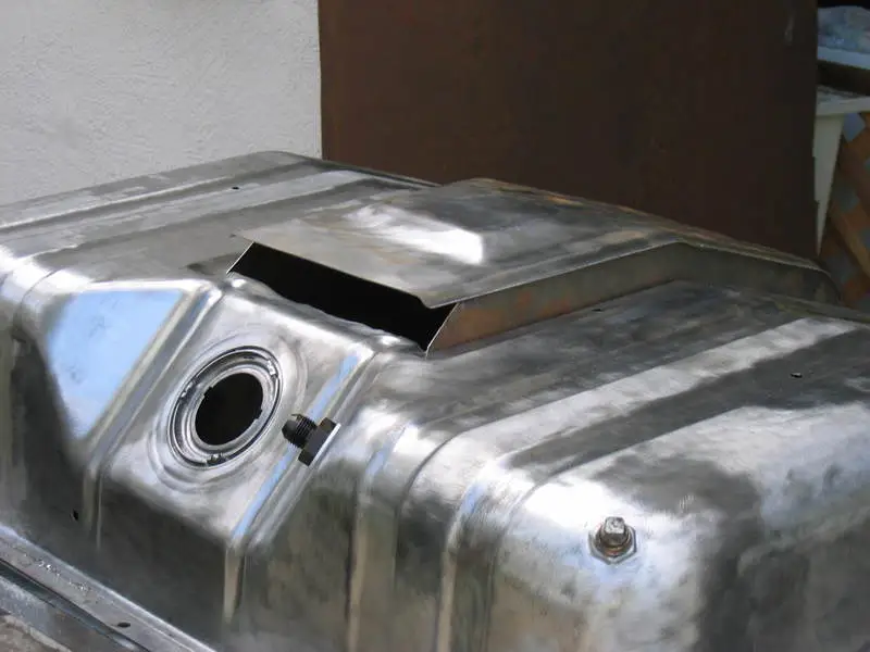

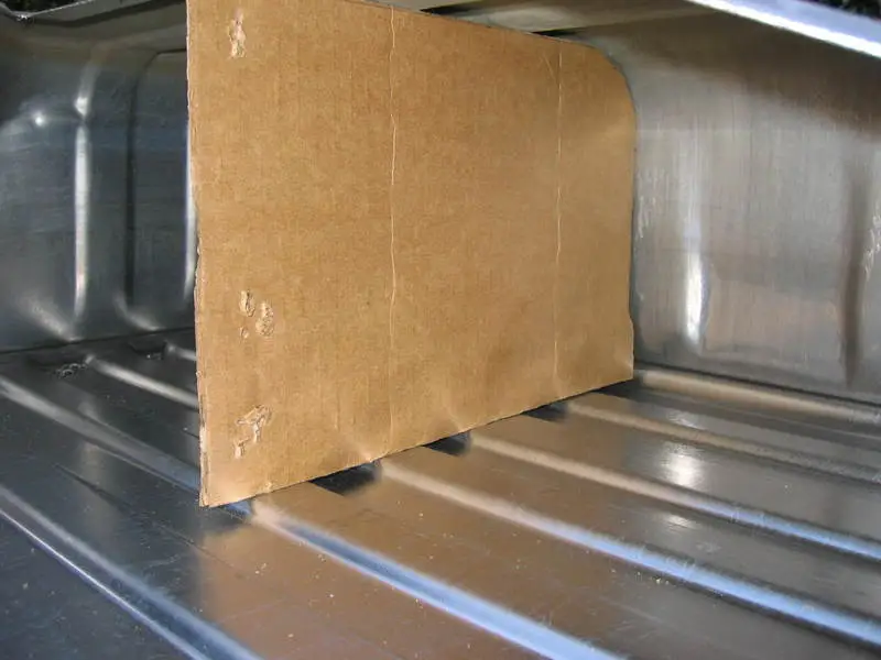

Reinventing the wheel...er...tank
I am taking the path less traveled for the fuel tank.
The pictures below are the original tank from the '66 in the signature. I've decided to baffle, and sump the tank for an intank Fox style pump. The caveat is the fuel lines come out near the sending unit. Actually the sending unit will be the return line. The black #8 bulkhead is the pressure line. It's way over kill, but the advantages are:
  • No Fuel lines in the trunk with the battery and relays
  • fuel pump will be serviceable through the trunk
  • The top of the pump is recessed so a stock trunk mat will sit flat
  • Baffled and sumped tank
  • Kind of stealthy with only a 1" deep sump
    BTW: this is the original tank! pretty clean on the inside. I got lucky.
Good luck with your project.
