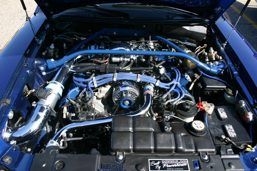

My motor was filthy when I purchased this thing and look at it now..Simple Green works the best

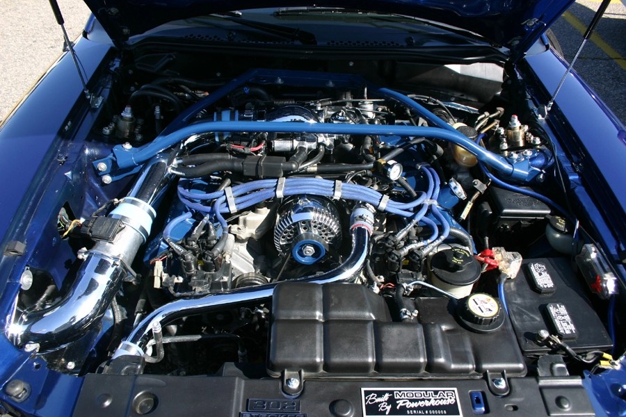

blkstangman88
Apr 6, 2004
646
Jan 8, 2006
#20
  • Jan 8, 2006
  • #20
heres my engine bay after the dealers cleaned it b4 i took it home. i watch them do it, they just strayed degreaser on and hosed it off.
