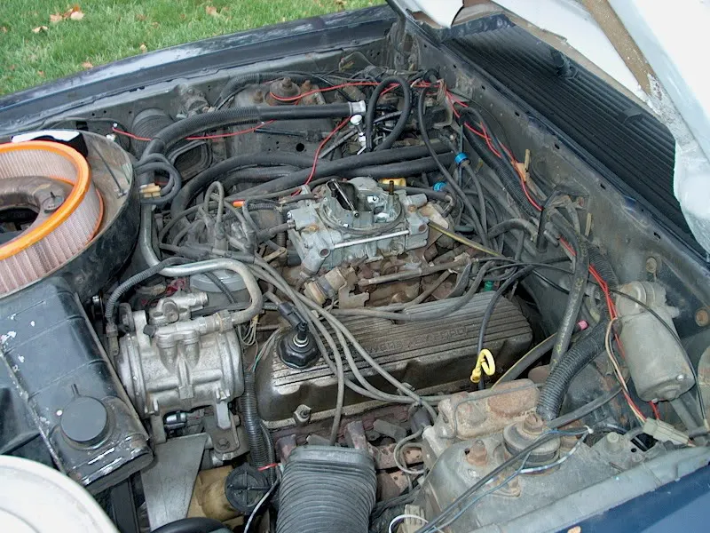

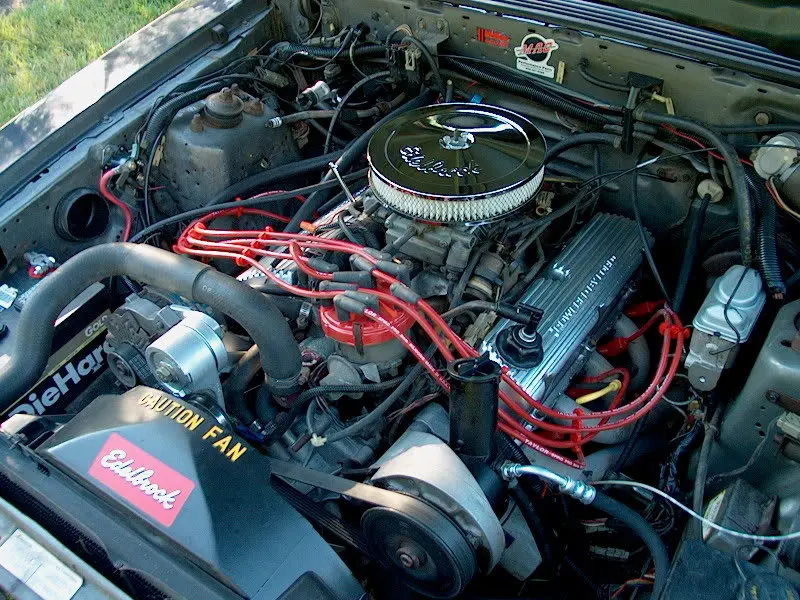

I've used Super Clean, and it works ok, but i've had best results with GUNK Degreaser. Spray everything down (after bagging up the distributor and any fuse boxes you may have) and let it sit for a minute, then pressure wash it all off. I did it waaaay back in the day at a car wash with my coupe when i first got it.
It went from this:
To this:
Granted it was still a rat's nest, but a much cleaner rat's nest.

Wow, that looks pretty damn clean to me. It looks like a different car.
