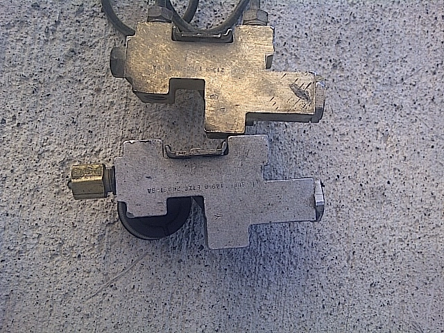

I 'm doing the 5 lug conv on my 91. Not sure what I have here or what else I need. Will one of this MC or boosters work with the conv with rear dics? I can't find any numbers anywhere to cross reference. How can I figure out what I have?
Thanks
pt
[/URL][/IMG]
No
Bottom one looks like a stock 87-93 mustang mc and booster
Top one is a 79-86 mc and booster. Tough to say which one.
Neither one will work woth your rear disk setup...which I assume is sn95 by the caliper show
Kind of what I found too. I know that I pulled the booster/MC of the car when I pulled the rear and the brakes. Nots sure which one out of the 4 sets that I have. Where are the part numbers on the booster and MC? I just found another set....
Thanks
pt
P/N I don't know
Booster is physically bigger than the two boosters you posted earlier. Larger in overall diameter
The MC looks like the bottom MC posted above, but only has two ports and lasts a threaded port on the underside of the MC like that one
I found the MC (bottom one in picture) that I pulled off of the car that had the rear disc brakes. The bottom port is plugged and the MC is different. Bigger and also made out of metal instead of aluminum. The boosters look the same though. I drove the car for two years. Before I sold it, I took the 5lug conv and brakes off.
Will this setup work for my currrent project?

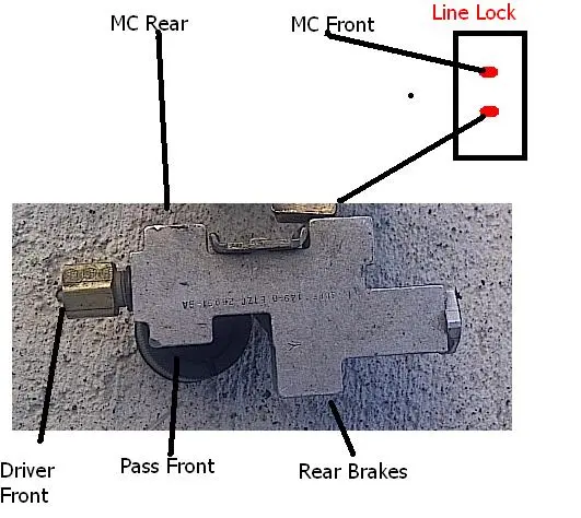

The top valve came off stock fox and bottom came off my 91 that I had 94/95 5 lug and brakes. It's been too long seen I took them off, so I don't remember where the lines go. What brake lines go where on the bottom valve?
Thanks
pt
Top two go to the mc. Rear port of mc to rear top port of prop valve. Front port to front of valve.
The front port on the mc is rear brakes, so the front port on the bottom is the rears.
The port on the left and the rear bottom port next to ot are front brakes. Port at rear is drivers side...port on bottom is pass.
If you order the 93 cobra booster from the zone or Advance you will get the 94-95 booster with the
mounting bolts changed to match the holes in the Fox firewall.
Or at least that's what I got.
I think I messed up the picture for the linelock after I re-read your post. Should it go on the back port ???
Linelocks I do not know that well. If you aren't sure, i'd start a new thread.
I always thought they went to the back brakes, so you can turn the lock on and it prevents pressure to the rear brakes...allowing you and your foot to modulate the front brakes
