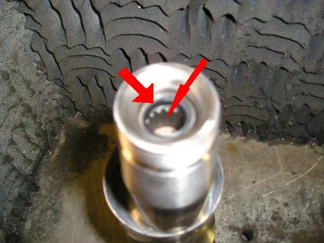

ok, so I got it done, he managed to salvage the flywheel, he replaced the clutch, pressure plate, And the "bearing?" , turns out that the bearing had lost all its little "cylinders".
Pilot bearing, it goes in the end of the crank
(Generic pic)
