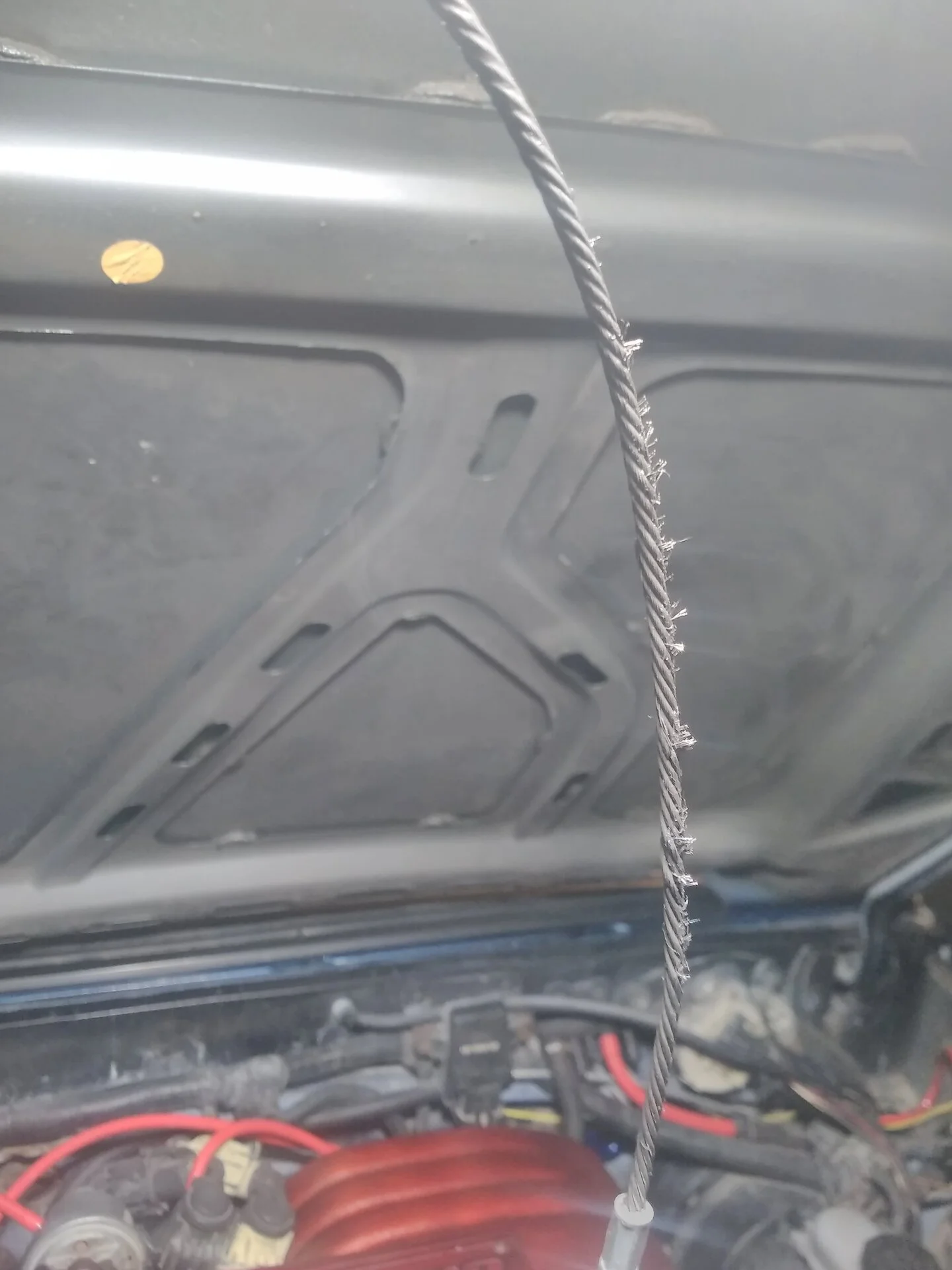

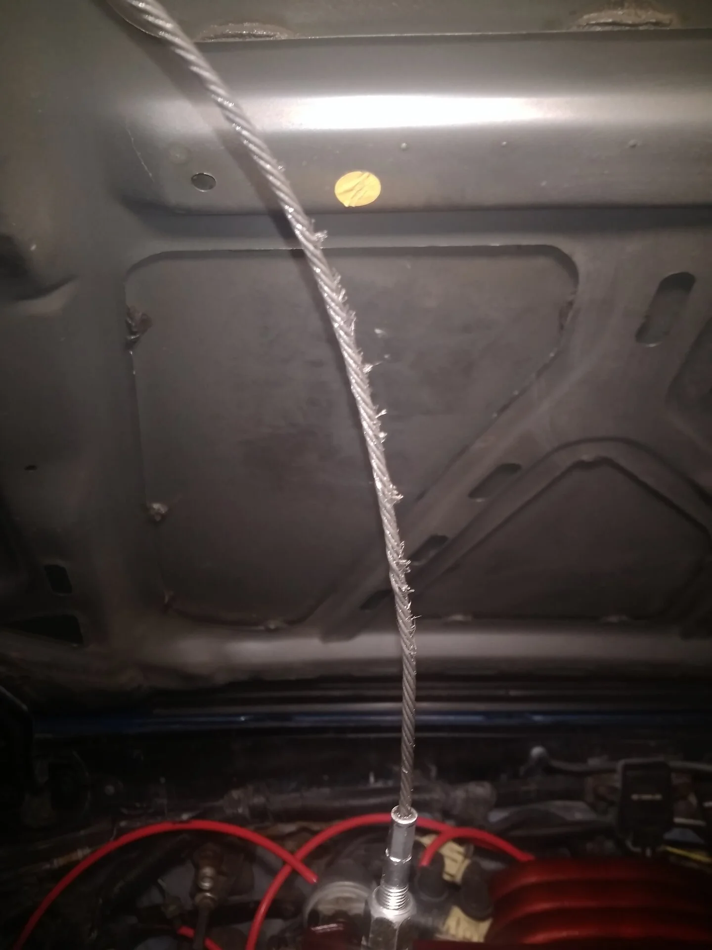

So now that it's the middle of the day and I've had some time in the light to really inspect the cable. It is fraying really bad on the part that is exposed under the car and it's causing it to bind up really bad. I can only imagine it's because I have no dust cover. Ordering new cable and dust cover now!! Thanks guys!!

I doubt it. I don't have one on my McLeod bellhousing because it's not setup for one. Get the MM cable and put a heat shield on it.
So if that isn't the cause of my cable fraying apart in only two months, what could be? It was the cheap 5.0 resto cable. Figured that would be that crappy. Plus it was only fraying near the clutch fork. Could the clutch be throwing material out and cutting the cable?

So after I inspected the cable further, I found the two month old cable is fraying only by the bell housing and making it hard to push in. I know a bunch of people that don't have a dust cover. What else could be causing this? Maybe material coming out of the clutch fork area? The cable is just cheap 5.0 resto crap? I can't really find anything able cables fraying at under 1,000 miles

WTF? I'm gonna attribute that to cheap ass cable. Without sounding like a dick,you'll regret not getting the MM cable.
Well if you're right, that's fine. I'll see how the BBK one does and if I have problems with that fraying then, something else is probably wrong. My last cable was old and dragged hella hard but it wasn't all frayed like that. So maybe it is just cheap ass cable.
