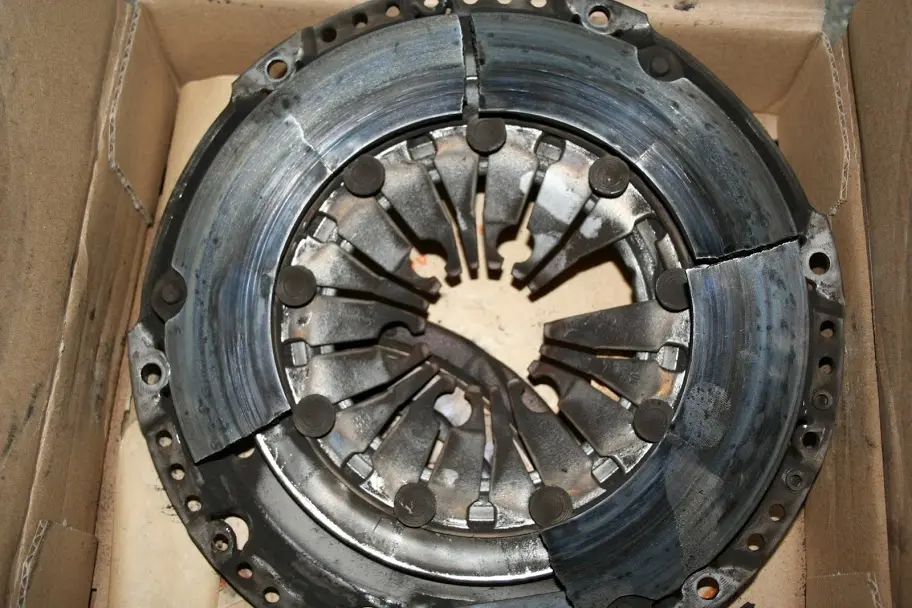

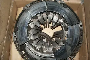

A quick image search comes up with plenty of blown disks (clutch, not spine) and this scary pressure plate. I did see a recent color pic of part of a clutch disc or flywheel sticking out of the cowl vent. If I start taking my car back to the track, a SFI scatter shield or bell housing will be going in right after I burn up the clutch or break the T-5. I predict those events will both happen on the first trip with drag tires.
