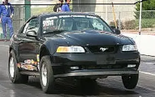

I have one in my car. The advantage is the 80 pounds weight savings. I'm not aware of any disadvantages, if there are any. :shrug: It will help your car do this:
