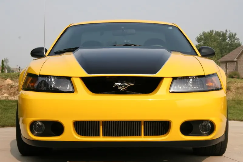

I want to put a cobra front bumper cover on my gt, I know Ill get crap from everyone as for being a "poser", but the cobras look so much better.
Anyway, had a couple Q's for those who have had this done as I know there are a few of you here.
1. does an oem cobra bumper mount the same as the stock gt?
2. how do the fog lights mount?
thanks for any help.
~mark

which cobra bumper are you talking about? the 99-01 bumper or the 03-04 bumper. The 99-01 bumper will mount right up. But I believe the 03-04 needs to be modified a little bit!

1. Yes it does BUT if you are running the stock GT hood then you need to redrill the holes about 1/4-1/2 back from where they previously were. The bumper sits higher than the stock GT hood.
2 The fog lights mount just like the stockers. Did you buy the black inserts for the fog openings?
Here is a pic of mine:

Looks good, nice job on the fit.
