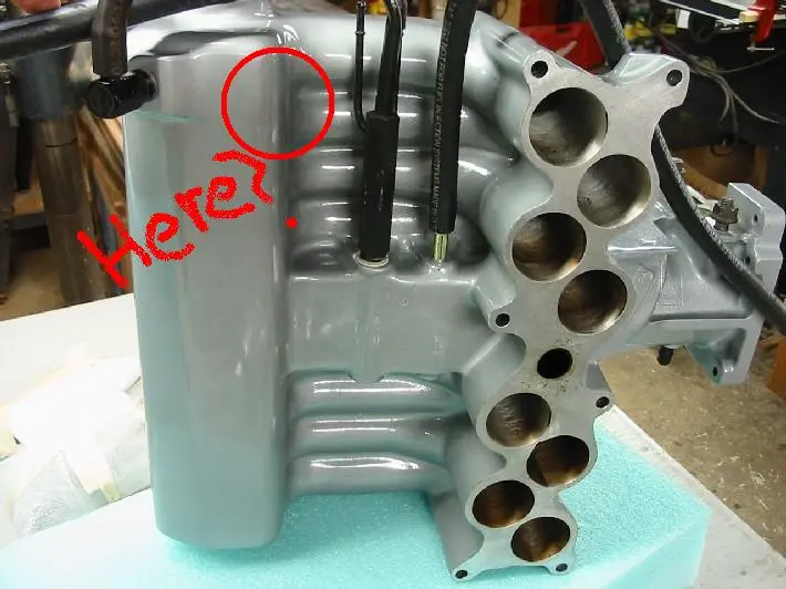

CMANT1914: That is perfect information,thank you. Now I have to measure my VC's. I think I worded my fitting description wrong. The fitting is L shaped, so yes the hose does connect from the side but the fitting screws srtaight up and down into the bottom of the intake. Same exact fitting in RIO's pic in this thread. (just move the fitting an inch to your right, looking at the pic, so it would be coming straight at you or straight down when istalled)
Does that make more sence now, if you compare it to yours? Thanks again

R.J., is the fitting threaded in near the circle in the pic below?

Maybe a little more to the left, but yeah about there.
I think I'm in good shape, I measured my VC's and they are 3 and 9/16 tall. So I'm ordering a 3/8 spacer. Thanks

There's more than enuf threads on those nipples....Take 5/8 or so off it....Mines cut like that to clear the top of the VC...
