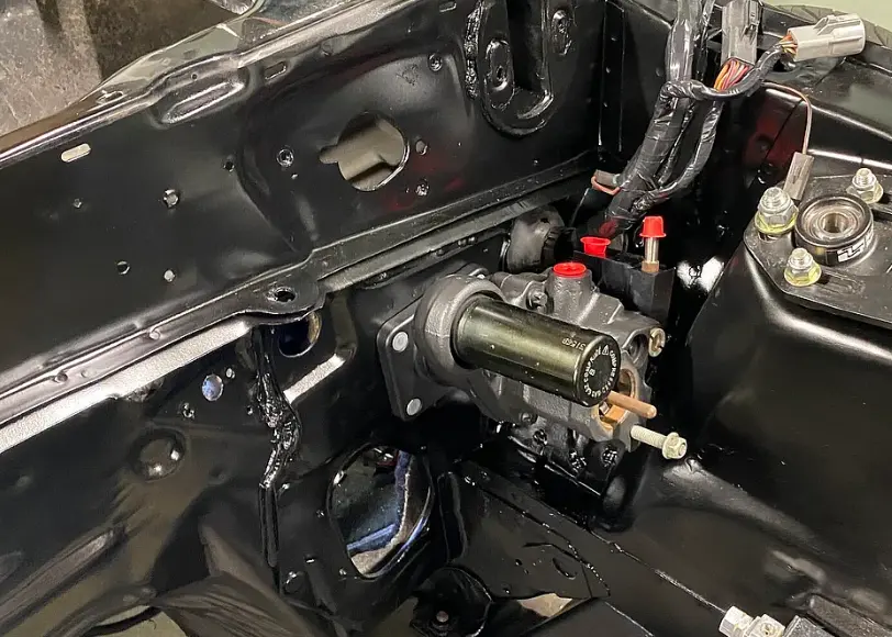

I did the MM hydroboost conversion kit on my car. Was a time vs money thing and all those modifications necessary are what I wanted to avoid.
I totally agree but after looking over the MM conversion kit and since the pedal box has to be removed and you already have to modify the firewall I figured what the heck just add more work to the list. I have the parts so I can have it all set to just pull the fox and swap in the cobra cut and drill and I’m good. I also think I’ve figured out how to template the cobra and transfer it to the fox for cutting purposes Stay tuned
No modification to the firewall. With the adapter installed on the hydroboost, it’s a purely bolt-in affair.
You just need to add the brake pedal to the pedal box. What I like is it retained all the proper supporting equipment like clutch pedal switch, cruise control clutch cancel, and cruise brake dump valve. The 96+ pedal box is different here
Yeah, there isn't much to modify on the firewall. The 96 to 98 kit requires no modification at all (that's what I used) and the newer kit just has you bend the edge of the firewall hole.
I had considered the idea of swapping pedals, but with my car done long ago and a 4v installed it was already a massive pain that I didn't particularly want to make worse.
And just to be clear, the removing of the pedal arm and swapping it out was probably the easiest part of the swap.
I did have this page bookmarked, not sure if it will help.
I vaguely remember it, but now that i see the manual i remember bending the top of the firewall in a tiny bit. It took me maybe 5 mins. Just needed a little extra clearance for the booster.
But after that it dropped right in.
