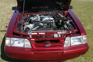

thanks for the info. i will test everything you mentioned shortly. like i mentioned, the lean/rich gauge was not cycling as normal while driving. as soon as the gauge stopped cycling, the light came on, leading me to believe a sensor went. the code 22 came up which as you mentioned, controls air fuel mixture. the car idles fine, runs fine (didnt get into the boost), but it may be running lean as the gauge only shows to bars above lean, where as it used to cycle top to bottom while driving.
if all checks out with the dvm, then i take it the sensor is bad at this point?
im new here and the car is a 1993 coupe electric red with black interior. S/C, 4 wheel disc conversion, too much to type thats been performed at Steeda Motorsports in Florida.
i will let you know what i find with the testing of the wires.
