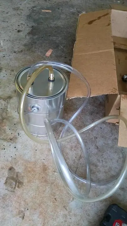

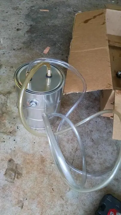

I had a 41 and 91 and it was a vacuum leak. I made a smoke tester and found my leak very easily. Here is what I did. I bought a new unused paint can, two hose nipples and some 3/8 vacuum line. About 10 feet. I drilled two holes in the cover of the paint can and secured the brass hose nipples in the cover with high temp silicone. After the silicone was completely set I unhooked the vacuum line from the brake booster from the vacuum tree and ran (about 7 feet) of vacuum line from one nipple in the cover of the can to where the brake booster vacuum line connects to the tree. The other nipple I ran about 3 feet of line to my compressor set at about 5 psi. I put paper towels in the paint can and lit them on fire. I blewbout the flames an let it smolder (which makes tons of smoke). Sealed the cover on the can and began the air from my compressor into the hose. Then you just look at your engine and watch for smoke to come out. When/if it does that's where your vacuum leak is.
[URL='http://s841.photobucket.com/user/Mstng93SSP/media/IMG_20150123_102846194_zpscafvve0u.jpg.html'] IMG_20150123_102846194_zpscafvve0u.webp [/URL]
Reactions: jrichker
93SSP, I owe you a case of beer!
Your paint can reminded me that I had a vacuum container I made out of a pickle jar somewhere in my garage. I wadded up a bunch of newspaper, lit it on fire, hooked everything up and waited. I saw smoke coming from around the EGR valve.
I took the EGR valve off to inspect and determined the valve seals have quit working. (I pored gas in the EGR port and it sloooooooowly leaked down past the seals onto the diaphragm. I ordered a new EGR valve. I will update once it's installed.
I hope this is it!
