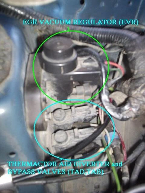

Scratch that. Do you have the egr vacuum regulator still present on passenger strut tower? Is it plugged in? Do you have vac lines feeding it?
This thing
Pretty simple how it works. One vac line in, and another out to the egr. Also a plug to open and close it. What's missing from all this?

Honestly........I think none of that is there. Back when there was a fire I think it burnt that all to a crisp.

Just checked nothing there. Guess I never replaced it
