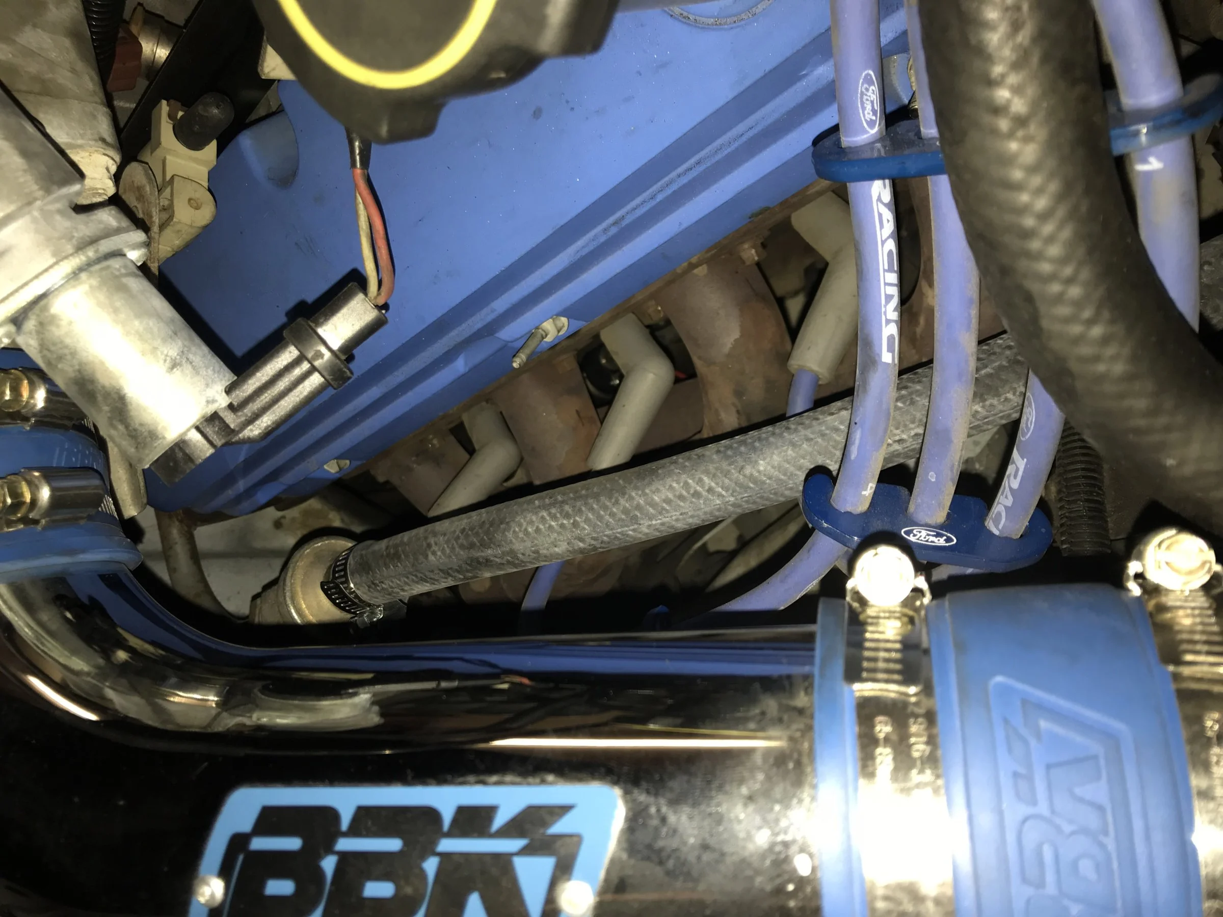

My car just has a rubber hose that goes from the smog pump to the tube that goes to the back of the heads. It’s hard to get a picture of it without taking the intake off, but it’s just a straight rubber hose. Is there supposed to be something in between?

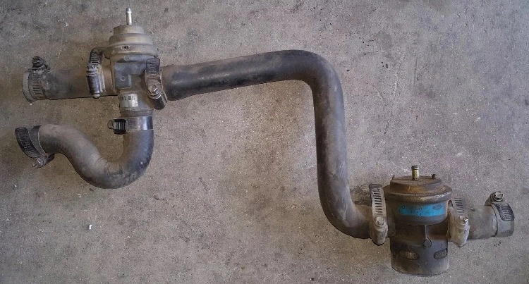

Yea, all that stuff in the picture should be next to the passenger side header

Ok, that is the part of the smog system that the air pump shoves air into, a valve in the middle of that mess diverts air either into the heads or the exhaust depending on engine temp.

They should be there. Looks like you are missing half the plumbing.

Here's a better pic.
Smog pump hooks up at right.
Left side..top to the tube behind heads, bottom hose to tube to the h pipe.
There are two vac lines that run to the solenoids that come from vacuum solenoids behind the pass strut tower. Are those there?

This is what mine looks like

What do I need to buy? I guess I need the name of the valves, or whatever is missing.

Thanks karthief and 5L5. Thanks for hanging in there with me with all my stupid questions. I just jacked up my car, belly full of steak and potatoes, (blah), and looked. I don’t have the opening for the pipe down at the h pipe. Didn’t even notice that the pipe from the smog tube to the h pipe was missing. Remember, I’ve only had this car since February and haven’t messed with the exhaust. Previous owner must have not put it back on. The exhaust is some sort of Frankenstein exhaust. I’ll have to address that. No disrespect to J richter but I wouldn’t have figured it out without your guys’ help. He told me to just figure it out.
