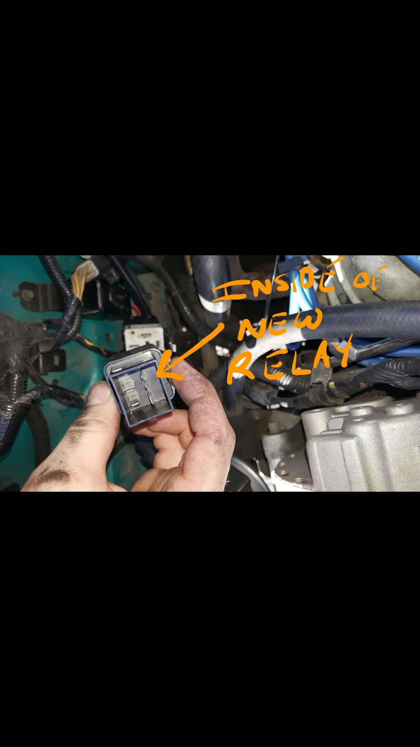

So my 92 LX has been running super rich. Car won't pass emissions for that and fails fuel pressure test. Only symptom car has is it stalls as soon as you first start it unless you Rev it for about 5-10 seconds. Idles and drives perfectly after that. Once warm though, you wont stall once you start car until the next day.

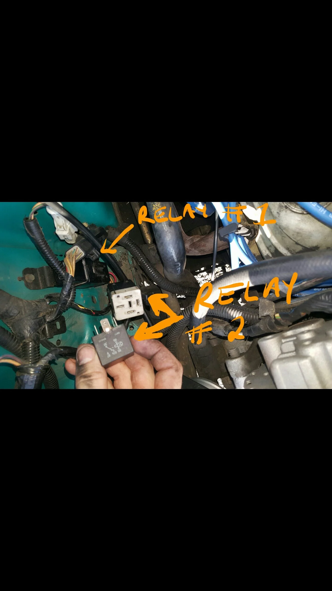

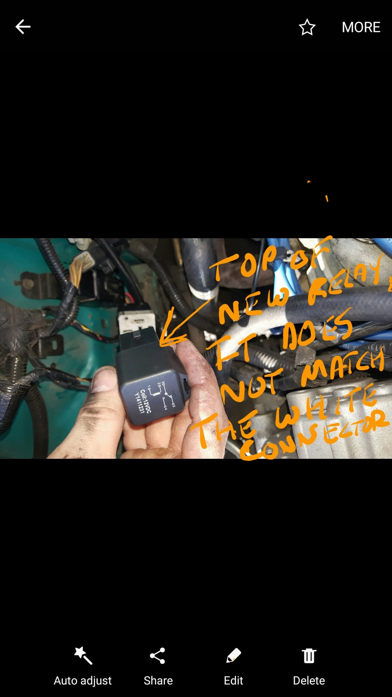

I Bought code reader and constantly get code 96... fuel pump relay circuit.... so for the price of the relay ($15) I figured it would be worth a shot to replace it. I buy the part and search forums and it says up to year 90 it's under passenger seat and after 90 it's in wheel wheel area under MAF. I removed my CAI and saw 2 relays. Can you tell me which is the correct relay, if it is one of those. I checked with autozone two times and their info matches, but the new relay I bought doesn't go into those connectors. There are 3 photos I attached. One shows both original relays in the car, with 1 relay removed from connector. The other 2 photos show the top and bottom of the newly purchased relay from autozone that did not fit either one of those connectors. I must note that the lower relay in the photo appeared to not be stock. The factory plug has those latches on the outside of them for the relay to click into.... that relay that was in the car did not have any sort of safety clip on it, and it was wire tied to not come undone. I hope that helps. Does anyone have any insight on these relays?

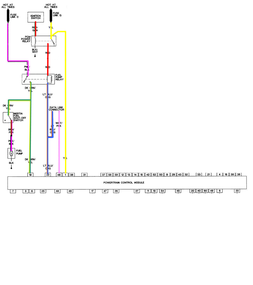

The fix is to note and match the wire color. The fuel pump relay has a red, light blue/orange, dark green/yellow and a pink/black wire..
Diagram of the fuel pump wiring for 91-93 cars.
