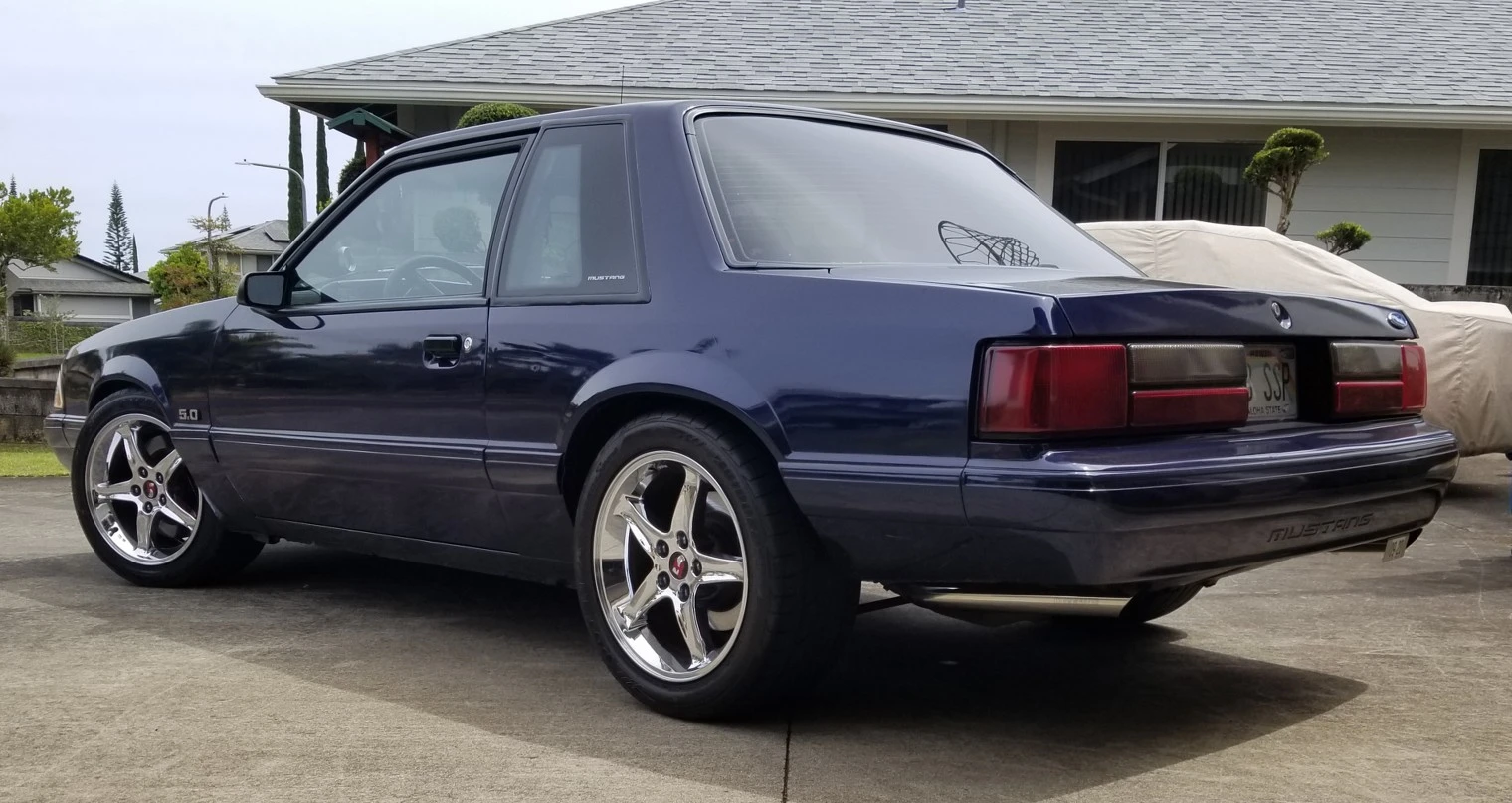

I have that exact setup. Maximum Motorsports coiliver in front, Maximum Motorsports rear control arms with adjustable spring perch. Rids and handles fantastic.

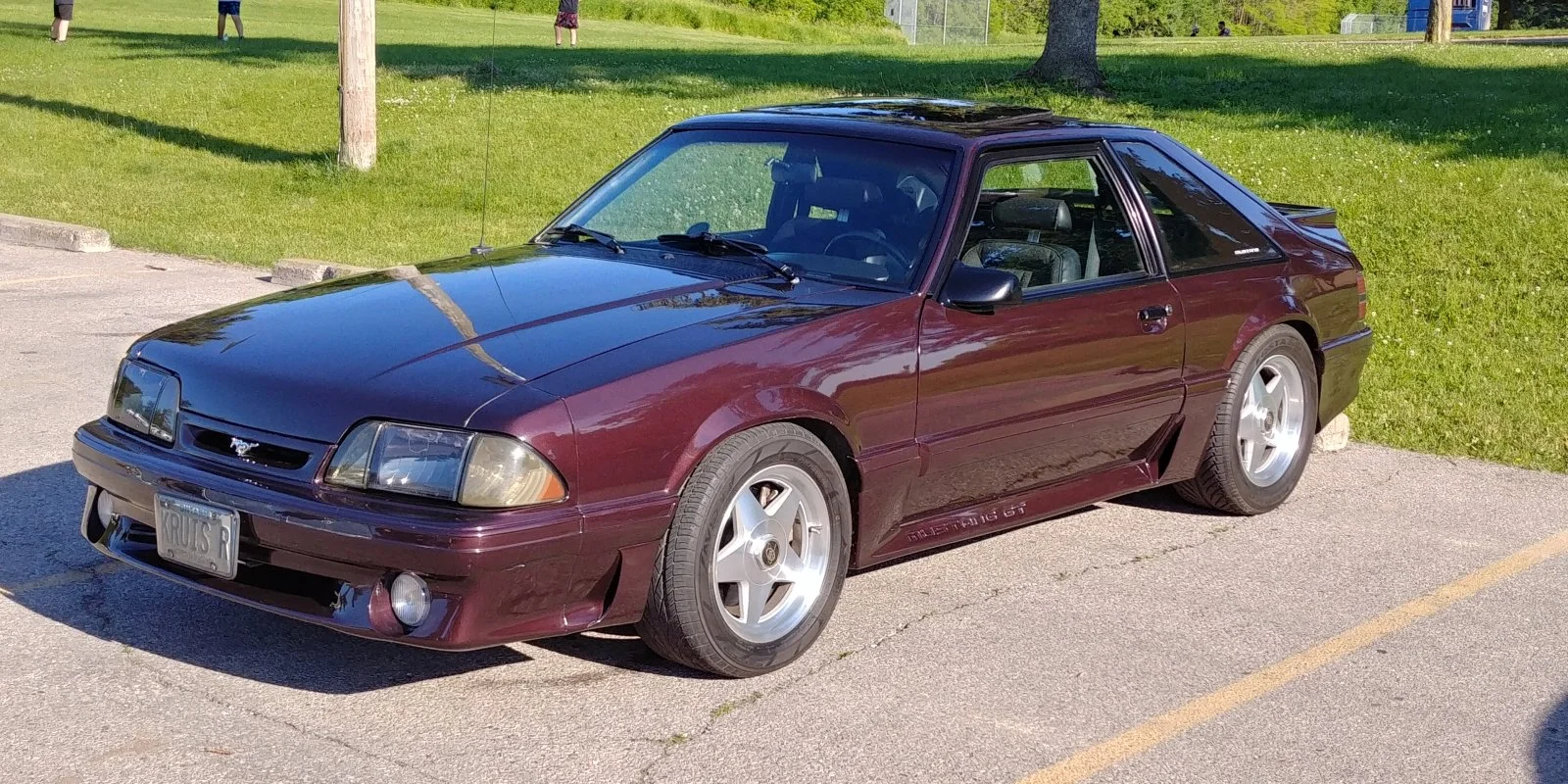

I picked up a Granatelli front coil over kit (15-20 years ago) as I was building parts for a someday project. Currently running that on the front (with 300 in-lbs springs). I did an anti-squat bracket in the rear which dropped the lower control arm rear mount down about 2" and used a stock type arm and springs. It was too low so I needed an adjustable spring perch to bring it back up a bit. Picked a pair up on eBay for $50 I think. The Granatelli kit was $150-200 back then.
No complaints with either set up. I was going budget build all the way.
