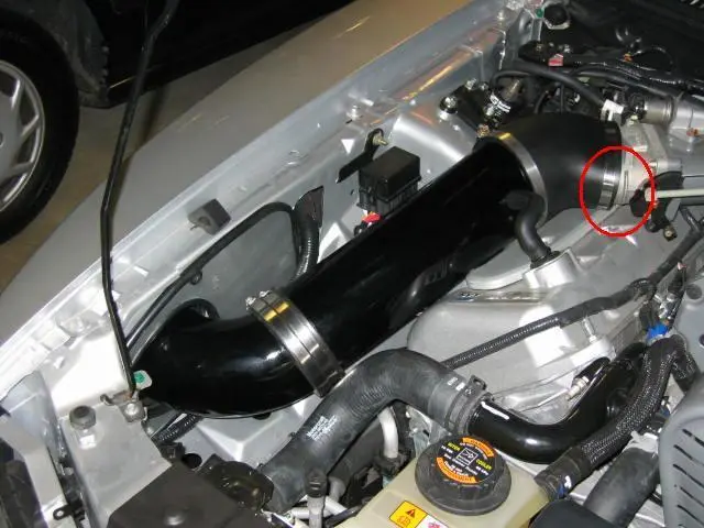

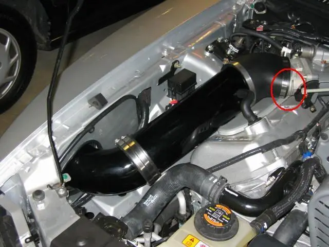

Just keep in mind if you even want to look at the filter or MAF to inspect it you'll need to either pull the inner fender liner back so you can see it or you'll have to disassemble the unit itself and pull the MAF & filter out of the fender. Be sure to look VERY CLOSELY at the rubber boot that mates the JLT to the throttle body. The rubber boot provided does not aways fit properly when initially installed and requires some adjusting from what I hear. I've seen a couple pictures of JLT installs and both of them portrayed poor fitment in this area.

i noticed that too where it meets the throttle body, but if it is tight and the dyno is right?
My JLT cold air wasn't difficult at all to install. Of course I had help from the wife so being that it was a two person job, it definitely helped. Servicing the filter isn't hard as long you raise the car up and remove the tire to gain easy access to the filter. Might just take a little time.
