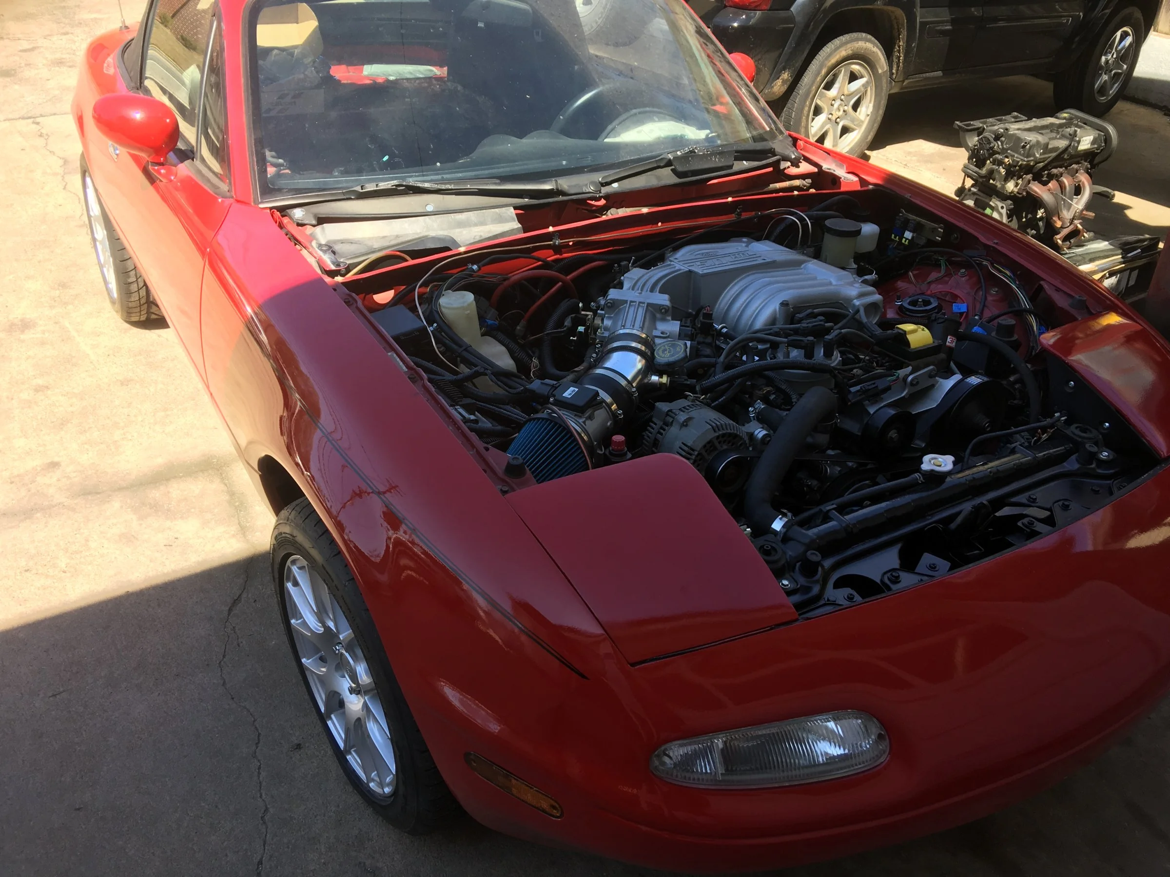

This gives a pretty good engine shot. Thanks
