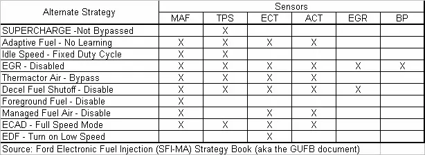

When you unplug an EFI sensor you send the ecu into a 'limp mode'
The limp mode is a crappy way of running the car, as several strategies are ignored.
Just because the car runs differently with the sensor unplugged, does not mean that there is something wrong with the sensor. This applies to ALL sensors.
Find out why you are having problems, and make the appropriate changes.
Step one is to pull the codes...
Here is a summary chart for how the ecu reacts to out of range sensors (straight from the GUFB).
