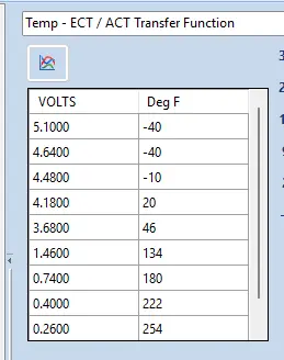

Sounds like a bad or failing ACT and ECT sensor.....New means nothing if its faulty or not calibrated right.
Theyre easy to test using a digital voltage meter and a thermometer to read coolant temps to coinside with voltage.
