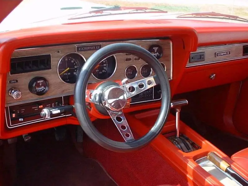

I have a Mustang II 1978 With color trim code : CT does anyone know a match for this color ? Since i have a red Dashboard i like to repaint and install. Thanks
Svend
I painted my interior with Dupont vinyl paint. These are the numbers from my paint can. 44200vh. Code: 40756. Color : LT RED MED/G. Use 304s vinyl resin for low gloss. Use 305s vinyl resin for medium gloss. Use 306s vinyl resin for high gloss. Yr 1976.VOC-LE : 5.7 VOC-AP: 4.3. I used medium gloss. These numbers are from 1997 when I did my restoration. Hope this will help.
