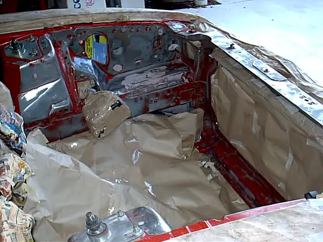

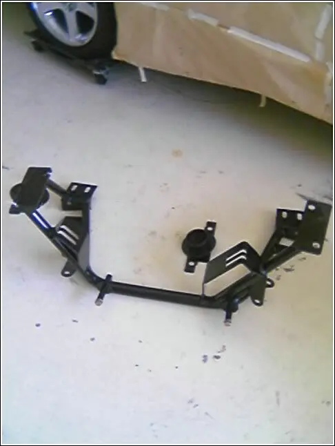

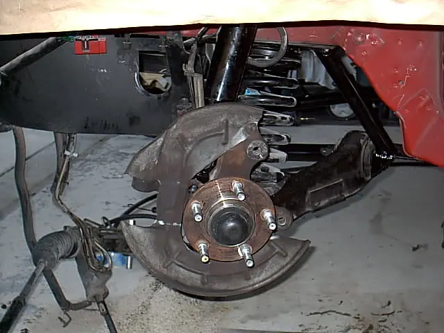

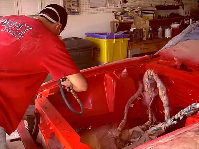

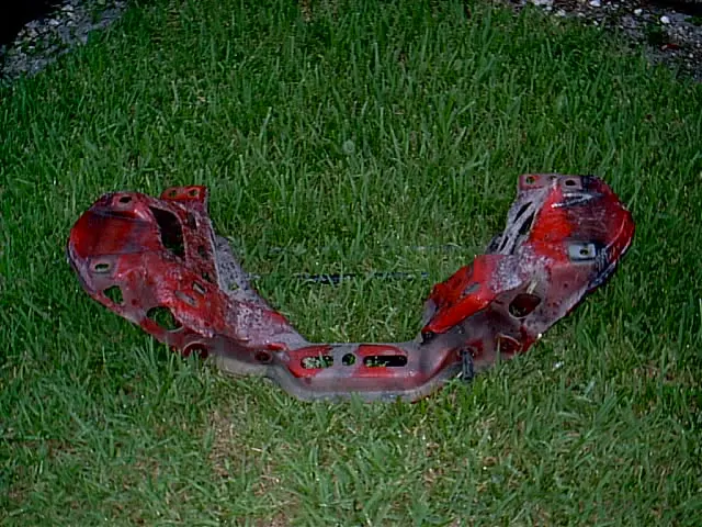

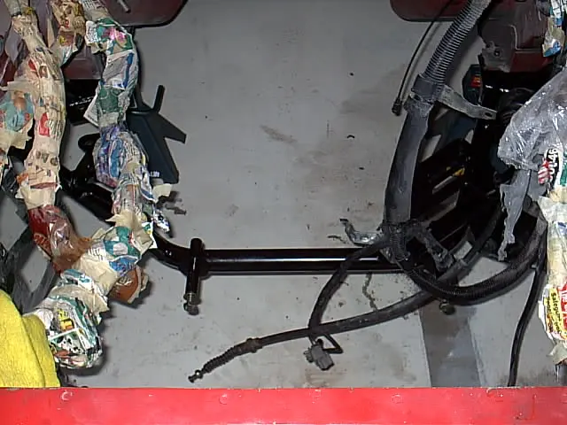

You can get the QA1 Tubular K-Member and use the stock A-Arms. Just requires some grinding the A-arms to clear. I went this route on my 94. Plus I had MAC 1-3/4" Ceramic Long Tube headers. These probably would have been a PITA with the stock K-Member. I painted my engine bay while I was waiting for the 347 to be delivered. I also hid all the wires I could into the fenders. Wanted to get rid of the spaghetti wires.

I got the QA1 K-Member because it was the only one that could be used with stock A-Arms. Are there better K-members? Yes. The TeamZ and Maximum Motorsports do make better fantastic K-Members. I bought the QA1 for $219 and since I used the stock A-Arms that was all I spent. I had just dropped $7K on a 347 and exhaust. Since the motor was out I figured getting the K-Member would be a good idea. However funds weren't available for an entire coil over set up but $219 was a steal so that's what I did. If you can swing a TeamZ front tubular suspension then do it while you have the chance. Email Tom Z. and he can give you a deal on the suspension if you buy a complete kit. The 10-way Strange struts and shocks from him are priced great as well.
