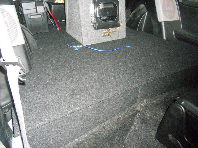

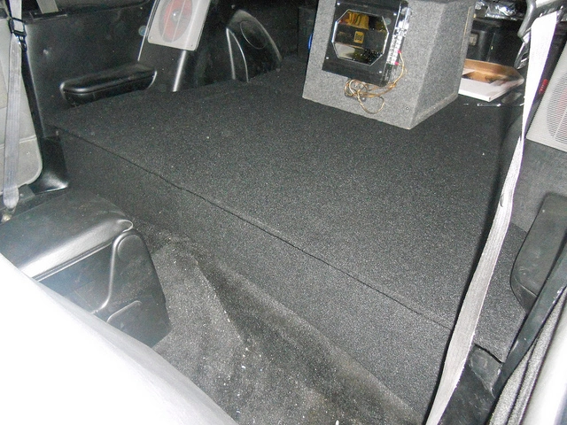

well, I got it done. came out really nice if I do say so myself.
I decided not to cut holes at the spare tire nor up front. The front half of he lower part is secured to the "lid" and the right side is removable to gain access to an amp I have bolted down there. The amp in the pic is now gone, made way for a larger one. Works great and it fit perfectly.

guys, sorry about the super late reply here... my edelbrock heads turned up with broken valve springs and the car was down since November... anyway, thank you for the positive feedback and advice! I used a 1/4" fiber board from home depot, made two templates out of cardboard, and went to town on the board with a jigsaw. Covered it with carpet rolls from Oreillys, and attached it with upholstery nails.
I made a backseat delete ONLY because the bottom seat brackets that held the seat were broken, as were the attachment hinges on the seat backs. I looked for complete backseats at local junkyards, ebay, everywhere but never found anything of use.
So, instead of paying $250 and up, I made one myself. As for the battery, yea I wanted it in the spare tire well but I didn't want to cut that back piece and lose rigidity. As for the sub, it is a 90's box complete with an old school bazooka sub. It's been replaced with a very low pro black box with a downward firing 10" kicker. theres an inch of space between the sub and the delete kit.
I plan to buy a nice showy Optima billet cage once I finish my headliner and sunvisor changes...
Thank again!

oh, and the new amp is in the hidden cargo spot behind the driver seat. removable panel.
