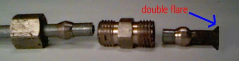

to be legal it has to be a double flare which is easy to do with a double flaring tool
assuming then you cannot use a compression fitting at all then right? even if it's like this? i modified this pic to look like what i would do.
it's not the correct way or safest way to do it, but it will hold.
Eventually the line will push it's way past the compression fitting ferrule, resulting in total loss of brakes, but this could take a while.
I would just get a short section of steel line, cut and double flare it and make the repair right, that way i don't have to worry about/check it periodically.
Now if this is just a river runner, go right ahead.
Compression fitting is a really bad idea.
Go out and measure the length of the line. then bring in the old line to a parts store. They have straight lines with fittings and flared on both end. Buy a cheap $5 tube bender and then emulate the bends on the stock line. Should not cost you more than $15 and 20 minutes to fix.

Take Matt90Gt's advice and stay out of trouble.
The small cost of buying a pre-flared line with fittings is a lot cheaper than a trip to the emergency room. It is even cheaper than a trip to the junkyard to buy parts that got bent when the old line failed.
