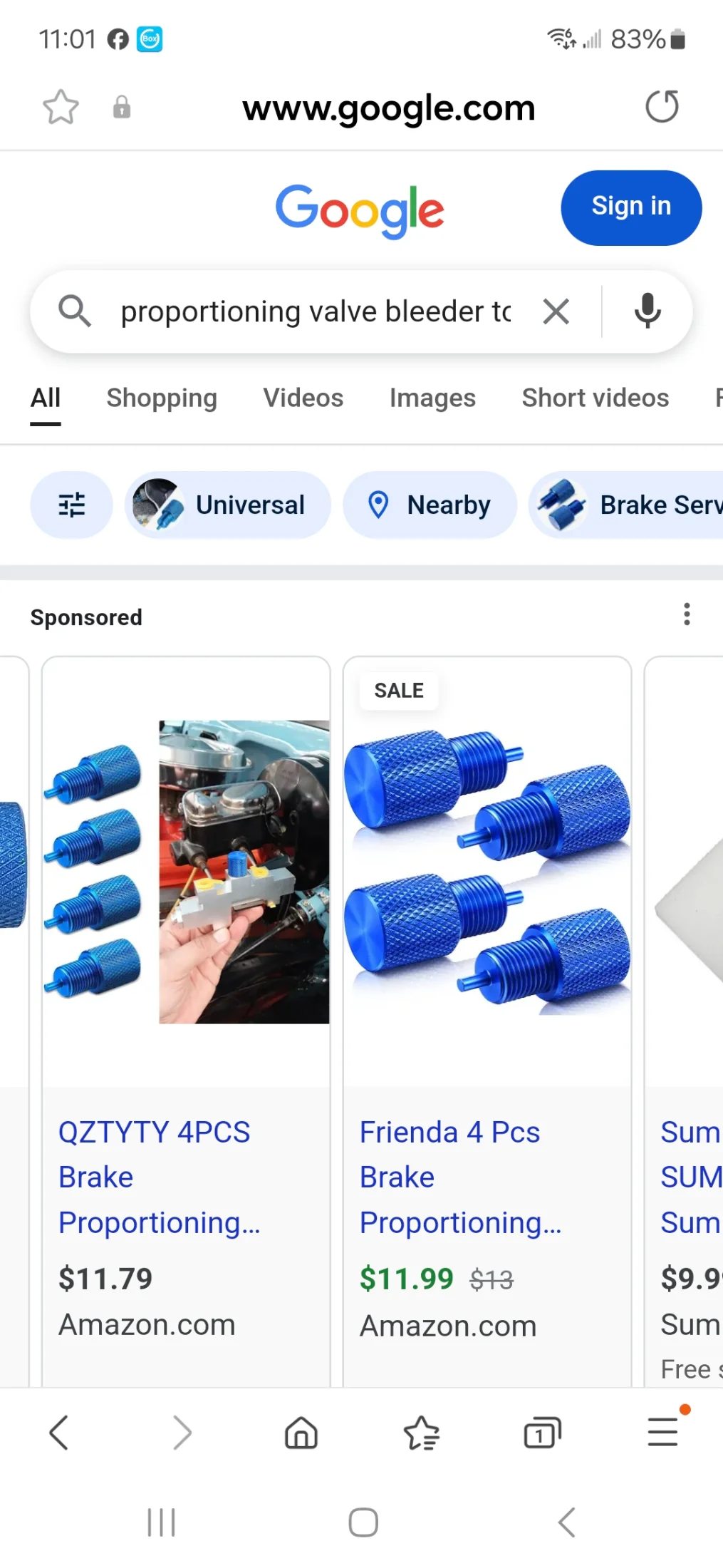

You need one of these centering tools for the proportioning valve to do a propper brake bleed ,make sure to order the correct size. Unscrew the brake trip switch in the proportioning valve ,it the white two wire switch ,use a light and you will see the notch in the internal piston ,someone will have to push the pedal to center it . If the notch is to the front open a rear bleeder and step on the pedal slowly ,it will move back ,if it is to the back loosen a front bleeder and step on the pedal ,it can be done by one person but way easier with two .
Once the valve is centered and the tool screwed in place then bleed the brakes. When finished unscrew the tool and replace the white trip switch

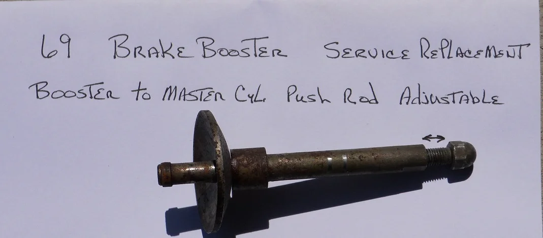

Once everything was back together, the brakes still sucked. Adjusted the rod out until the brakes started to drag then shortened it by about 1 turn and they worked great.
Thanks for the update. Liked your performance report on the vendors. "adjusted the rod out" would be the master cylinder push rod? Brian
