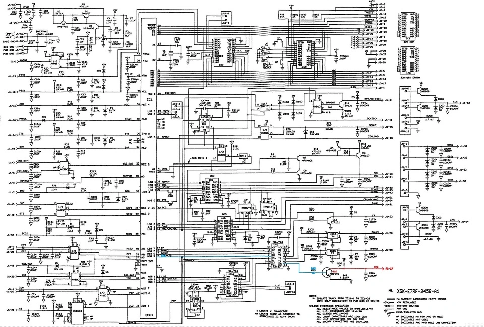

Update:
I probed pin 17 at the computer (STO, CEL) and in start and run, it maintains battery voltage, like it's supposed to. When I initiate the self-test via the jumper, I believe the computer runs it because you can hear the clicks and hum of the computer doing stuff.
However, the computer never grounds STO to illuminate the CEL. I believe there is a simple defective transistor that's not switching to do this. Problem is, theres no way of knowing which one it is without a schematic.
Does anyone know where I can find a schematic of the internals to the computer?
R
Ryan Hardy
Mar 3, 2013
31
9
NW Indiana
Apr 29, 2015
  • Apr 29, 2015
So I was right about the transistor. It took hours for me to find this schematic, but here it is. In the lower right corner (colored in red) is pin 17, hot in start and run. If you follow it back, you see the transistor (Q10). I did draw the circle around it, because transistors are supposed to have a circle in an electronic schematic.
Think of a transistor as a relay, turned on remotely to allow a higher current to pass through. In this case, the remote (bias) is in blue, and you can see it leads to a multiplexer (kinda like a hub for input/output computer signals), and all the way to the processor itself. So when the processor wants to output codes or turn on the CEL, it sends a small voltage out through the mux, to Q10. This would be like the voltage to the coil on a relay. This causes Q10 to "turn on" or conduct current, providing a current path for the battery voltage from pin 17 to ground, illuminating the CEL.
I verified that the processor is commanding Q10 on via a bias voltage, but Q10 is not responding, and so the CEL doesn't light up. Transistors, unlike capacitors, don't show signs of malfunctioning, unless they have been subjected to a very high current. This one appears to be fine on the outside. When I find a replacement and repair it (these are obsolete, I'll have to find suitable replacement), I will post a couple more pics.
Thanks for all your help!
