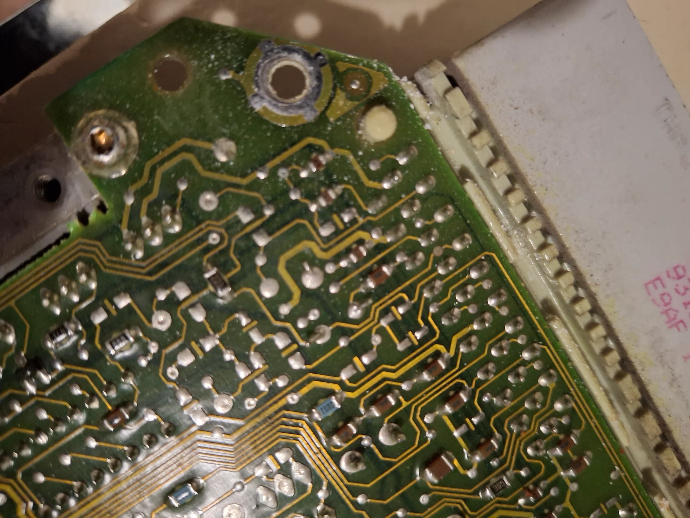

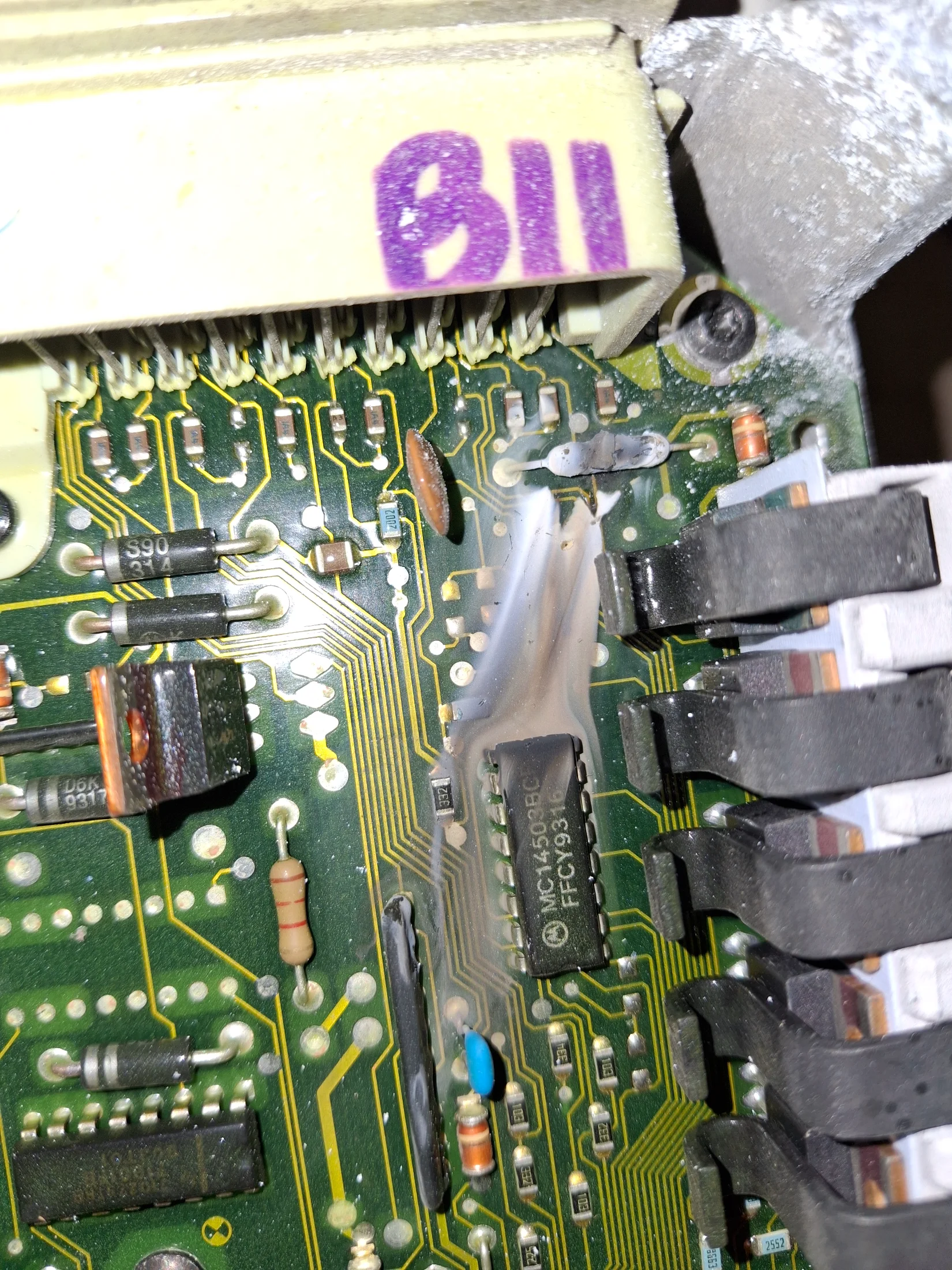

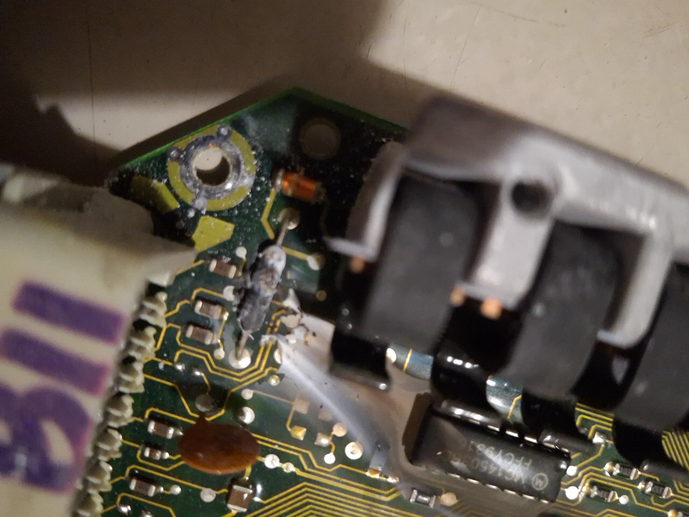

Im trying to help my neighbor get a mustang going he inherited from his buddy after passing away. The car died one day and never started again. KOEO the check engine light never comes on. When the diagnostic port is jumped the check engine light come on and stays on (never flashes). I verified power and grounds at the ecm were good. I pulled the computer out and opened it up to find what I belive is a blown resistor that connects to the first mosfet closest the the failed component. Any suggestion on if I should do for repair would he appreciated and hopefully somebody knows what this part is so I can order a new one. Thank you for your time!!!

Have not seen a PCM fail like that before. A short somewhere could have done it. Got a picture of the bottom of the board to see the resistor component legs? Swapping the computer for a refurbished one may be a good move, but a repair could be cheaper if you already have the tools.

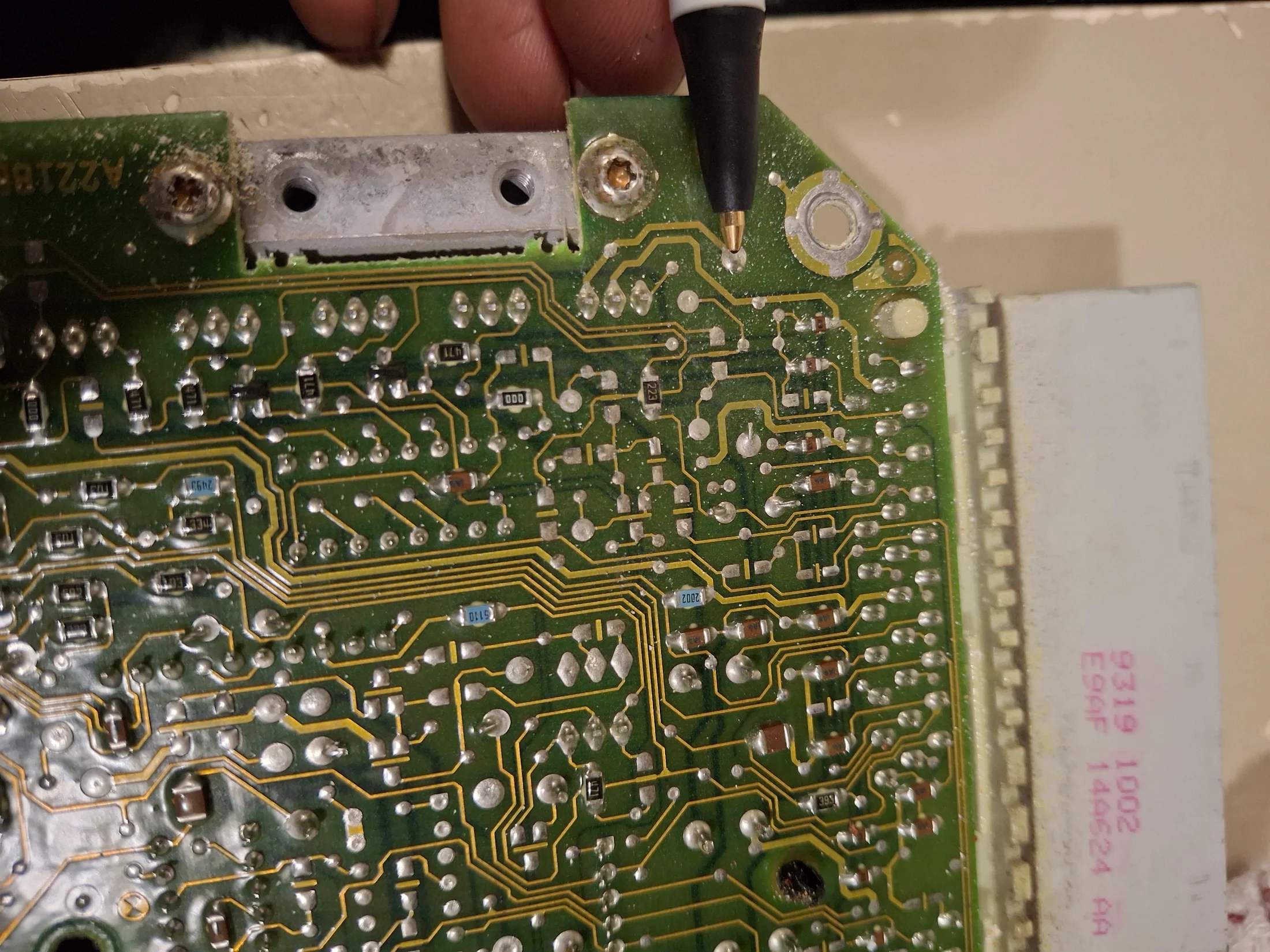

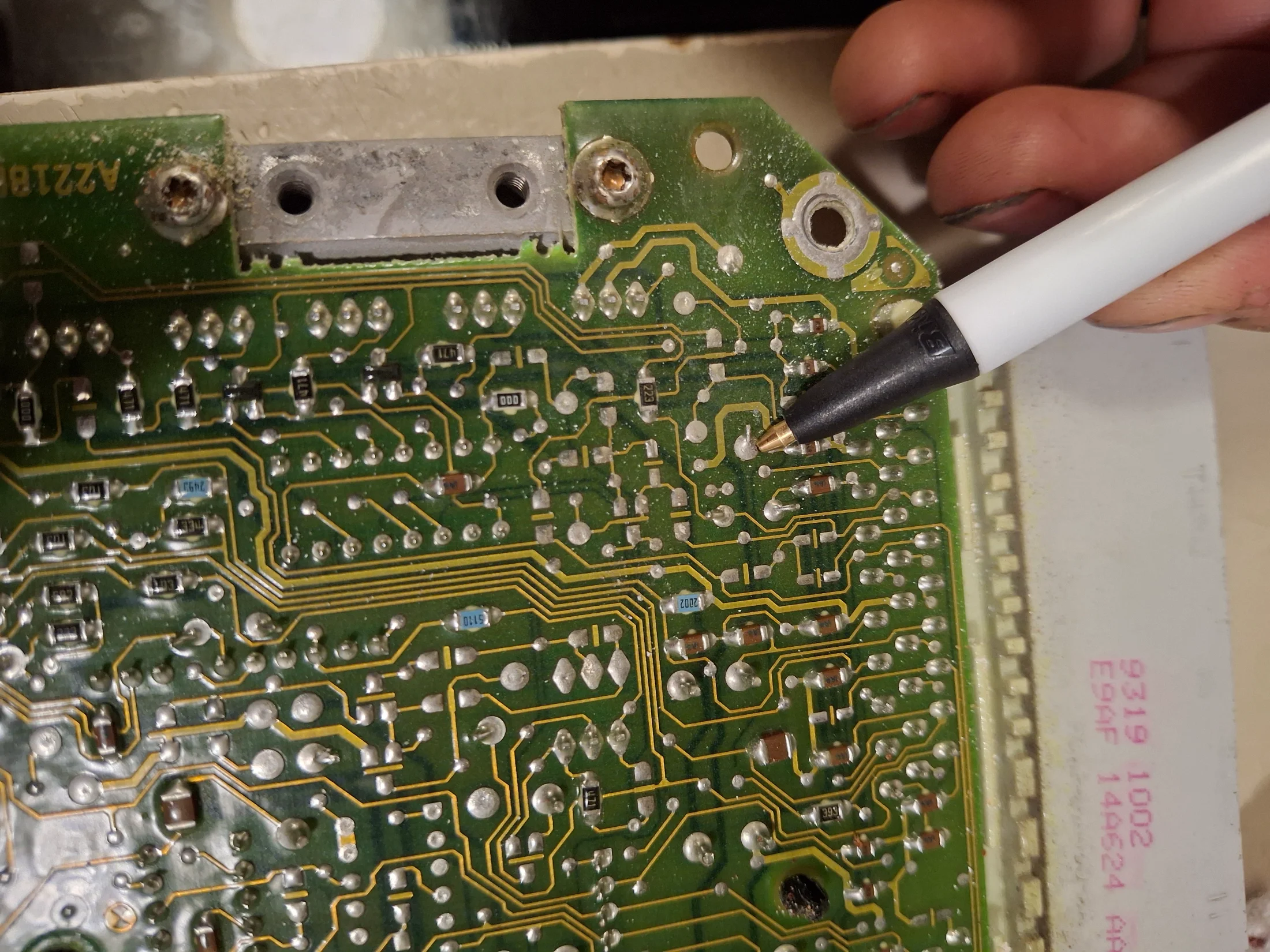

I have good soldering equipment and feel comfortable replacing anything recommend just to try but I see one leg goes to the closes mosfet but the other leg i can't see any connections making me think this board has two layers... I took a picture of the backside and pointed a pen at each leg. I guess start by removing and testing the mosfet?

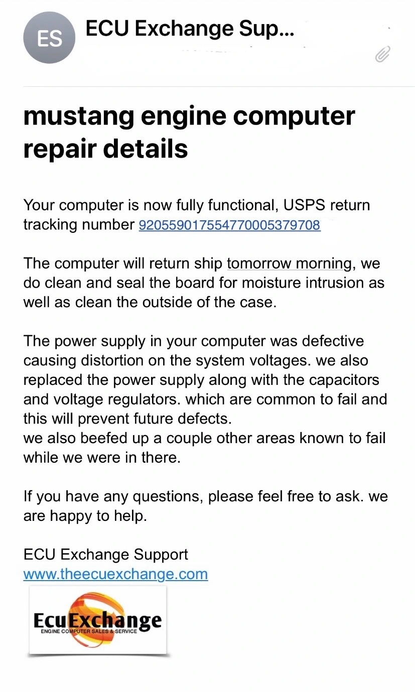

If you don't mind sharing, what specifically were the issues they found and corrected? The idea of issues that were physically present, but hadn't yet manifested in how the engine runs, perhaps because they become relevant only under certain conditions not yet experienced, or were caught when their effect on running was so slight it wasn't yet noticeable, etc. etc. is very interesting to me. It's like finding and treating a health problem in a human that'd been silently waiting to kill ya

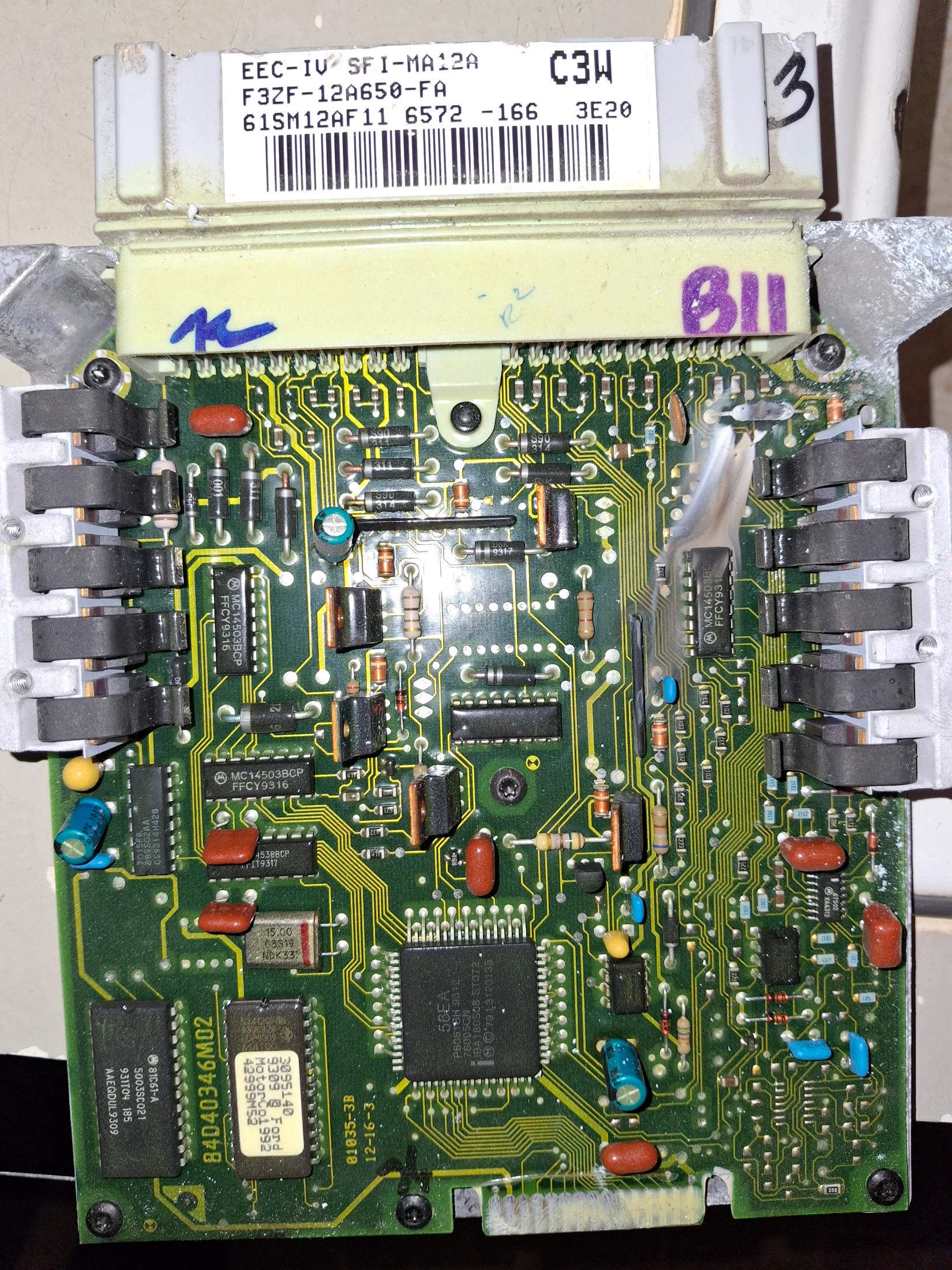

This is what they sent me via email when my computer was repaired a few years ago.

That's usually an over voltage issue, I'd check for more issues than just that if you plan on repairing it yourself, betting its not the only failed component..
