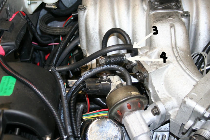

where do I connect the vacuum lines labeled 3 & 4 in my picture here on my 95 cobra intake? Does anybody have a picture?
thanks

I don't have any pics, but 4 (big one) goes to the brake booster and the other two normally go to some colored hard vacuum lines that run to some solenoids in the fender by the shock tower then come back out and run to the EGR, fuel pressure regulator, and check valve behind smog pump.
