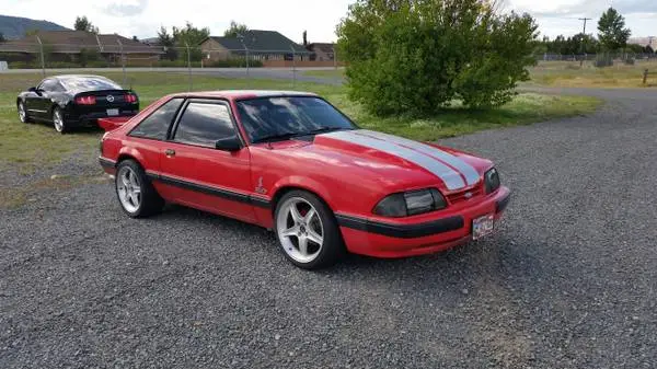

Hey everyone. I am new to the forum, and mustangs in general. That said, I am considering buying my first 5.0. I found what looks to be a nice car, minus paint and a little interior work, but am unsure of whether the price that the seller is asking is reasonable. I would also like to know what specifically to look for, problem areas and what not, when I go and look at the vehicle. Here are a couple pics, as well as a description of the car
I have a 5.0 mustang that I need to part with due to personal reason's, but its a built 5.0 302 fuel injected roller motor, 1.6 frpp roller rockers, e-cam, 5 angle valve job port bowl polish. 19 lb hi impedance injectors, cold air, 4 row aluminum radiator and more. rebuilt t-5speed transmission frpp clutch. shorty headers to h-pipe and force series flowmasters, this car sound mean... We took a svt mustang used rearend and susp parts.. converted to 5-lug rear disc brakes,car is built right.. has cobra R hood, saleen wing, needs paint and some love... I have always garaged the car till I got a divorce... there is no rust no bondo!!!
Asking price is 3800
Thanks in advance for the help,
Drew

looks decent. I would check the undercarriage for rust, as well as the shock towers. Also take a look at the torque boxes, which are where the rear control arms are mounted to the body, they can get beat up if the car was beat on.
If you buy it, I strongly recommend removing that rail mounted fuel presure gauge! I would also make sure to get subframe connectors welded in.

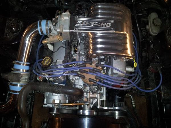

Hard to tell if it's a decent deal or if it's over priced. Does it have a clear title? The engine bay is black and the outside of the car is a light color and hard to tell what color it is or how straight the body is with a dark picture. Hopefully that engine bay wasn't a rattle can paint job. Check the door jambs and inside of the hatch for the original car color.
Other than the 4 wheel disc 5 lug swap this mustang seems average. Engine probably is close to stock with stock heads and lacking in power which isn't a bad thing just don't get overly excited about a polished intake manifold.

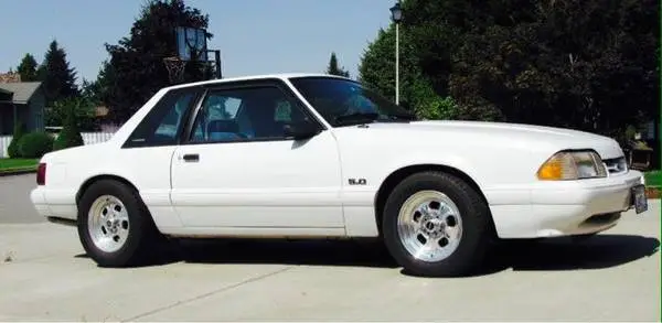

Here's something to compare to, I'm in Spokane so take it with a grain of salt. Clean Fox 5.0 cars are few and far between.
Procharged Coupe
Up for sale is a Clean and fast 5.0 Mustang. lots of add-ons and have all paperwork for engine work done. 5 speed manual, weld aluminum wheels, BF Goodrich Radial T/As, ProCharger supercharger. This is very fun and fast fox body. comes with lots of extras including original wheels and tires. It is in very good shape and a lot of car for the money. Pics speak for itself. Call or text Johnny for more info Asking 7000 OBO. Thanks for looking. Serious inquires only please. No tire kickers or joy rides.
