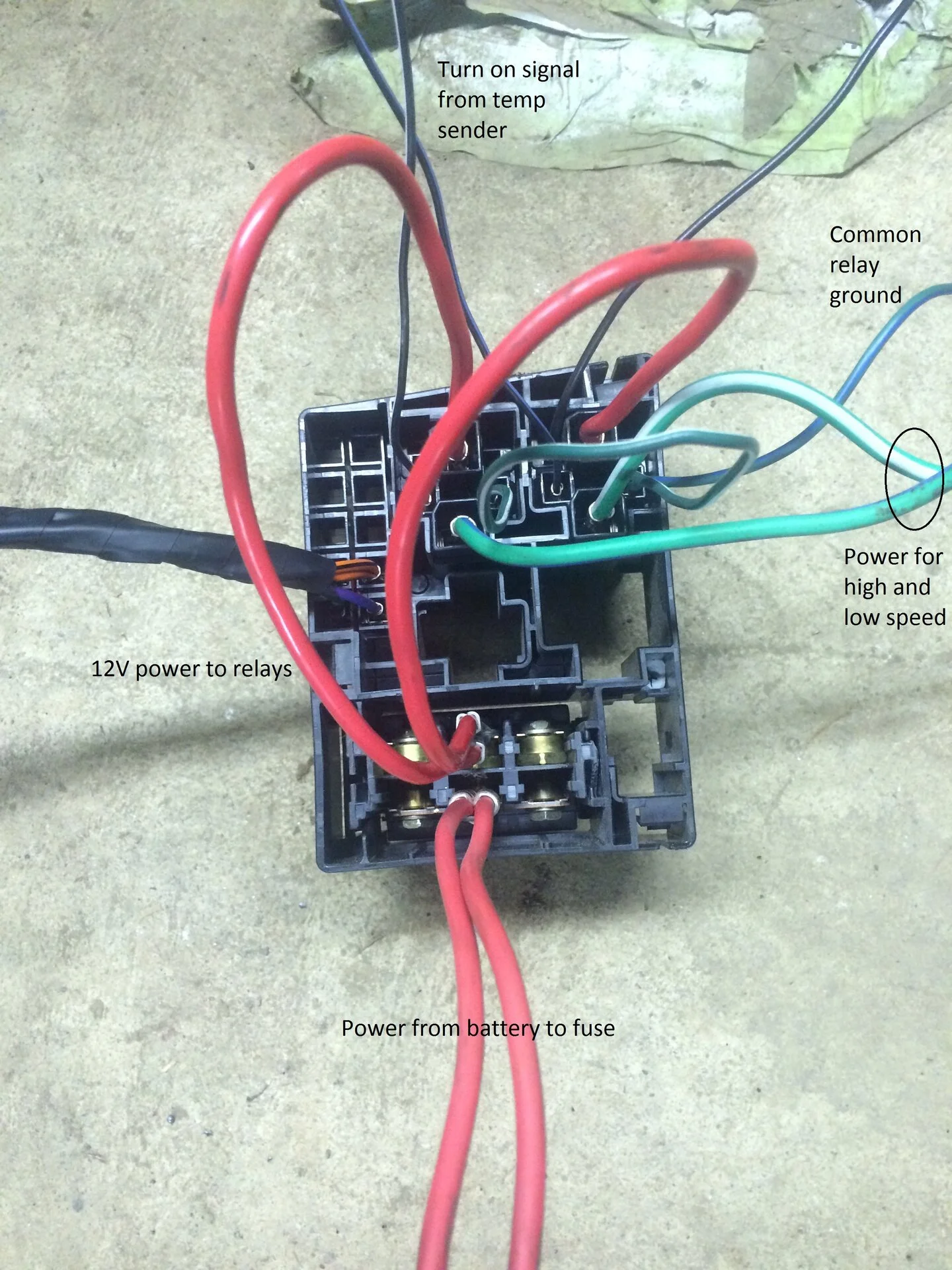

I did the wrecking yard/ parts car parts...
Electrical - Contour Fan Install with OEM controller
So first off, this may have been done before but my install is a bit different than all I have read in the past. If nothing else it is a different way to hook up the system. I used as much of the Contour electrical system as I could and then simply connected my controller. Oh ya, this is a...

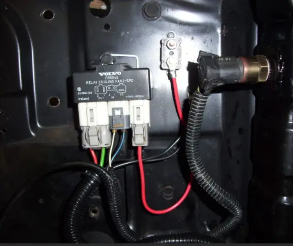

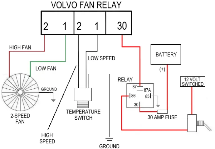

A simple way to achieve a 2-speed operation is to use the Volvo 2-speed fan relay, and BMW dual temp switch. The BMW switch is a 180F on and a 195*F on. On the contour fan, you would simply take advantage of the built in resistor to step down for low speed.
This is the volvo relay. You can get them for about $30-40 on ebay with the wiring. maybe $20 for the BMW switch. You'll need to figure out where to mount the switch and might need a metrs to 3/8npt adapter to install it into the intake.

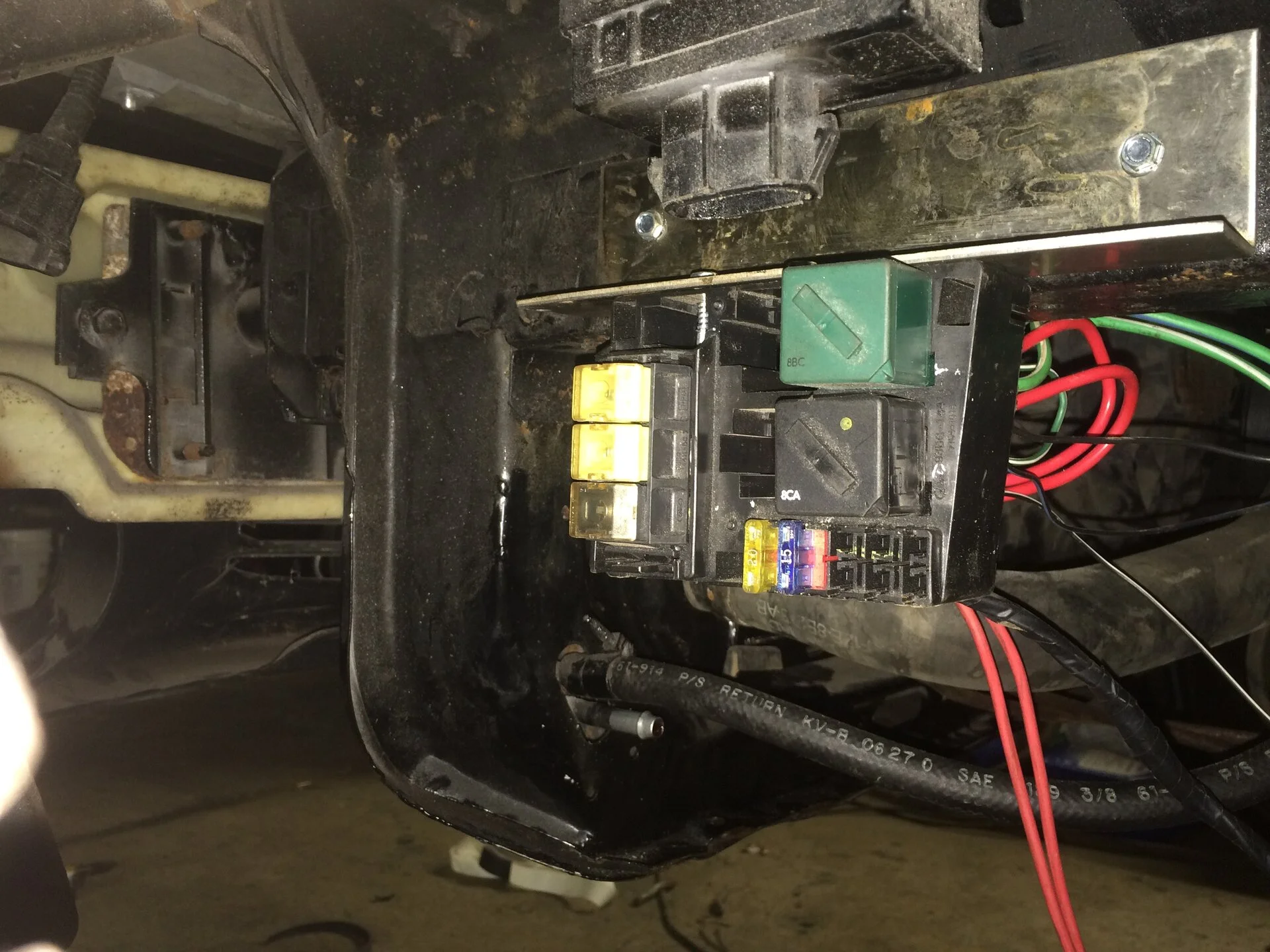

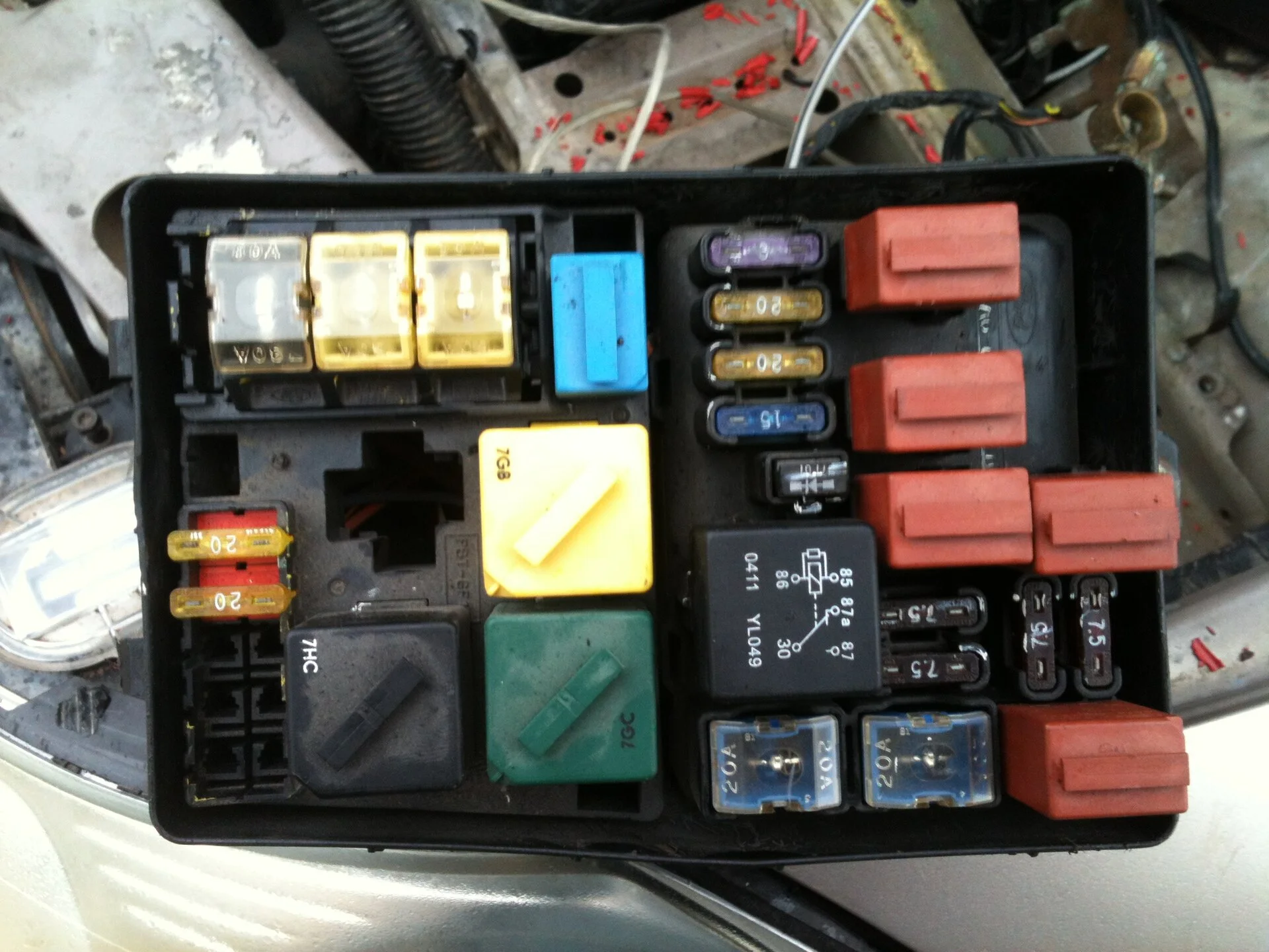

The Volvo relays are a great option, but everyone always forgets the Contour wiring system option. Why not run Contour fans the way the factory did (almost). The factory triggered high and low speed via the ECU, in our cars we need an external trigger, either the BMW switch Mustang5L5 mentioned or the Audi/VW switch I used or any of the other sensor/trigger systems out there. The beauty of using the Contour wiring and relays is you don't have to worry if the system will work - it did from the factory.
How is the Contour wired ...
This is how the Contour is wired with the exception of the fan switch here at the bottom and the starter solenoid. This is where you connect your sensing/trigger (whatever it is).
This past weekend I made a short video while at the wreckers showing what to take if you are picking one at your local yard.
View: https://www.youtube.com/watch?v=MmYFLhR12b8
If you are looking for more, you can grab part of (or all of) the fuse/relay box as well which will get you the Mega fuse and 70A relays.
Here you want the left half of the panel above. The yellow relay is used by Contour for A/C clutch, the two darker relays below it are the 70A units. If you can, remove the panel carefully and you can have the connection to the fans completely with OEM wiring and connections (it can be done, I have done it twice with my Mustang and F150 I converted to e-fans with a Contour control system).
