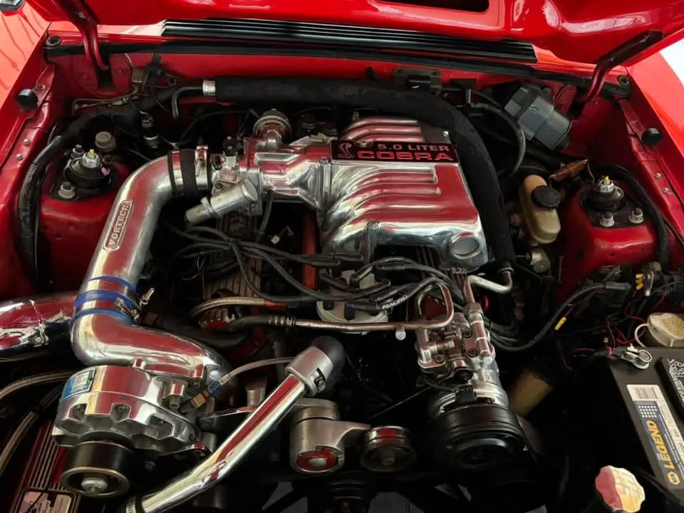

Recently bought a 1993 and its a time capsule since main build was done in 1995 to which is sat untouched since then.

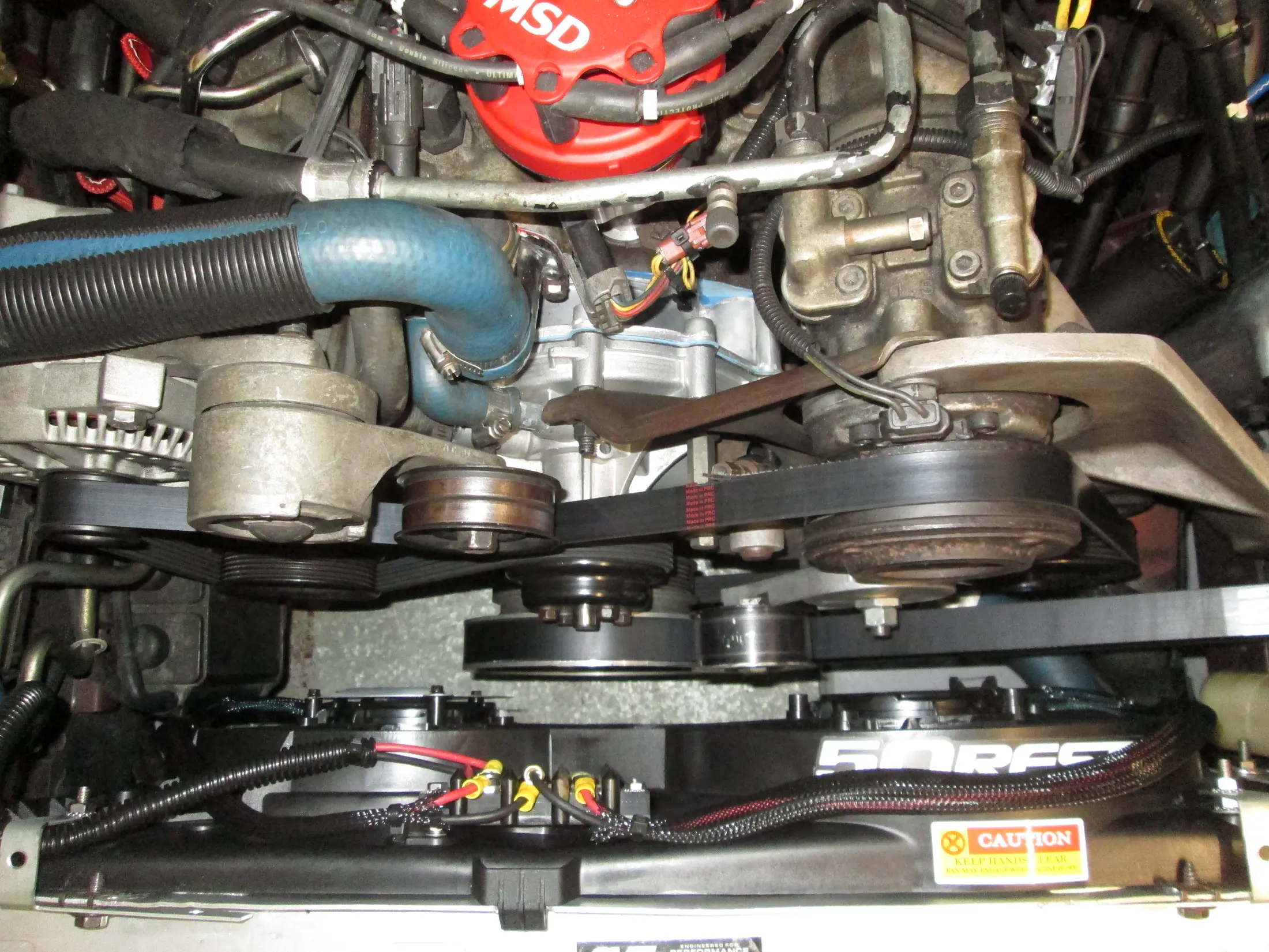

I want to remove the hard start fan relays and get a DCC pwm unit in place.
Currently the car has an aftermarket aluminum radiator and mishimoto dual 12" fans.

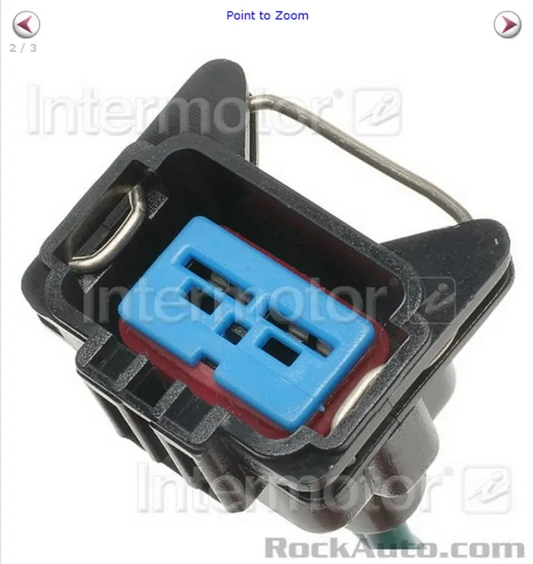

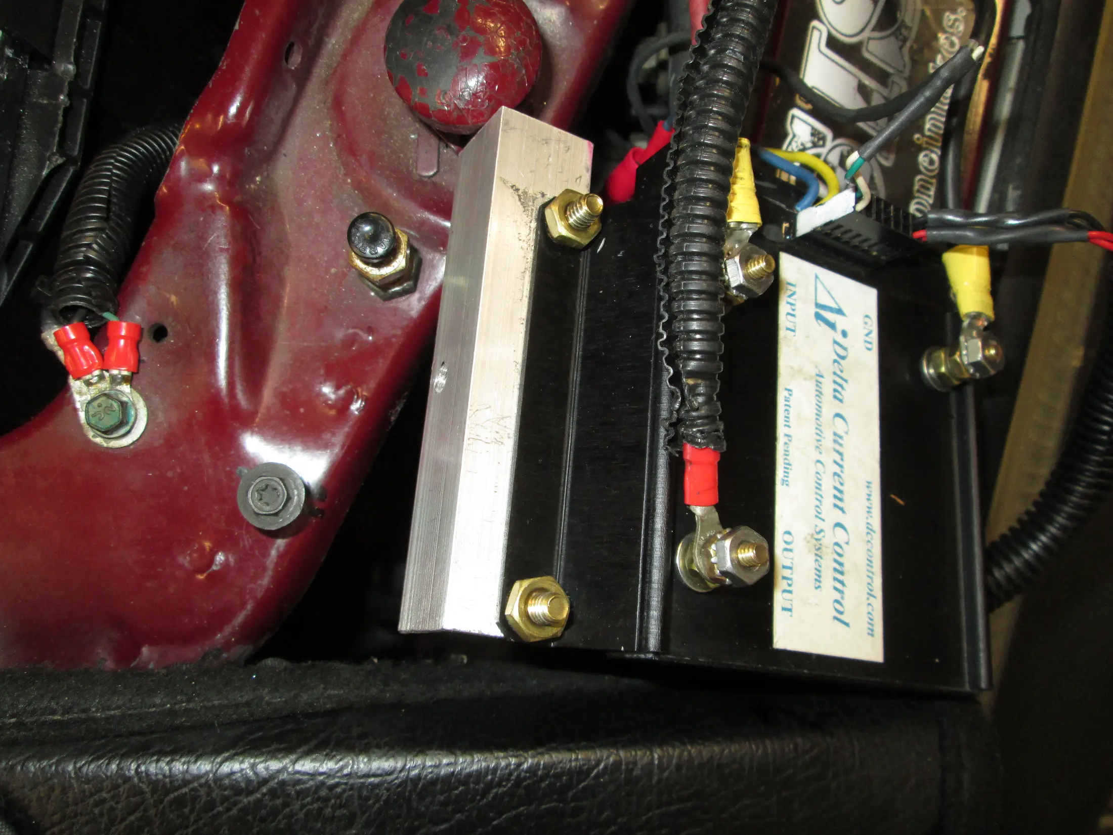

I still have the original FK-35 with the Contour fans. He's probably still building the controllers one at a time whenever he gets an order. When I changed from the Mark VIII fan to the Contour fans, I bought 2 fan connectors from Rock Auto. I had a heavy duty terminal block in my parts bin. Mounted the FK-35 on the radiator core support for better heatsink cooling. Pic shows it partially removed.
