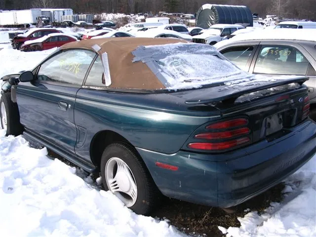

I found a yard with a 95 convertible, the driver's door is in excellent shape and the price is right. Can I swap this door directly onto my GT coupe? Are there any differences between coupe and convertible doors?

i think they are the same. can you take some measurements to make sure before you pick it up
I'd like to be able to, but I live in upstate New York, and the yard with the correct color door is in CT. The yard does not ship, and I only want to drive out there once (if at all).
On top of that, the people who answer email for the junkyard write like elementary school kids. So I'm not confident that they would be able to accurately convey measurements to me anyways.
I'll be happy if they at least remember to roll the window down for me, since I'll be carrying it back in my 95 GT.

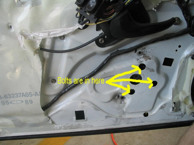

Do you know which side of the glass the wiring is on? In other words, will I have to remove the glass in order to pull the wiring out? I'm sure this will be obvious enough when I get to tearing into it, but if you happen to know, it could be helpful to me ahead of time.

The wiring should all be accessible without removing the glass. You can always disconnect the window motor and raise the glass manually. Check out this thread for instructions on removing the motor if you need it. Since the images are dead in that thread, here's a photo of the bolt locations for the motor:
