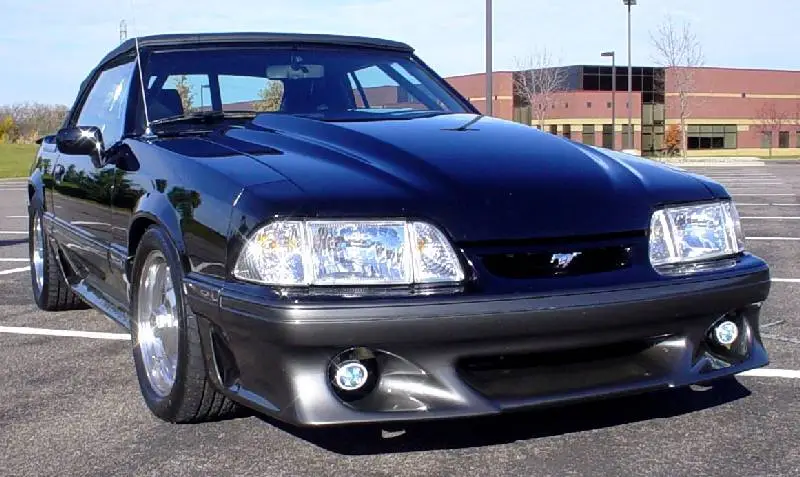

I could never get rid of my drop top. Weight really never bothered me especially after I installed the ATI P1SC. Of course I did the normal Jenny Craig stuff like k-member, battery relocation, alum heads, no windshield wipers, etc. If you want to race, go ahead and get that coupe, if you want to look good and work on that tan and smack people on the road that dont want to act right, just look at this ride here. I read about this car a in many mags, but when I saw it in person, my life with my convertible changed. Over 700 hp. On top of that John has pwersteering and AC. Check out his site and YOU decide! http://www.superstang.com/
