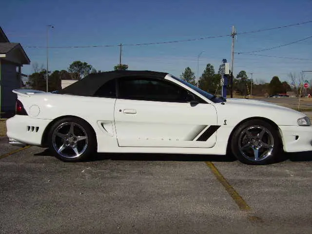

Ok thanks, hey could you measure from the ground to your fender lip and give me your measurments, this would help me out greatly on getting the right spring, check out my car this is the eiback pro-kit for coupe on a convert what do you guys think
He could, but even if he does, it's not going to help you out a lot. There are so many variances, variables and inconsistencies in each spring that would make each car sit differently it's hardly worth putting concrete numbers to it. Just know, that it will make your ride height lower. If worse comes to worse, you could always fine tune the ones you've got by either shimming the back, or cutting half a coil from the front. :) From the look of your pic a set of Air Bags out back would clear things right up and is a cheap fix. That's what I'd do.
