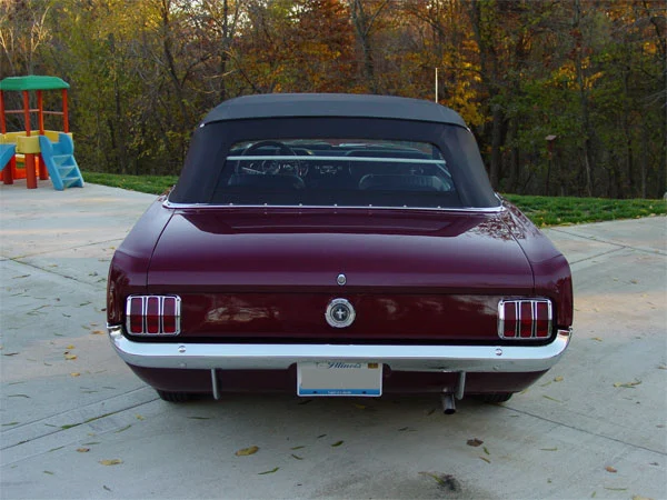

Replacing the Convertible Top on my 67 Mustang was the only thing I paid to have done. I have seen too many nice cars with wrinkled and ill-fitted tops because someone wanted to save a few bucks. I had mine done five years ago and the shop wanted $1000 which included the top and soft glass. I had a new top from Larry's Mustang and Thunderbird plus I picked up the glass window and new weatherstripping from NPD. Shop installed the top for about $700 which included all the extra little things needed to do the top correctly. My top still looks like new and I have had a lot of compliments on how good it looks. My advice is to get the glass window and have everything done at a shop.
I paid to have it done too...
There isn't much I chickened out on, but replacement of the top had too many unknowns for me. I even painted my car in my garage with a PVC and plastic tent. But when it was time for the top, I felt too ignorant to tackle it without at least one good, experienced resource from which to draw. I went with a glass window and have no regrets. As penny-pinching as I am, I feel it was money well spent.
