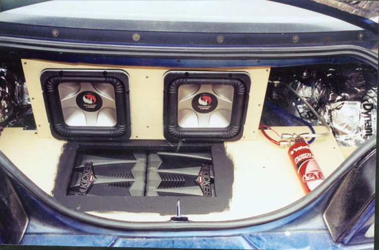

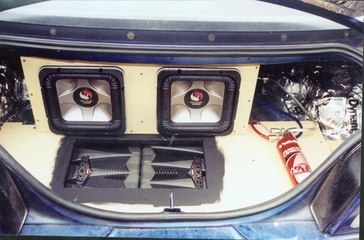

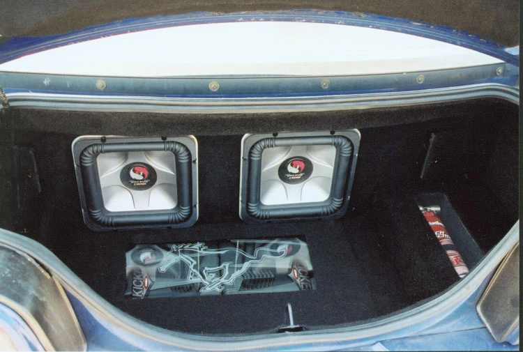

I built mine with 2 10's. The back part of my box slopes down, to accomodate the area for the convertible top. When we built it, we kept the top down, so we knew how far we could go back. I think it sounds great, and would build it this way again. If you have any specific questions, drop me a line..
