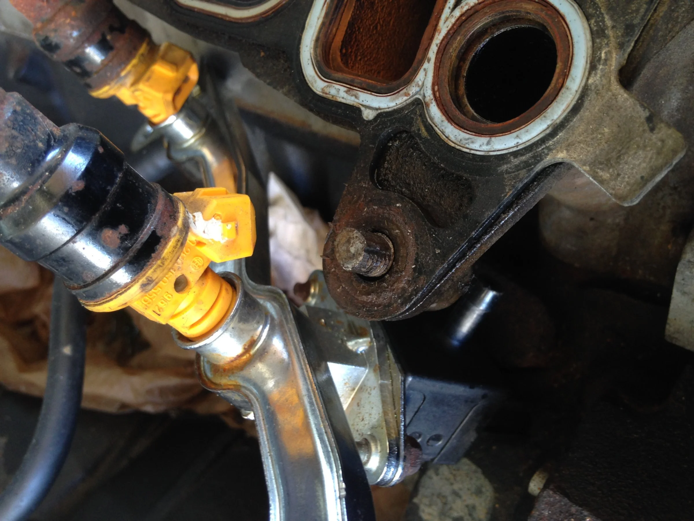

So one of the bolts that holds the intake down and also holds the thermostat housing broke in half... any suggestions

The same problem caused me to replace a lower aluminum tuned port intake manifold back in darker time. Had a firebird habit before mustangs.
If you can get a bite on it with vise grips that's how I would start. Try to back out out. If it breaks off flush you're going to have to drill. Lots of pb blaster either way. Don't heat the aluminum head. It will warp and ruin the head.
Past that you're drilling. The easy out broke off in the center of the drilled bolt on my old intake. Costly mistake. I dont recommend them but a more talented hand could probably work some magic with them. Id just keep drilling until the bolt crumbles and re-tap the bolt hole to clear the threads.
It's going to take a long time and make you furious. Cheaper than replacing a head though. Best of luck to you.
