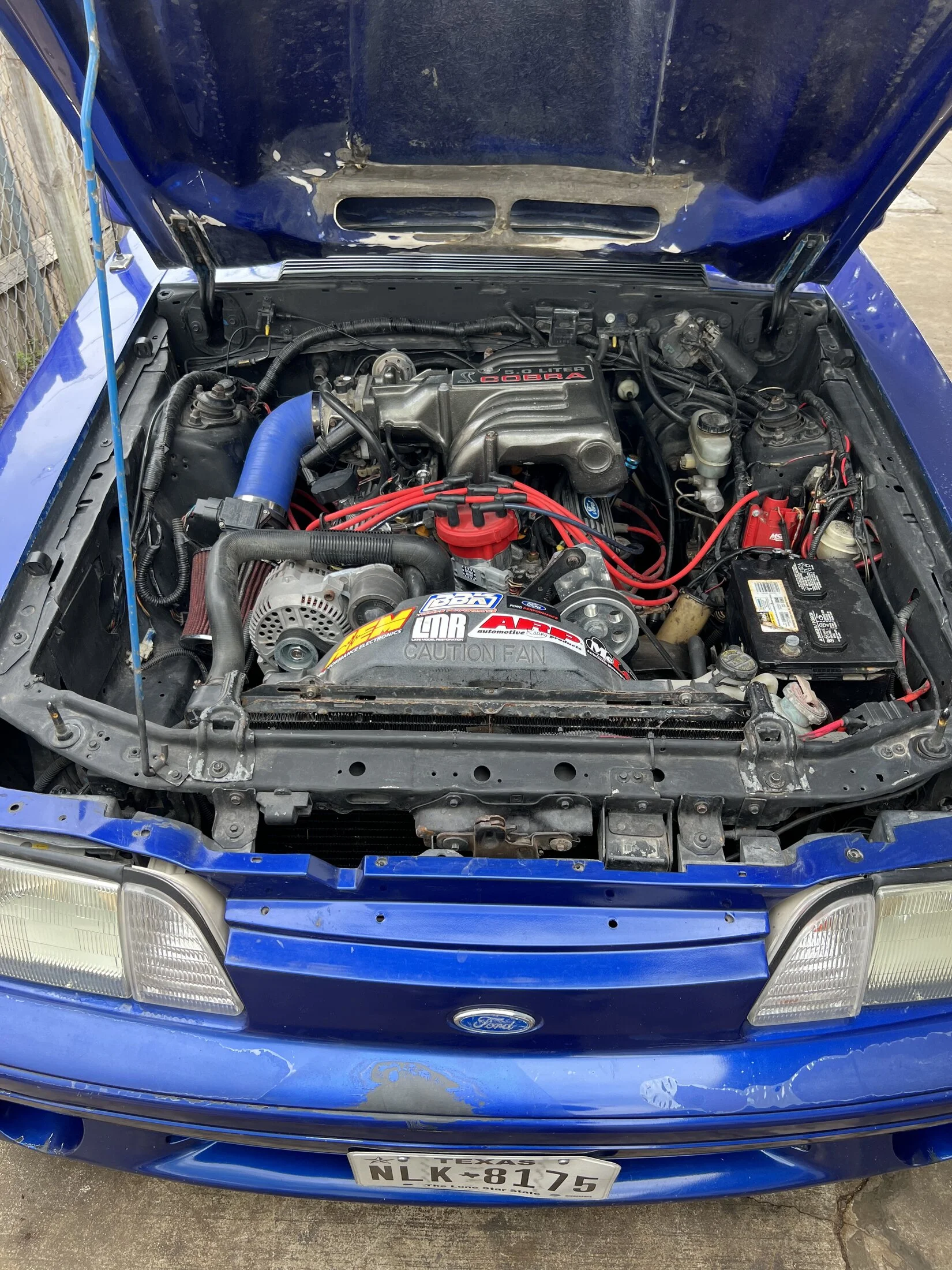

I have a 92 gt that I’ve had few years. I noticed white smoke and then I looked in oil and I have the milky coolant. I cheacled the dipstick and it’s almost like mud. Where could it be mixing? I remove head a while back . I had a broken spring and wanted to take a look at the piston and swap valve(assumed. It was bent) ever scince it’s done that. How can I tell if its a head gasket? Where should I look? Compression test tells me anything about the mixing ?how can I clean out the engine without having it rebuilt? I’d like to find leak first then clean it out and fix mixing spot.Please someone help I’m about to give up and sell it if I can’t run it

Typically it is a head gasket failure.
Could be a cracked head, but not likely.
An Intake Manifold gasket failed at one of the coolant ports at the corners of the intake manifold is possible.

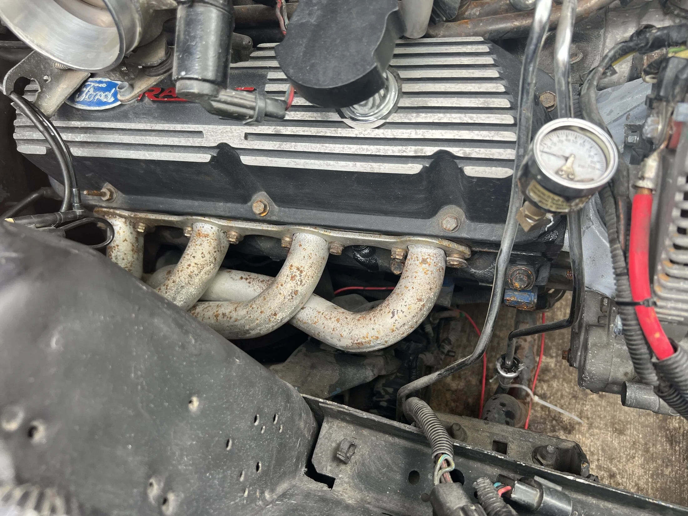

Update! I used compressed air and water shot right out the #2 spark plug ! I suspected the driver side because I took that head off not the passenger! How much psi should I be using in a leak down test when running just a straight hose to cylinder? Should I pull one spark plug at a time to do it? I’m in front of harbor freight and I bought the leak down tester as well. Reason I ask on psi is if I set it at tdc on a cylinder and it has too much psi won’t that drop my piston then having a hard time trying to test next cylinder in firing order cuz the engine turned?
