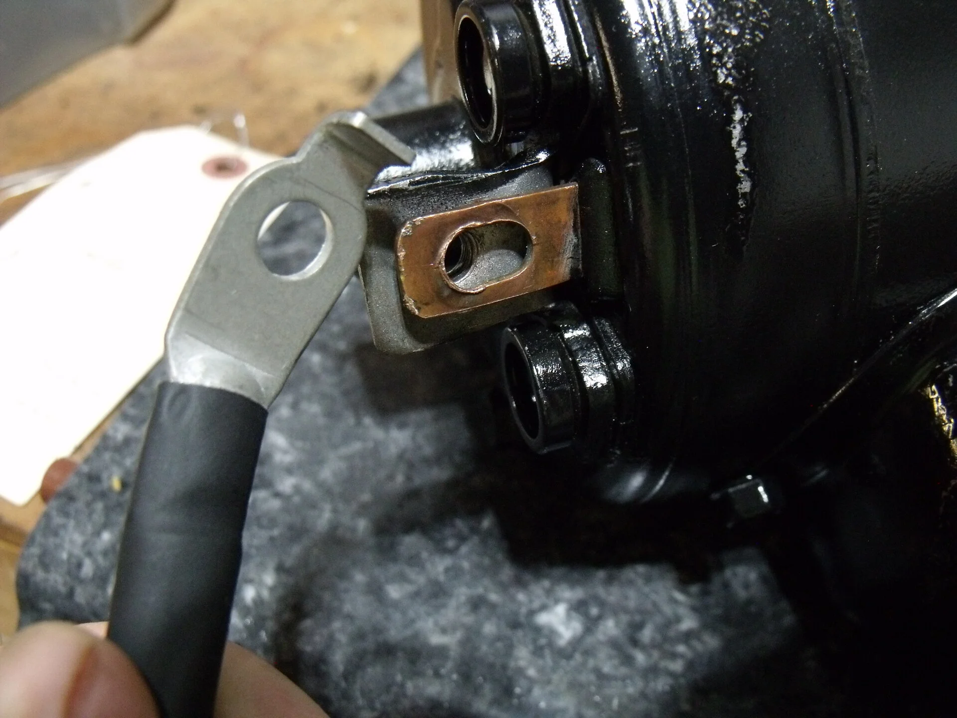

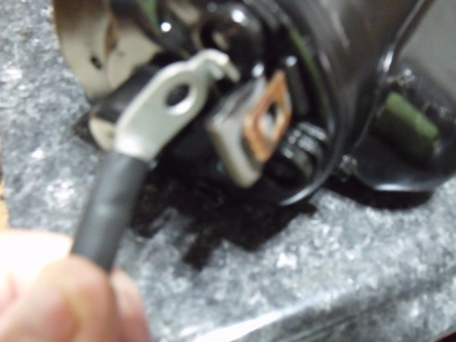

Is there a specific way that the starter cable bolts to the starter???
Thank you...
Just use a bolt with a washer, ignore the tab on the end.
So could I cut off the tab? Service manual picture does not show a tab.. Not enough room to come straight off the starter with the tab...
Also, do I put the cable in the gap between the brass and steel connectors on the starter??

Ok. so is it a special screw or bolt that holds the cable to the starter?? I cannot find anything that will thread into these threads... Seem to be 1/4" but the brass part is slightly off so I can't get a straight shot at it and I do not want to screw it up..

Trim the tab and put the cable on top of the sandwich.

That copper/brass tongue should move around enough to get the bolt started or take a screw driver and wallow out the hole/slot a little.
Were good there. What I really need is a bolt thread count for what fits it?? Anyone done this before?? Or do I need some elderly assistance..
I believe it’s a metric bolt

Pretty interesting info so far.... I called a local ford dealer ( very helpful young guy) and he looked up the part number ( discontinued) but he googled it while we were talking and it showed 1/4-20.... thats what I have and its not correct... Forgot to get the Part # from him.........
I called the electric rebuild place and they told me 5/16 fine or course... I don't think so.....
Hopefully I will not be in a hurry at the hardware store this time and I will make sure what I get fits.... Will give the metrics a try.....
