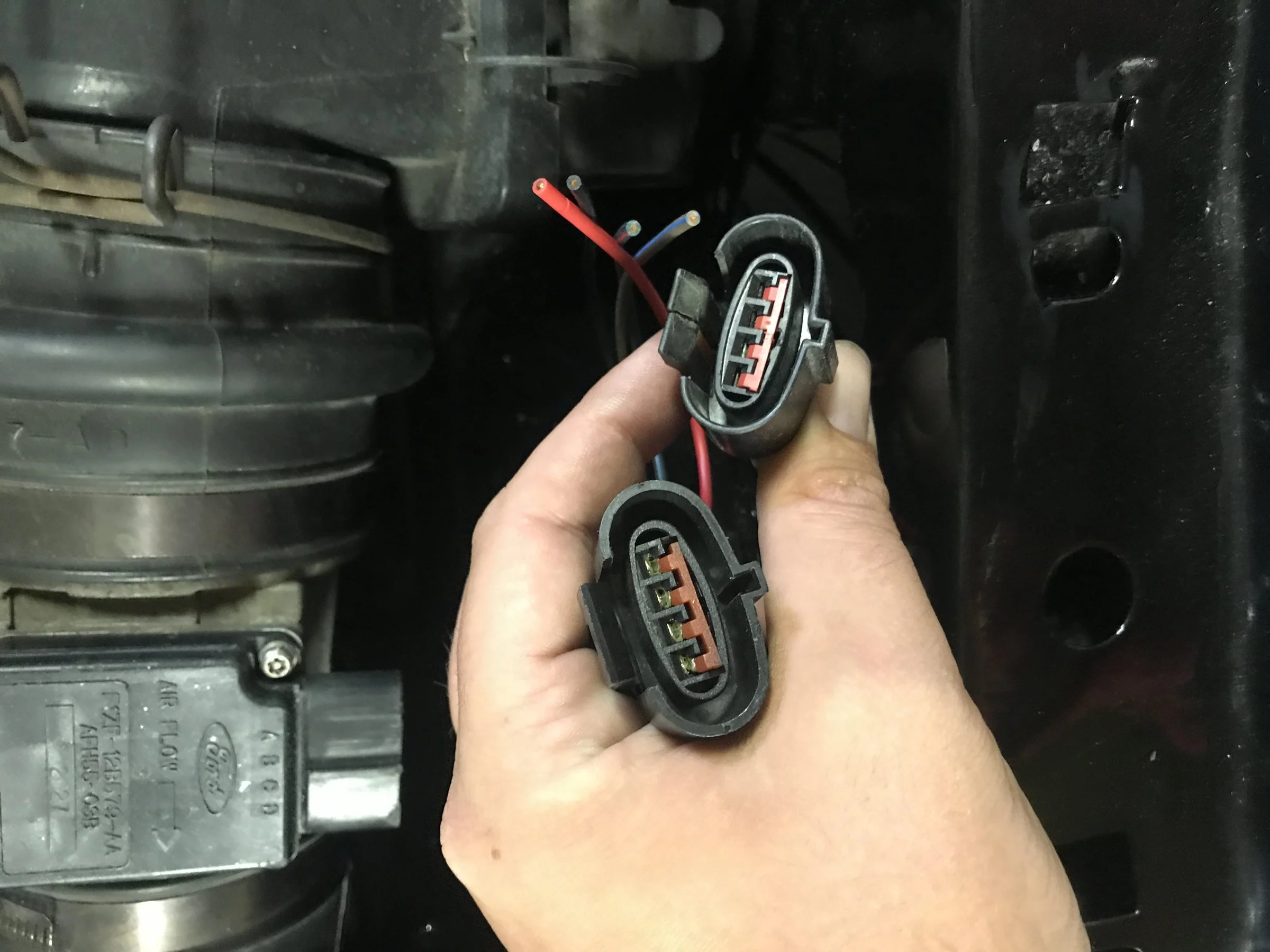

billison I like tinted tail 15 Year Member Feb 27, 2006 2,607 1,094 184 stl May 21, 2017 #1 May 21, 2017 #1 im looking to replace my mass air plug. Does this look right? https://www.ebay.com/itm/401146763443
D Deleted member 215073 May 21, 2017 #2 May 21, 2017 #2 Terminal end looks right, wire colors are wrong.
billison I like tinted tail 15 Year Member Feb 27, 2006 2,607 1,094 184 stl May 21, 2017 #3 May 21, 2017 #3 Don't care about colors lol. Just don't wanna spend $25 for a plug lol
Mustang5L5 That is…until I whipped out my Bissell Mod Dude Feb 18, 2001 43,347 18,082 224 Massachusetts May 21, 2017 #4 May 21, 2017 #4 Looks right to me. It's a 4 wire plug. Gimme til later, I've got a harness kicking around somewhere Reactions: billison
billison I like tinted tail 15 Year Member Feb 27, 2006 2,607 1,094 184 stl May 21, 2017 #5 May 21, 2017 #5 I was surprised at the price of these, but all of them have 7 foot leads for conversions. My car was running rough and I found a loose wire in the plug that fixed the issue once I pushed it in.
Mustang5L5 That is…until I whipped out my Bissell Mod Dude Feb 18, 2001 43,347 18,082 224 Massachusetts May 21, 2017 #6 May 21, 2017 #6 That is the right plug btw
billison I like tinted tail 15 Year Member Feb 27, 2006 2,607 1,094 184 stl May 21, 2017 #7 May 21, 2017 #7 Sweet! I'll get one ordered

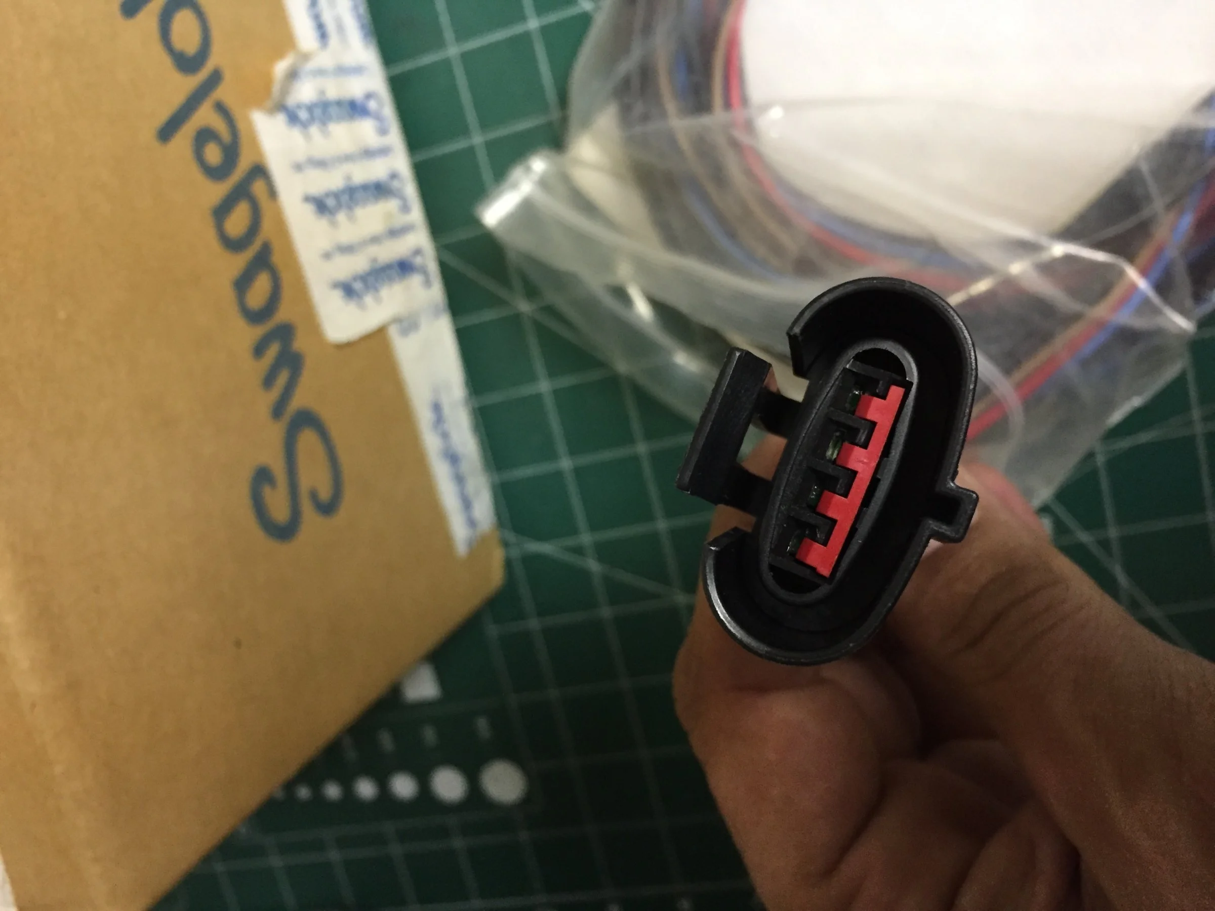

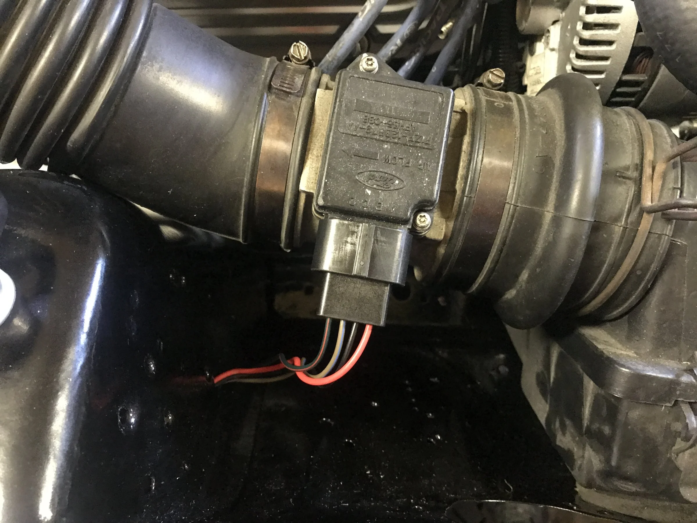

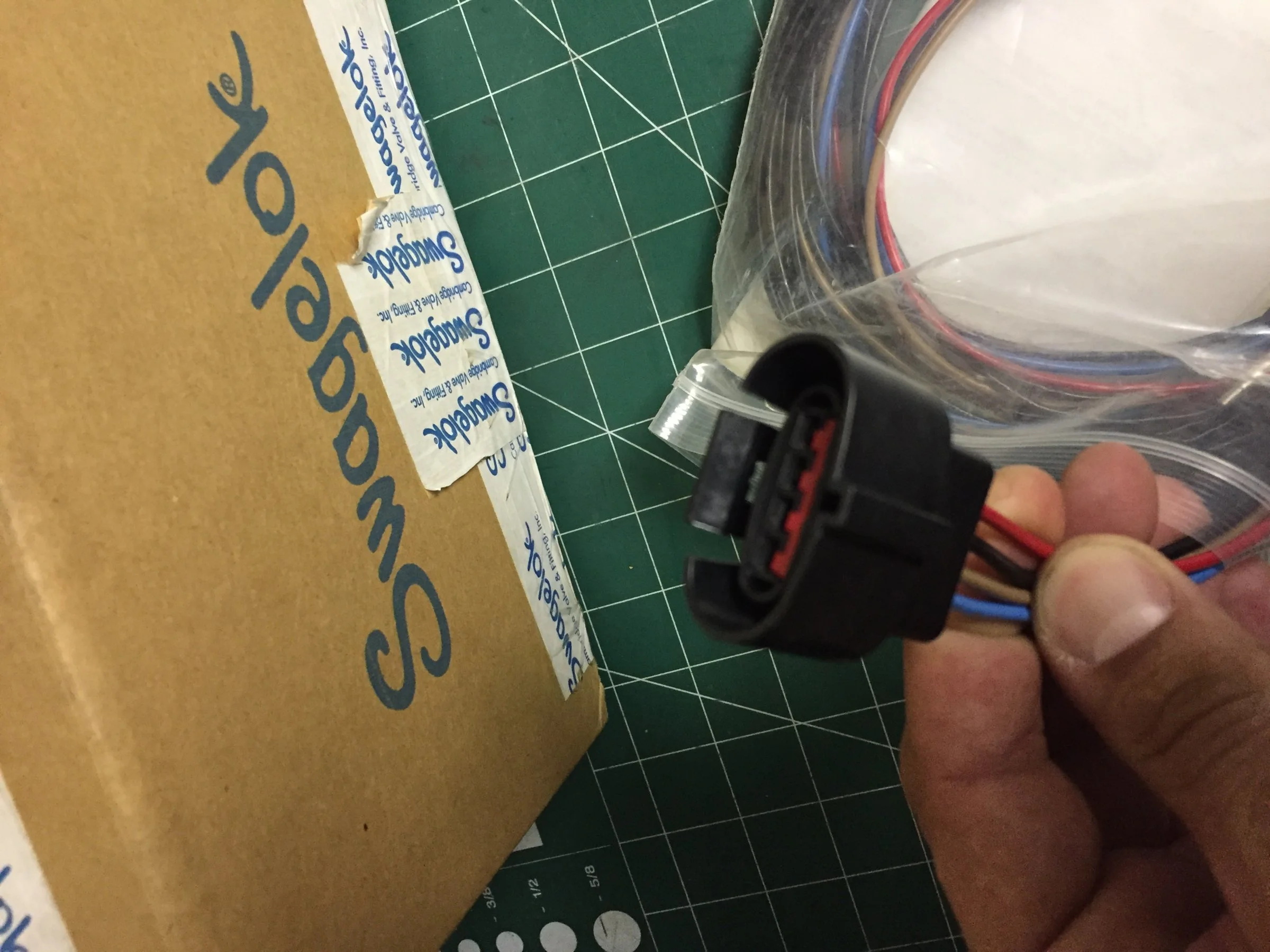

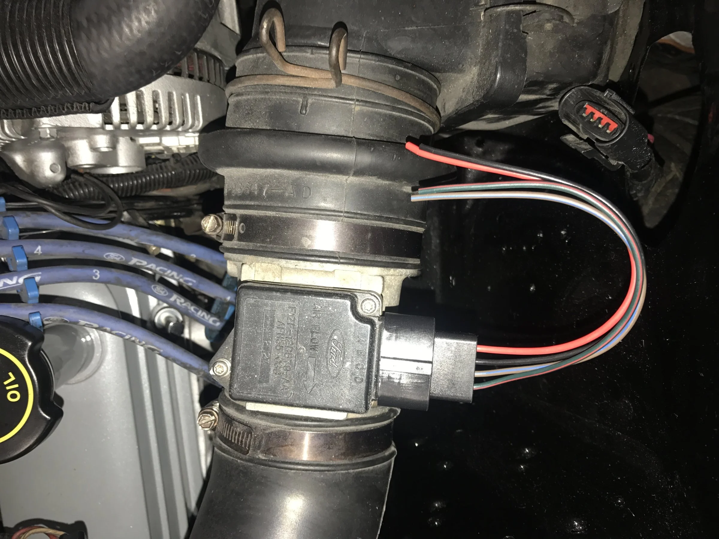

billison I like tinted tail 15 Year Member Feb 27, 2006 2,607 1,094 184 stl May 27, 2017 #8 May 27, 2017 #8 It's a match, just slightly different colored wires. Just a little solder and heat shrink and I'm done. Runs smoother too. Attachments IMG_1548.webp 400.9 KB · Views: 174 IMG_1549.webp 208.3 KB · Views: 147 IMG_1557.webp 392.6 KB · Views: 147 Reactions: RaggedGT
