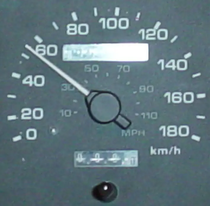

OK so I went ahead and bought the speedo. On my own stupidity by not paying attention, I bought a 180 kph speedo. It is however a SVO Ford motor sports speedo with only 77,000 miles on it. So my next question is this.... On the metric mustangs (you know what I mean) what did the factory speedo go up to? On either the '87 - '89 cars and also the '90- '93 cars.
Nate
That would be 77,000 kilometers...or 48,000 miles. It's gonna read your milage in KM's.
I beleive there was a 140 km/h and a 180 km/h speedo for the canadian cars
well here are some pics if anyone is interested................
