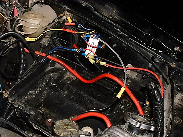

the install is easy, just have to run wires for everything. it is like hooking up a radio or amp. i put mine next to the battery. some folks put it under the bat, on the fan shroud, inside of the fan shroud. just where ever you feel comfortable with it being placed, and out of harms way since it is under the hood.

Alright JerryD, I appreciate the pic but my eyes must be going cuz all I see is 5 terminals and a lot of spaghetti, and I can't even remotely tell what these terminals are attached to. I'm guessing the DCcontrol is black and blending perfectly with your black inner fenders. :crazy: I have no idea what I'm looking at there. You appear to have more wires in that pic than I have in my entire engine compartment.
I will figure it out though.
Cliff :)

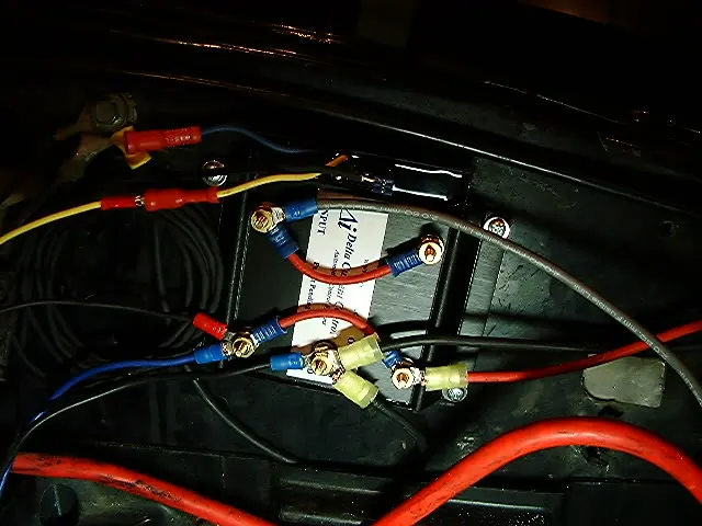

like i said, it is like wireing a radio under the dash. yes there are 5 posts, but actually only 3(pos, neg, and the output) when you look at it close. they are just extras to put wires on. maybe this pic will help. and yes it does suck having a black car with a black controller.
