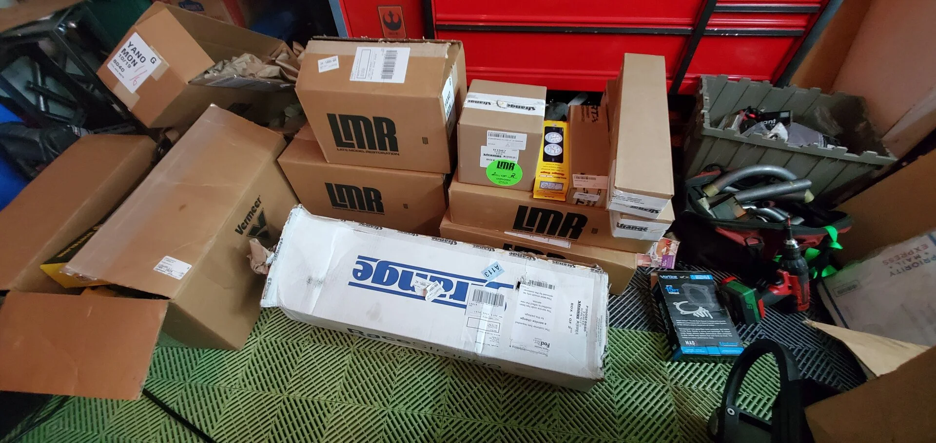

Got my toolbox back today.

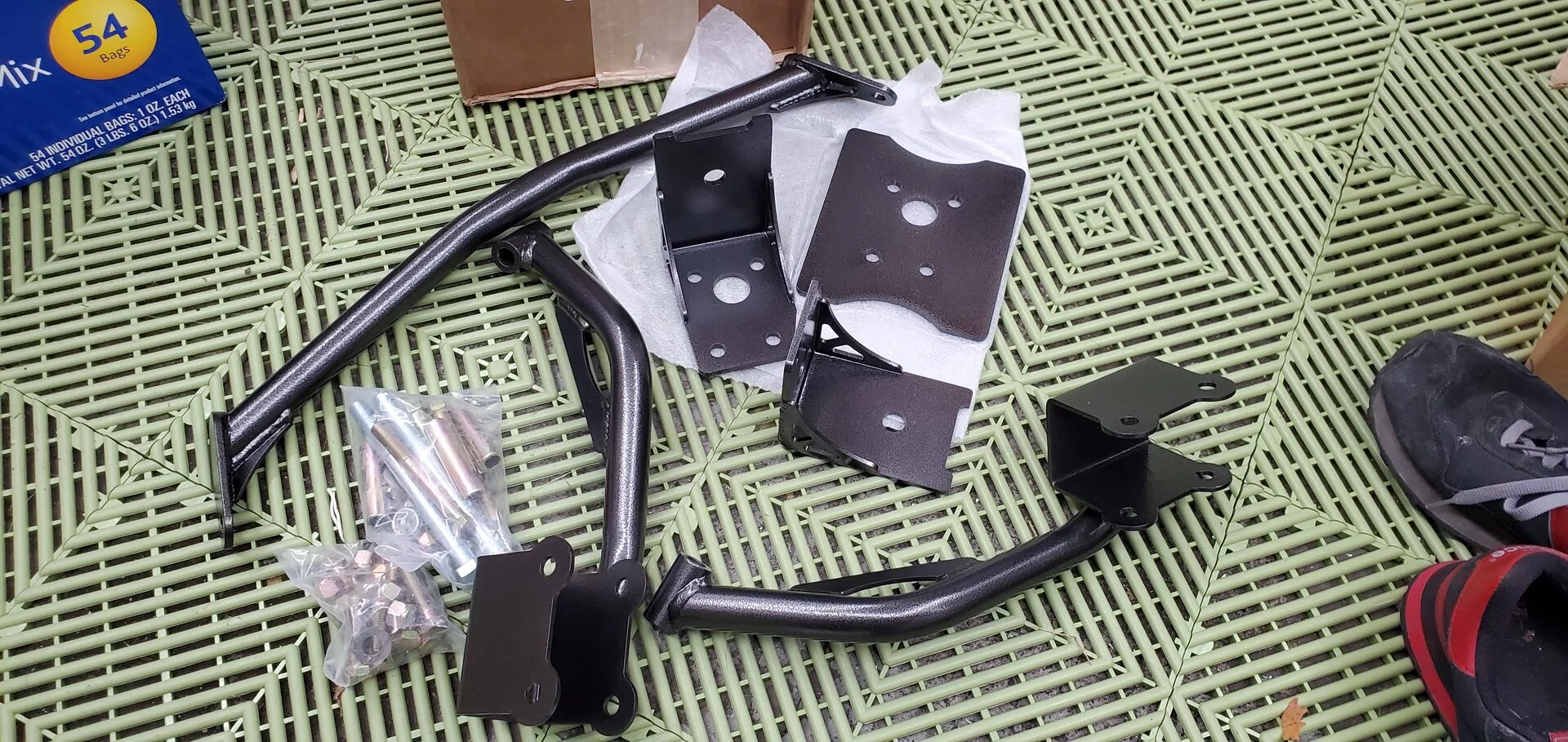

Seat delete kit and rear TQ box kit came in as well. Held the rest of the stuff at FedEx for pickup. Can't have the wife seeing it all sitting on the doorstep lol.

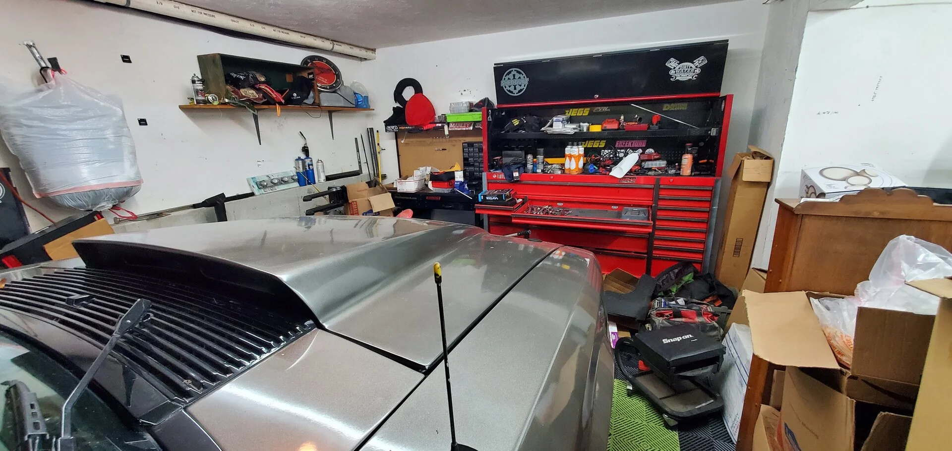

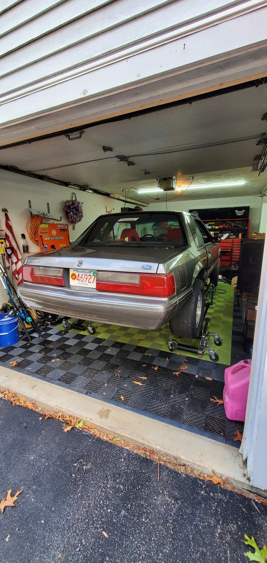

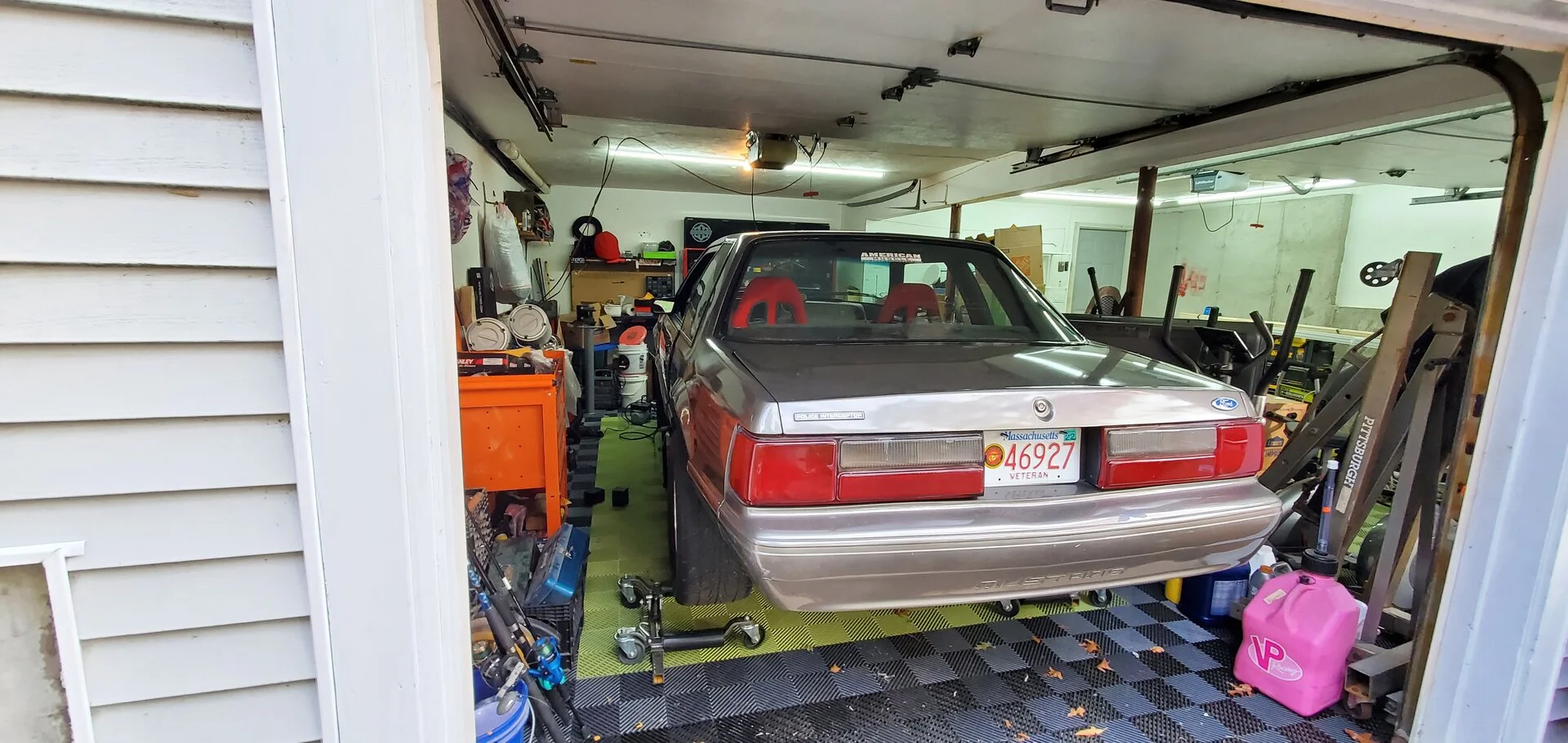

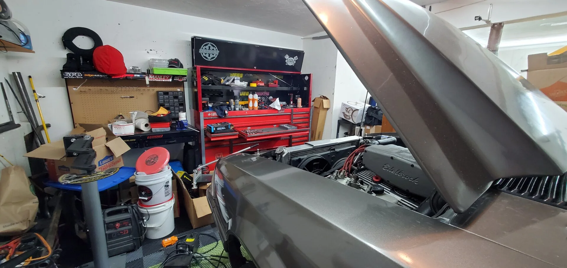

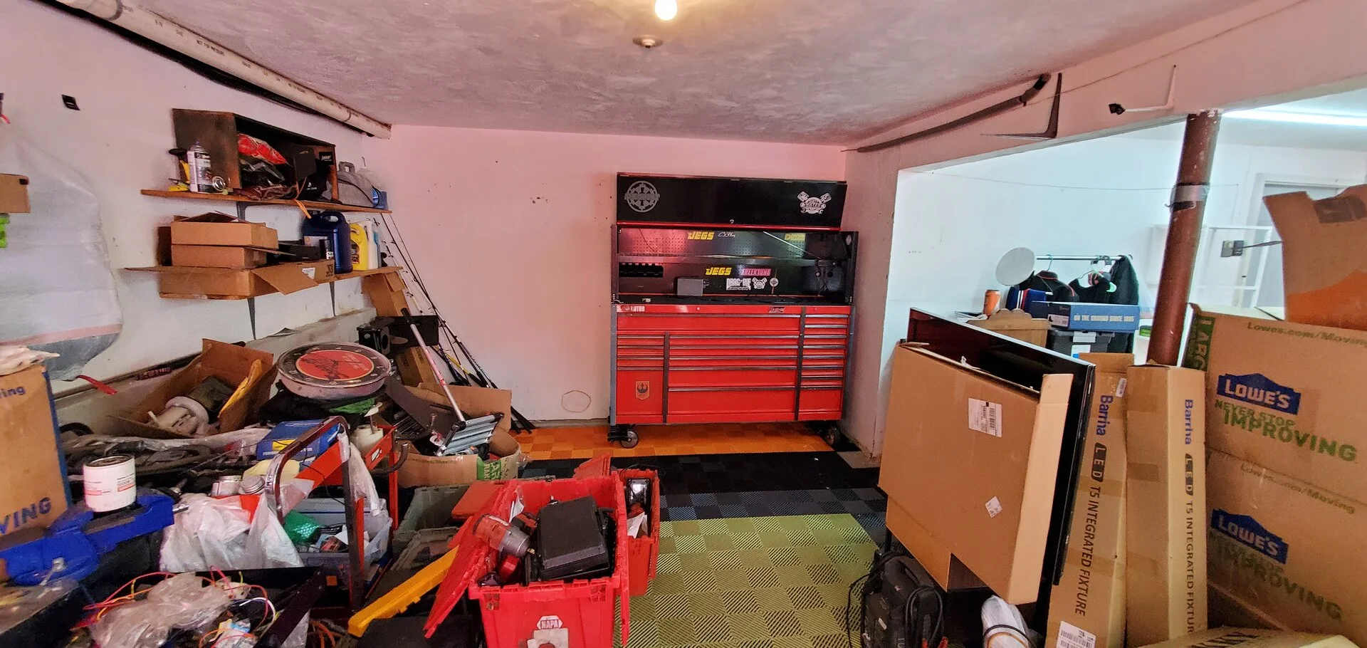

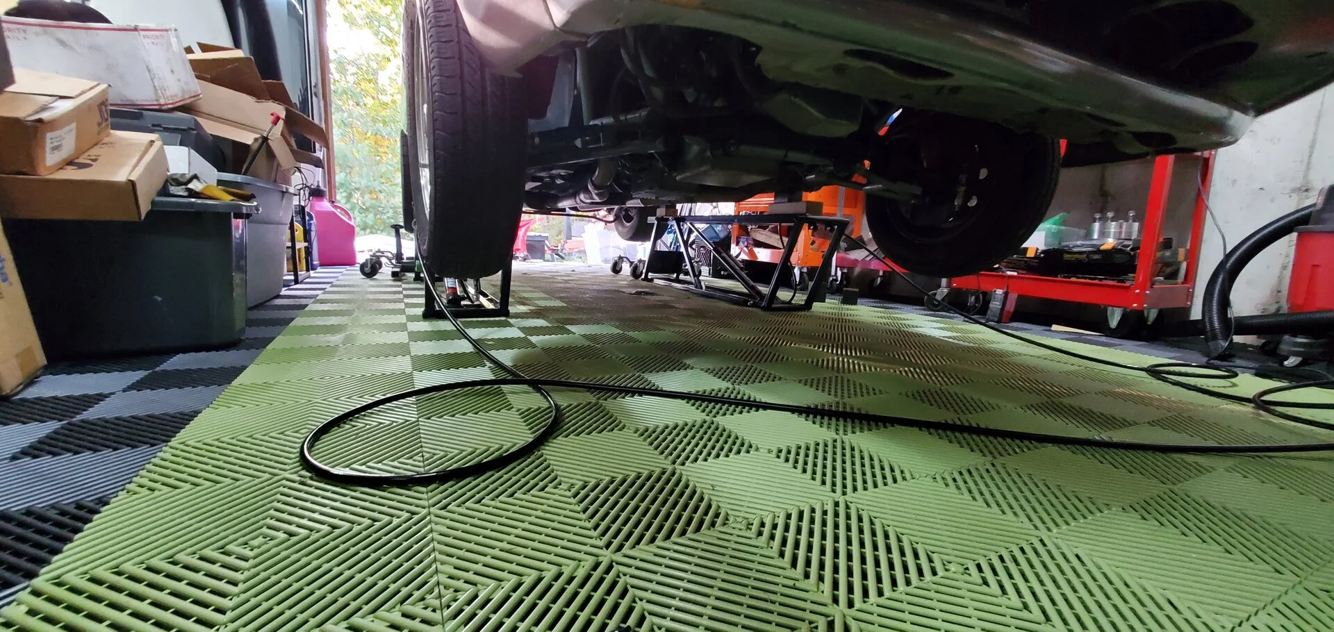

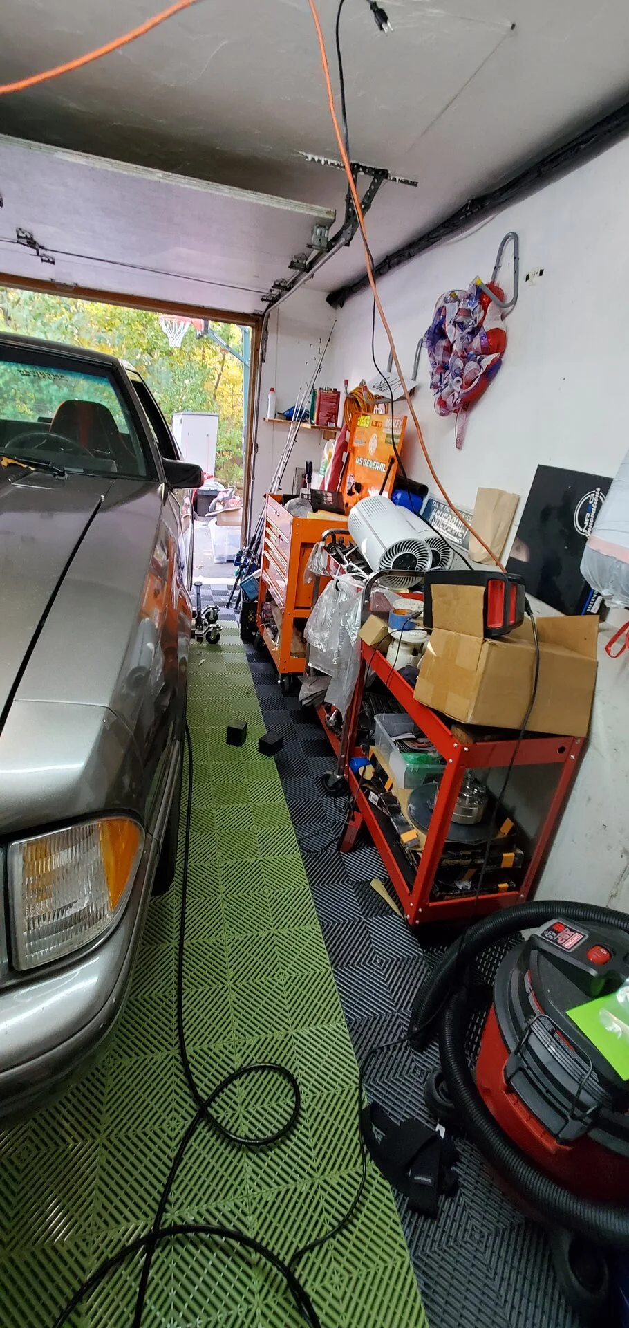

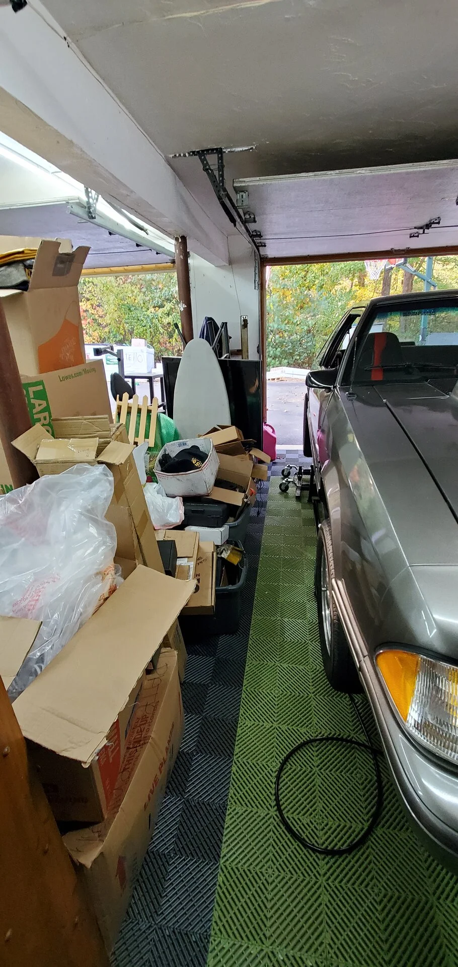

Garage is slowly coming back. Wanted to guage some space for when the car is finally In The garage. Plenty of room 360° once the stuff on the sides are moved over to the other bay. Only issue will be pulling motors with the picker. May get a gantry style lift that I could potentially just push back over the table and toolbox. The welding table/station is going to replace that workbench in the corner. Easy access to the car if I need to fit something or just bring the torch over to it. With 4x4 spacer blocks and jack pads on the quick Jack's still had about a foot clearance on the ceiling.
I'd like to yank the motor out soon and see what it has going on in it. Reading some unliked info on the heads. Looks like some AFRs and a custom grind cam may be in my future Depending on what's inside will probably decide wether I stay NA with spray or build a turbo kit.
Also toyed around with assembling a dart block. Decisions, decisions.
Until then I'll probably start buying some materials to build the non powerplant specific stuff.

Half the goods are in, waiting for a few other things (boxes) to trickle in from stuff being backordered. I have another long night tonight in dispatch at work so odds are I'll be bored and order more stuff :coff:

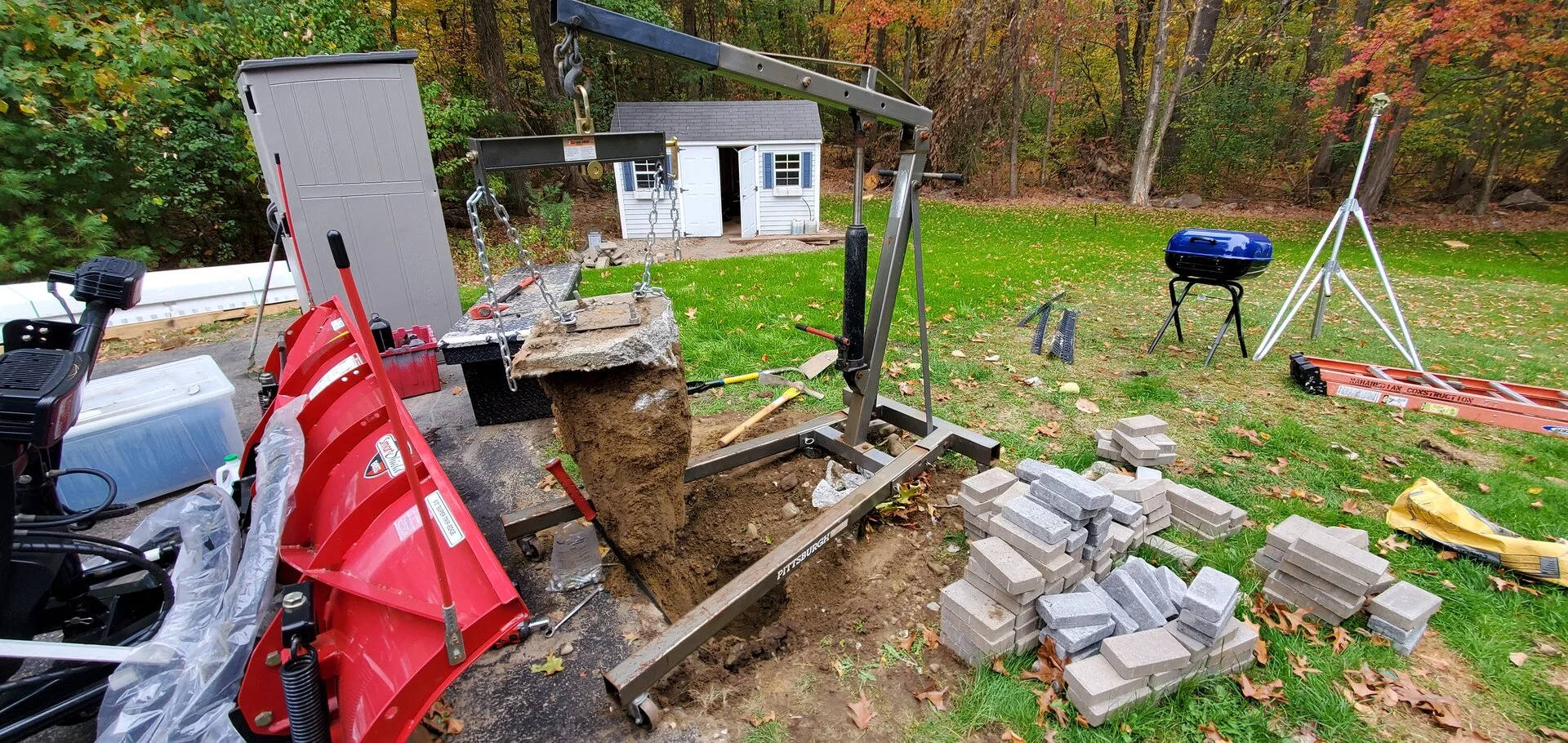

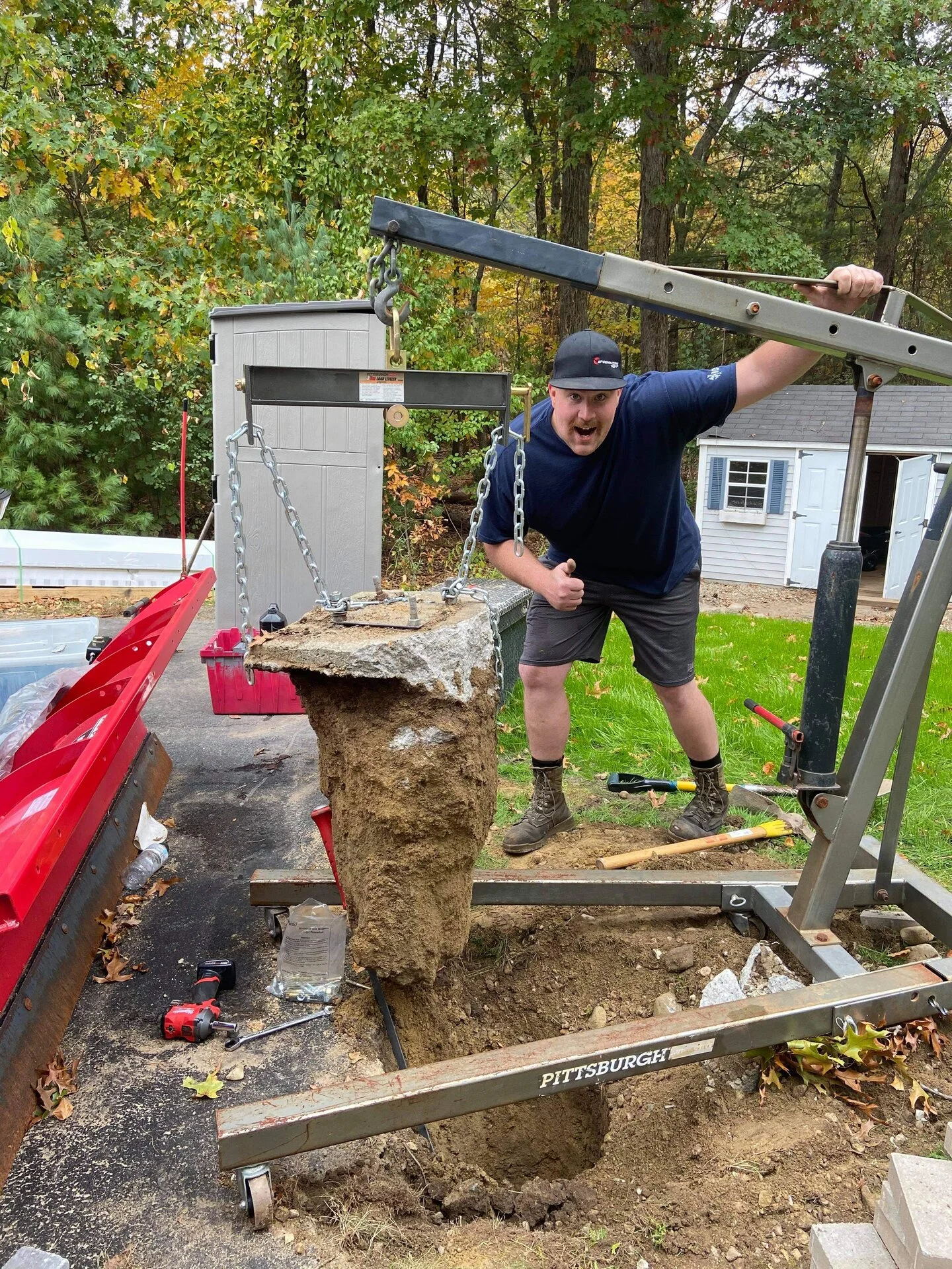

Didn't get the motor yanked on the car yet but I yanked a 4' deep block of concrete out of the ground so we could get our new fence installed at the house :rock:

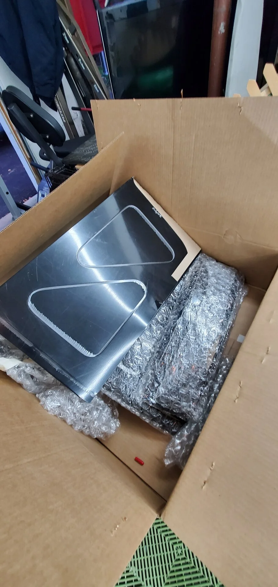

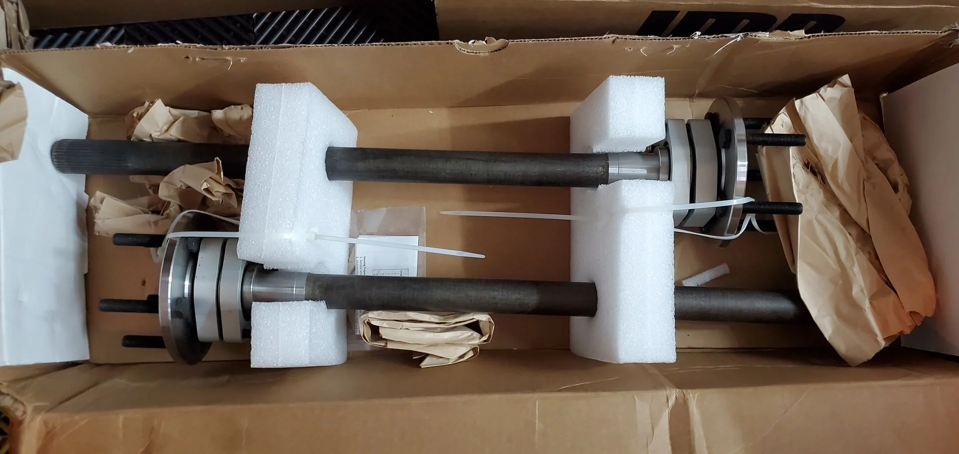

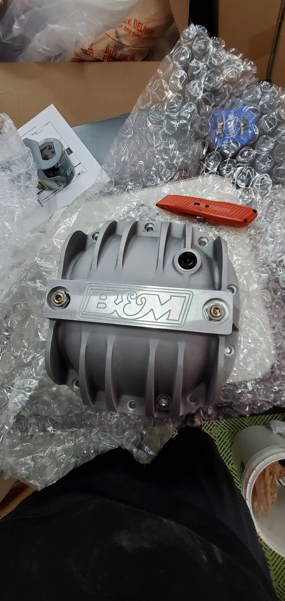

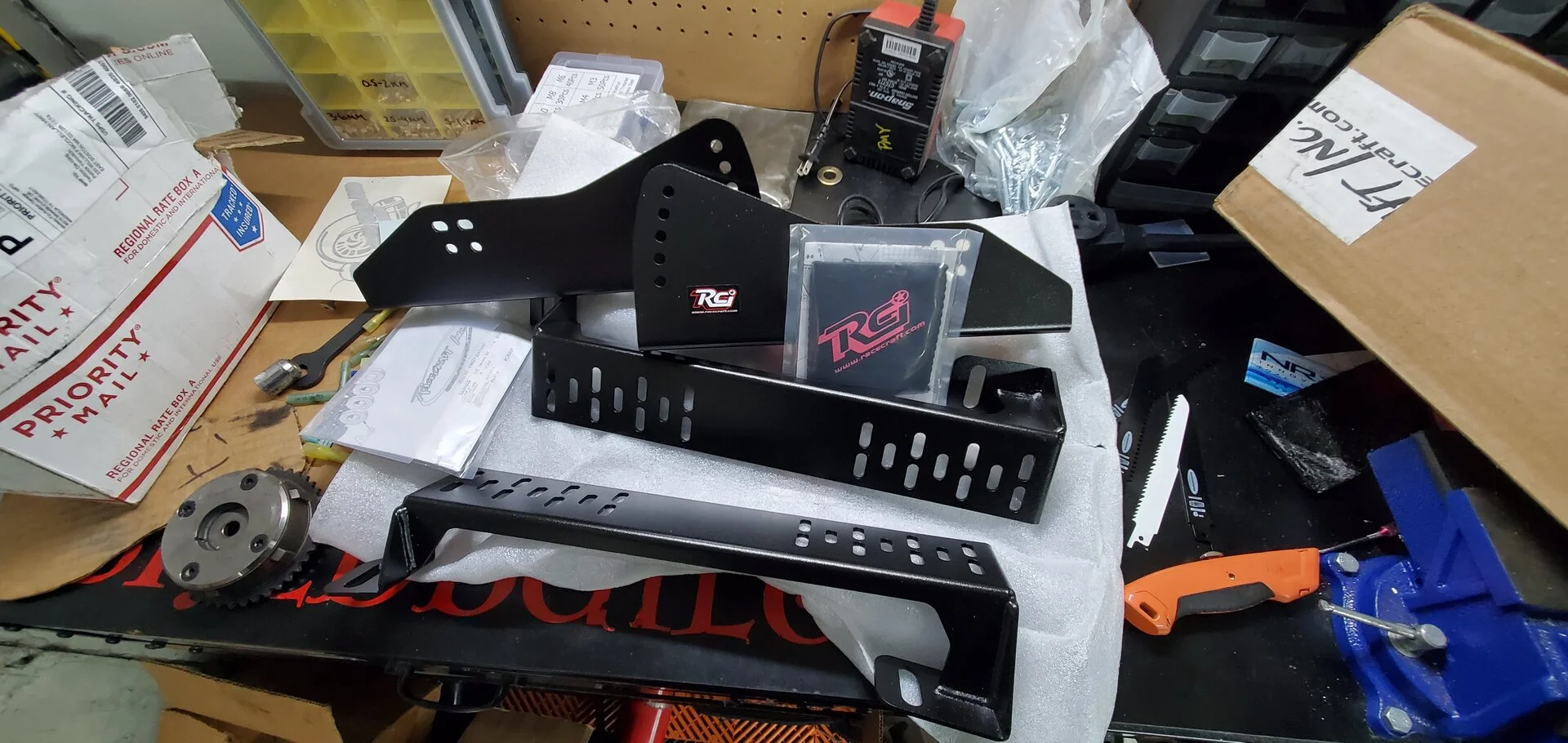

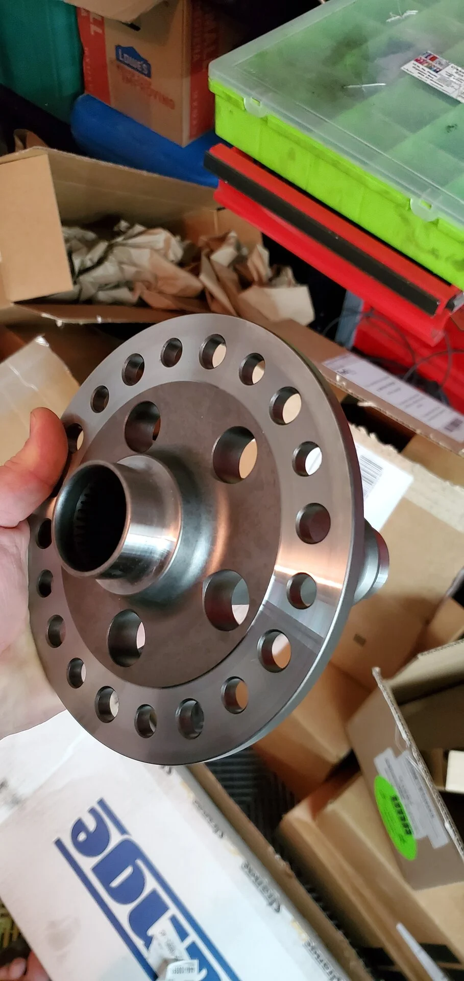

Some more stuff trickling in. Seat mount and brackets. Ring and pinion, brake conversion rotors and drums (surprised the front LMR "no name kit" is actually Stoptech Brand. I've always been a big fan of Stoptech products)

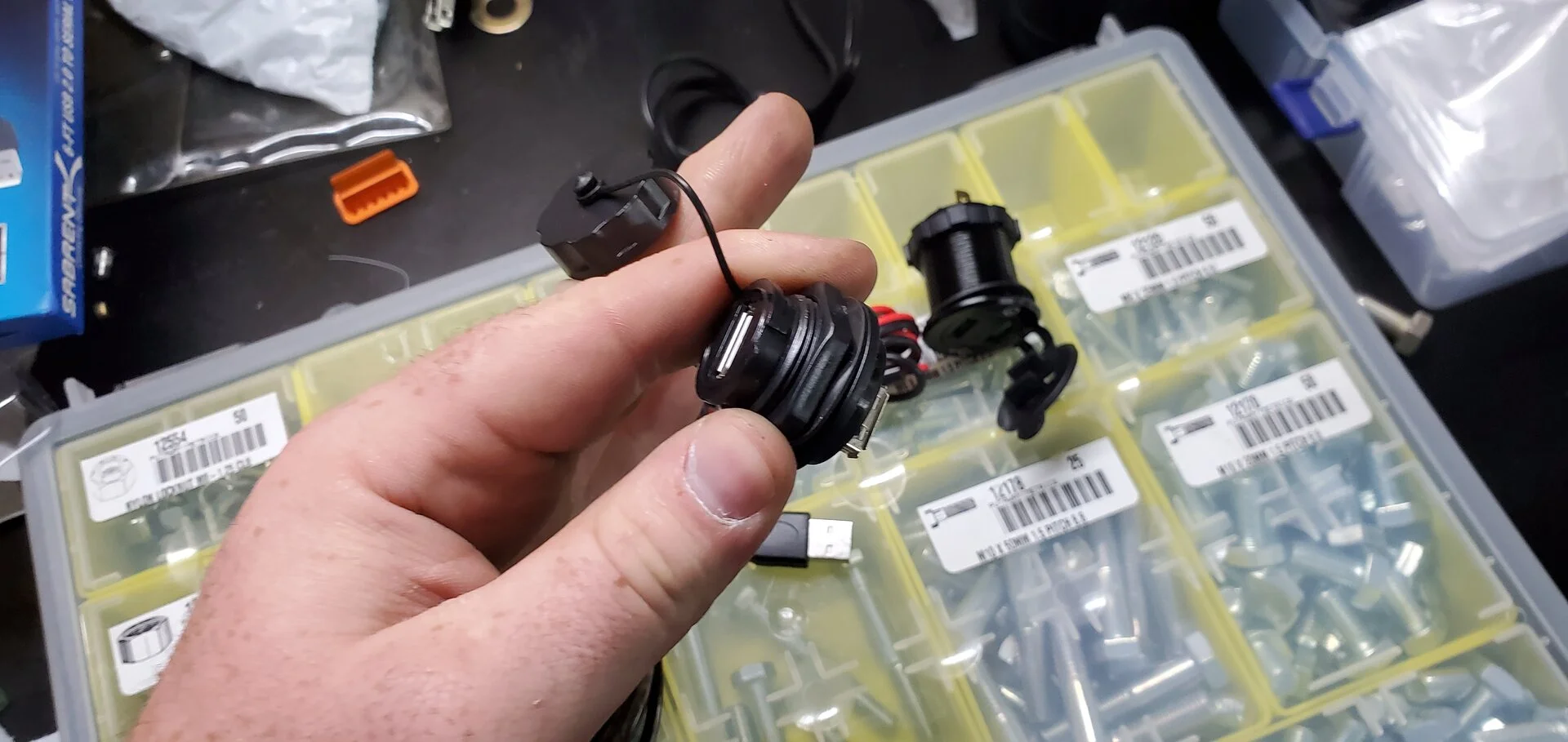

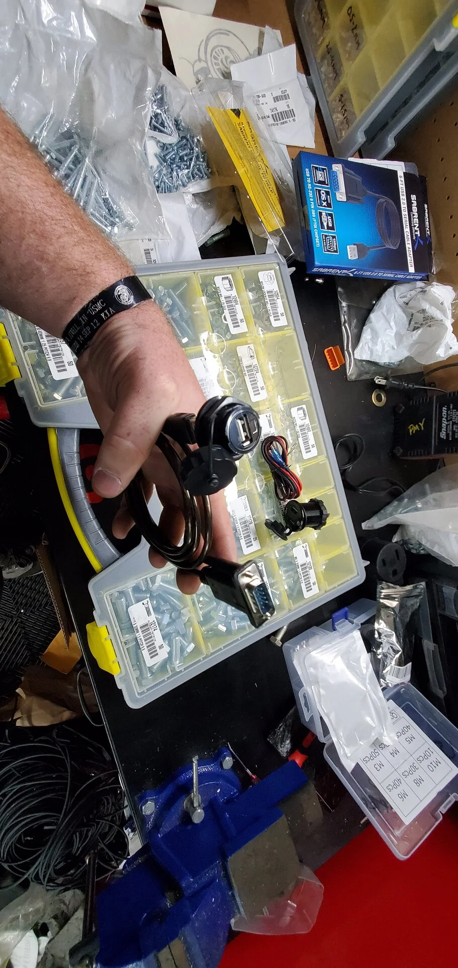

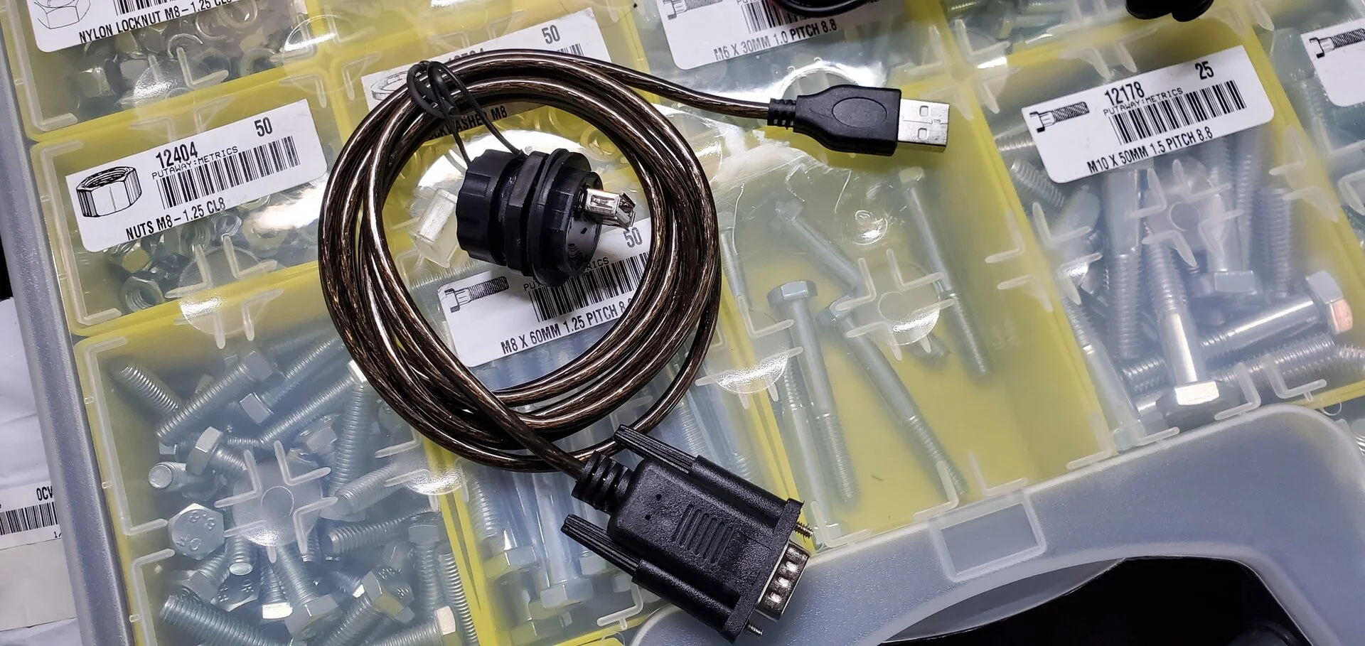

Got some supplies to build a remote USB location for the serial cable. Male to female bulkhead assembly. Started stocking up on electrical supplies for a harness refresh.

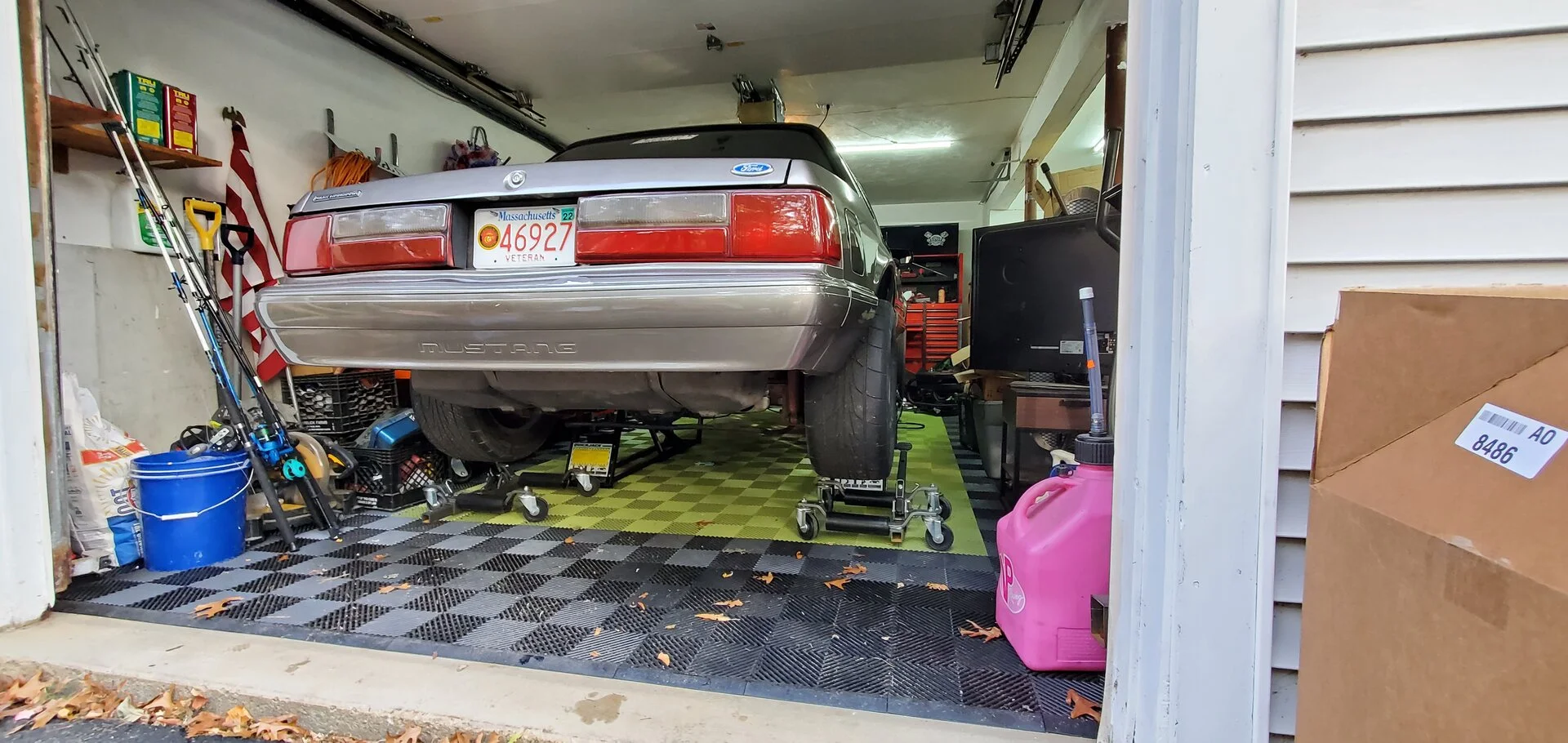

House is finally nearing completion on the interior, ready to get the car into the garage and start tearing it down.

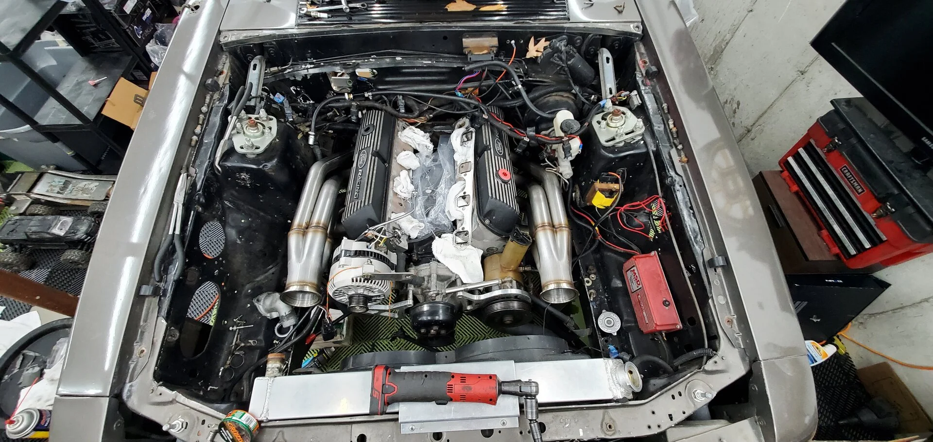

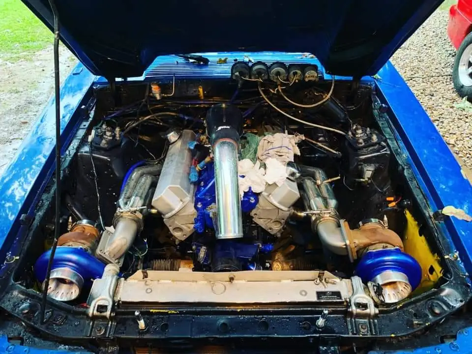

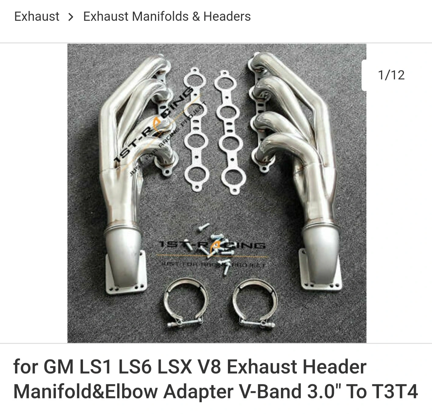

Also decided to go turbo, x2. Going to pick up an LS top/forward twin header kit, chop the flanges and weld on some hi port SBF flanges as I plan on picking up some AFR 185 heads Run VS racing mirrored 67/62s. Feel like this setup,.heads exhaust etc. will be good to grow into in the future as well.
I pretty much have all the sensors and everything from lowdollermotorsports.com that I already had from the Mazda to go turbo on the mustang, map sensor, electronic boost solenoids, Vaccum boost lines and accessories. Have a large stock of 3" aluminum tubing that was going to be used in making the charge system for the Mazda. Will run a 2 in, 1 out style intercooler or ice box I will fabricate myself as well.

Plug clearance looks nil on those headers........
Reactions: ShedBuiltMS
Asked around on the internet about people running them and the plug clearance. Few people commented. Said they had no issues. Guess we will find out. At the price point they are worth grabbing to check while the engine is still in the car atm. If they aren't going to work then it's easy enough to return them.

I have the same USB port for my holley that I mounted in the side of my console it works great

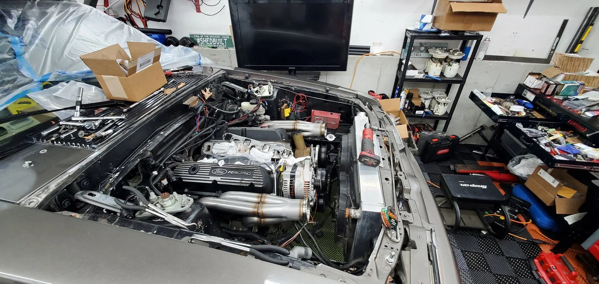

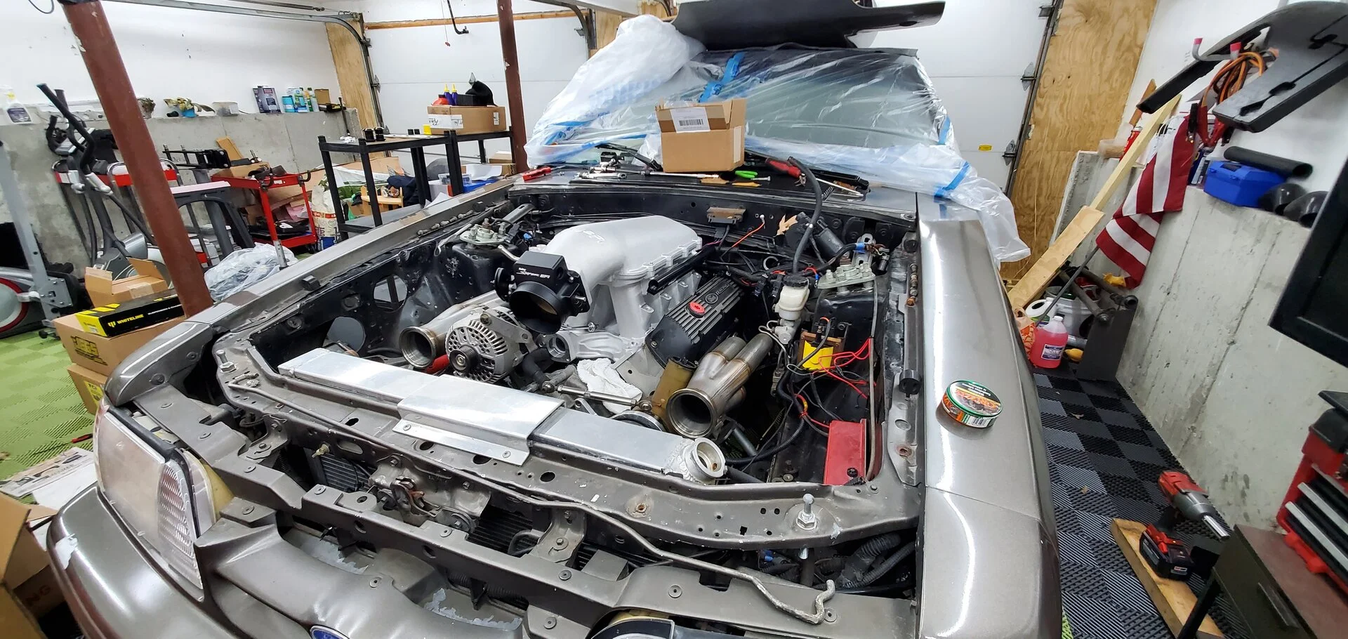

Welp things have gotten a little out of hand but hey.

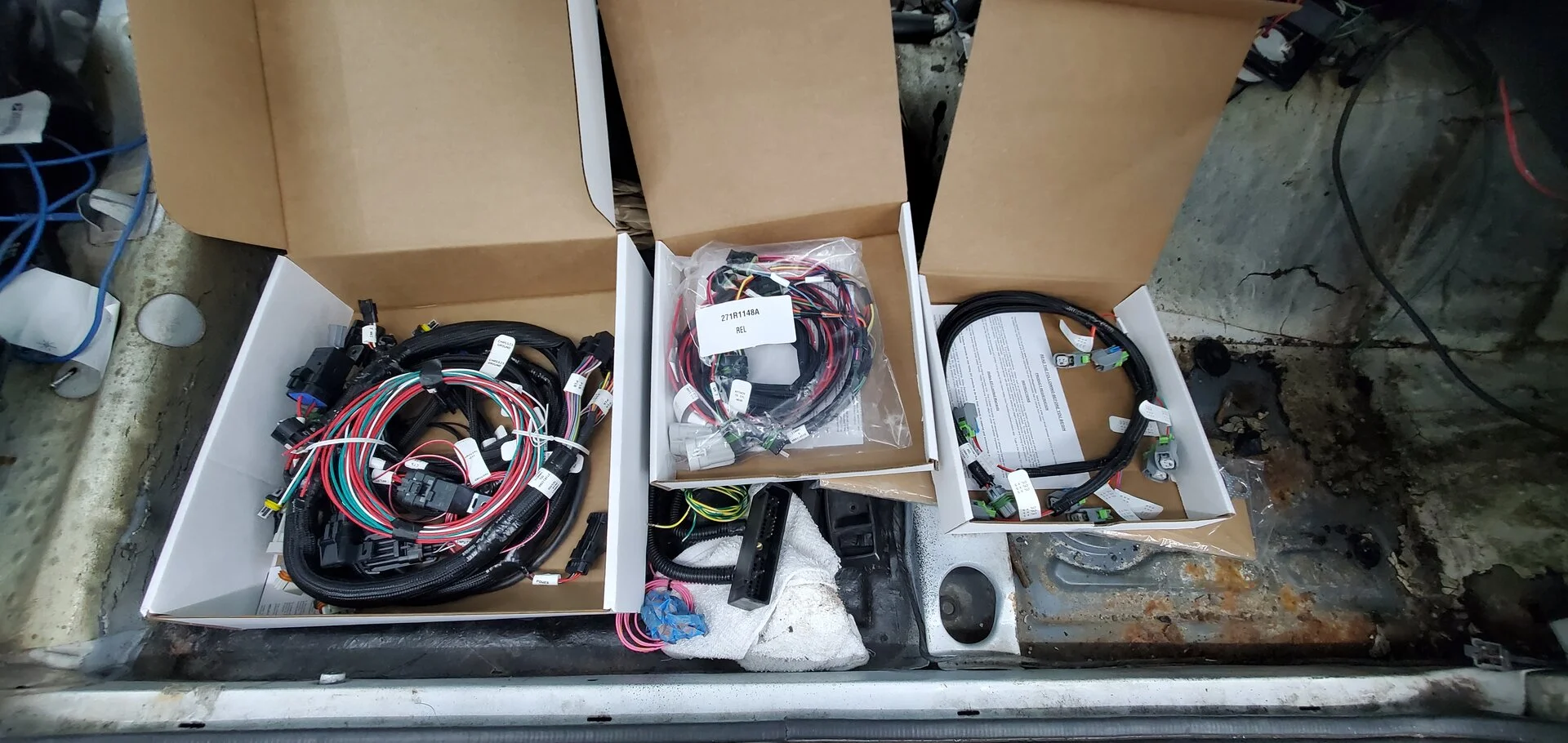

Picked up some holley COP harnesses. Will repin the main connectors for the Megasquirt.

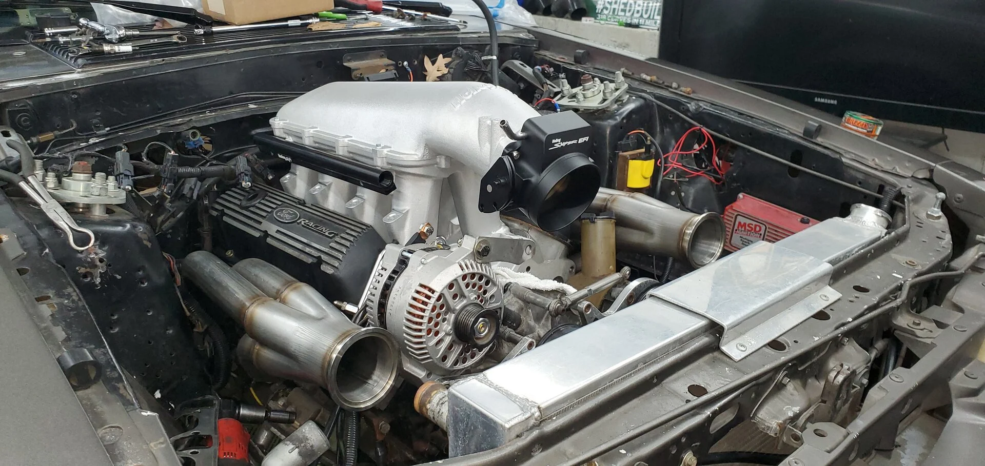

Picked up some LS up and forward turbo manifolds. Mocked up. Looks like fitment will be good. Maybe being the outlets back just a little bit and swap the flanges.
Holley high ram, last minute purchase. I've always seen good things from them on projects I've done. And let's face it. Looks badass ‍♂️
Turbos and piping will be in this week. Can start mocking up all the turbo kit components so I can get that out of the way. Then yanking the motor for a tear down.
