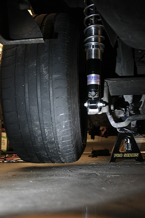

I have a 245 on a 10.5" wheel. The clearance is fine. Even with the coilovers I have plenty of clearance for more tire. I put the 245 on there because I like how it looks, not for clearance. I have a 1/2" spacer on it now but here is how it looked with no spacers at all.
It wasn't the height so much, but the width that had me baffled. Adjust them up...adjust them down, they're still damn near grazing the spring on the coil over. I've still got more than a fingers width with my wheel/tire set up and have got 275's on the back. It seems like the coil overs (although adjustable for height) have quite a bit more body to them than just the shock alone, limiting his room for a wider tire?I know you know this, but I'll split hairs. The coil overs allow more freedom as you can adjust the height. It's where he specifically prefers it that doesn't allow a wider tire.
Are you sure those are 10 1/2" wheels? I wasn't aware than anyone made them 10 1/2" wide in the 4-bolt pattern? I was under the impression that only the 5-bolt SN95 wheels got the additional half inch and that us 4-bolt guys only got the 10" wide wheels? I guess you would know better than me though, since they're on your car?I have a 245 on a 10.5" wheel. The clearance is fine. Even with the coilovers I have plenty of clearance for more tire.
In any case....judging by the pic, it seems like there's next to no room next to the spring. Half a finger width at best? Doesn't leave much room at all for lateral movement....and you'd experience plent of that under hard cornering. Shouldn't be a problem with the 245's though, since you'll never square the sidewalls on them. It's just the look that throws me. But hey....if that's how you like them, who am I to judge?
I see. I'm guessing the spacer is making up for most of that. I too run a 275 on a 9" wheel but I have a bunch of clearance. Still have my quad shocks on actually.
Yea they are 10's lol not sure what I was smoking I just bought them like a month ago and already forgot what size they were. But anyways, if it was a daily driver I would have chosen a different setup, this car maybe sees 100 miles in a month. It's on jack stands 75% of the time.

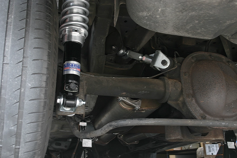

looks nice I'm thinking I'm not gunna go with coilovers in the rear just for clearance since I'm planning on running 315s I'll have 5/16th spacers just to be sure I have clearance but I'm hoping not to have to use them since im gunna beat the hell out of the inside and rool the crap out of the fenders.
do you have a shot of how much the spring comes out of the pocket into the wheel well?
Not sure what you mean?

He is asking if you look at it from the rear straight on, how much closer to the tire sidewall is the spring than the inner fender? Or how much does the spring stick out past the inner fender toward the tire?Not sure what you mean?

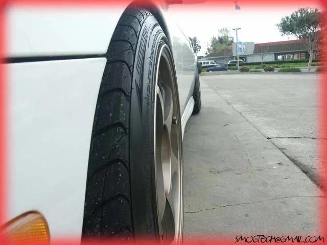

Really....you think a sidewall stretched to this extent is optimal?I don't see the problem with the tire size
I'm not saying it isn't doable...but it isn't exactly ideal. Don't see a problem with it....as long as you avoid the pot holes and don't get too near any curbs....but a wider tire would be a much better option. If you can't fit a tire wide enough for the wheel because of the type of suspension you're running....then it's either a wheel, or a suspension issue....not a tire problem.
*EDIT*....the picture above is actually of a 225/45/17 on a 17x9" wheels. A 245/45/17 on a 17x10" wheel is stretched even more still.

Thanks for the comments guys, everyone has their own opinion and thats fine. SRTthis maybe I am dumb but I am still not sure what youa re asking for lol, the shock goes in the stock location so it pretty much goes inside the inner fender. Its like having a shock that has a 2.5" diameter instead of 1.5" or what ever it is.
Haven't really been able to drive it yet, I got spacers on the rear but I need longer studs before I can actually drive it like that, I kind of put them on there to test fit and see how much longer studs I actually need. Still need to space out the front another 1/4" because the wheels hit the springs on corners. But I'll let you guys know how it is once its up and running. I wanted to drop the rear down more but I cant because the shock bottoms out. I actually have to raise it up a tad more, you would need shorter shocks or something to be able to make it go lower, these cars were not designed to go that low I guess.
Oh...no i missed that part, i was just looking at the footprint width and didn't see the stretch. It's not ideal but eh it still doesn't look horrible. It's no worse than guys running 295+ on 8 inch Welds with an inch+ of sidewall bulge.
