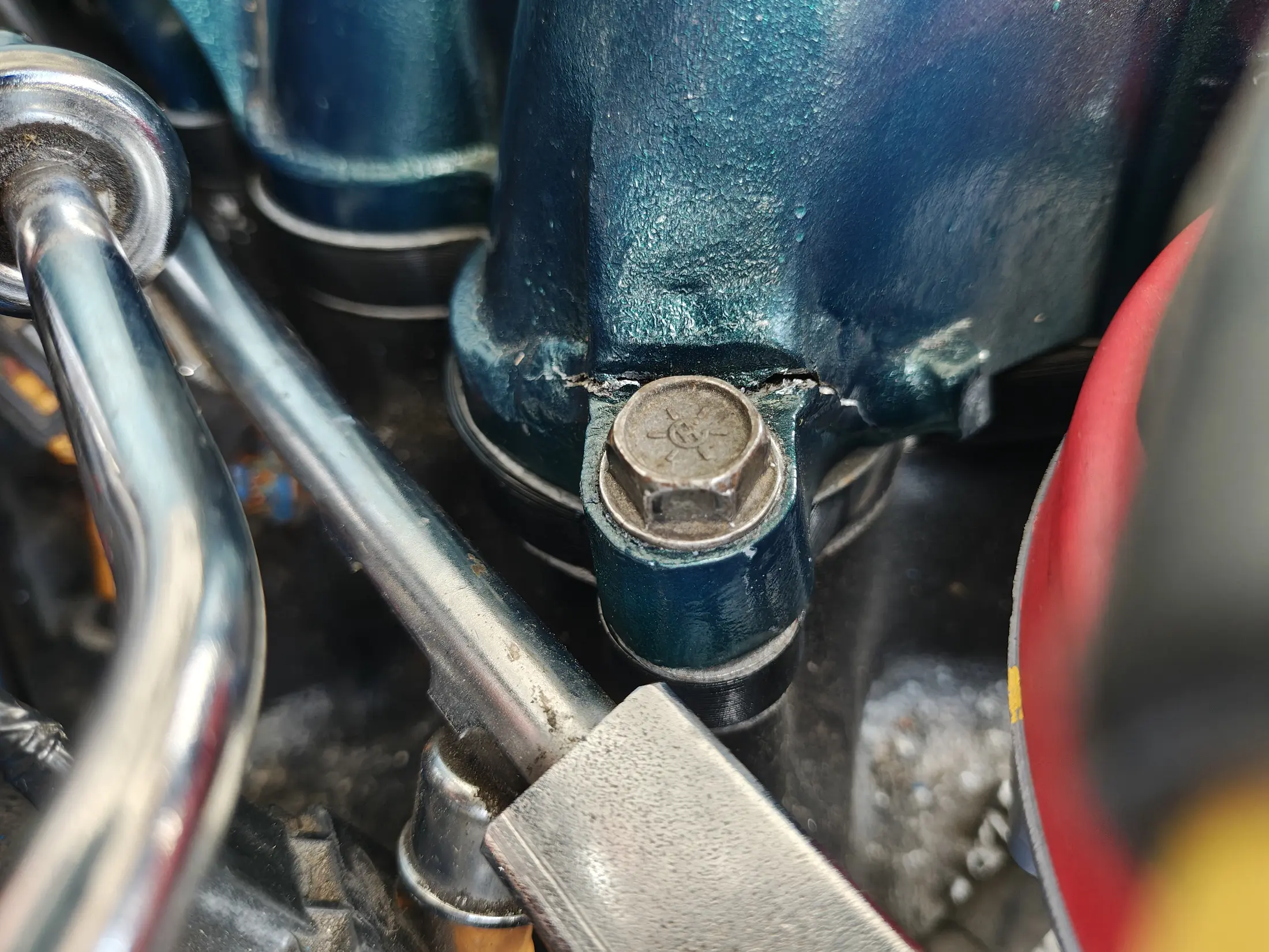

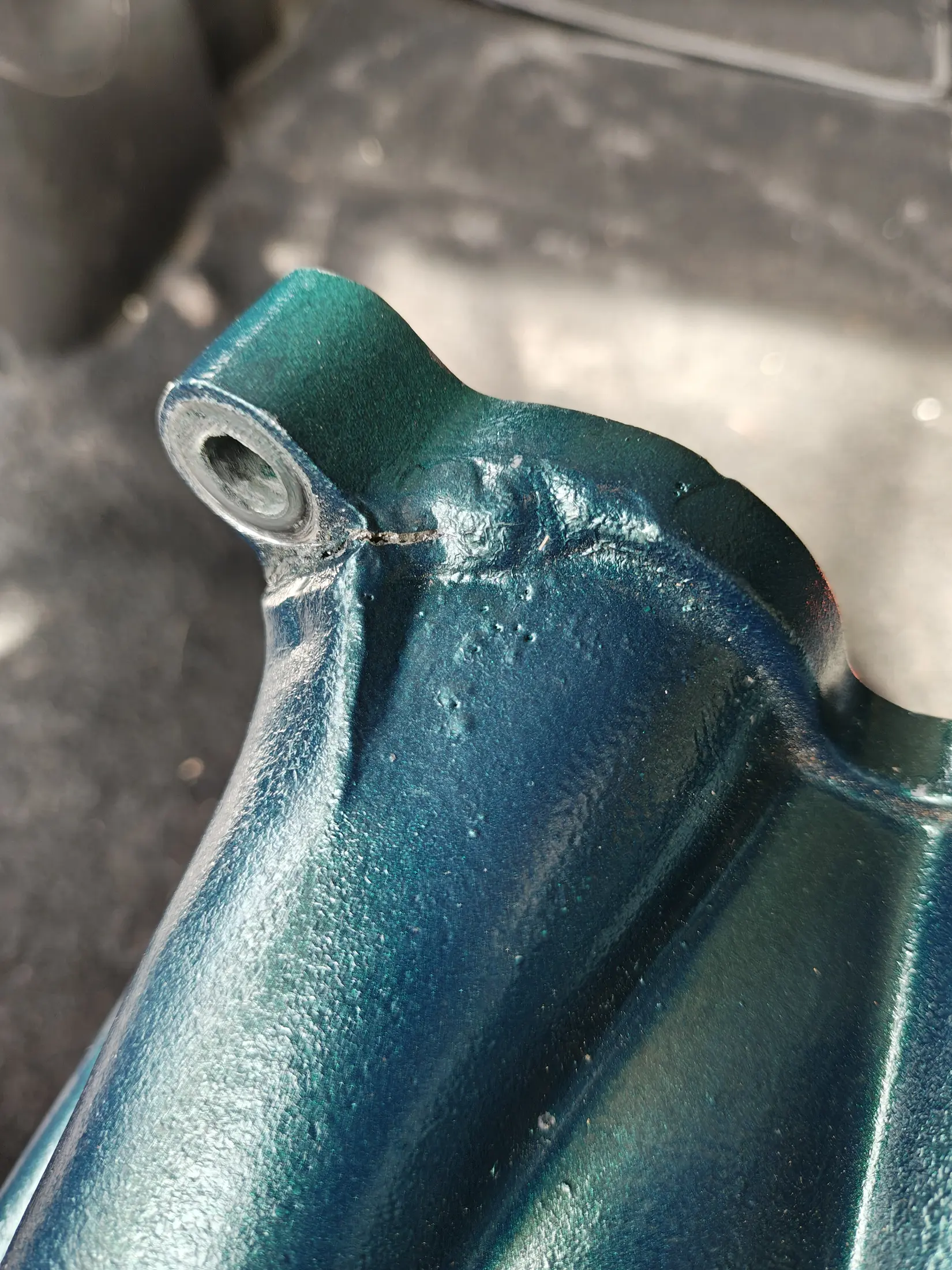

Yup. Will need to be welding back on. Crack probably goes all the way through.
Should be able to reweld it. Key will be creating a groove along the crack to be filled by the new weld.
It definitely goes all the way through. I'll probly just throw this on the shelf and go for something new...er.....better condition. Still tryin to work through this thing since last owner. Rather not have to worry about a twice welded plenum.
I agree about the spacer. I thought about that when it happened. I was only torquing to 18.5. :doh:

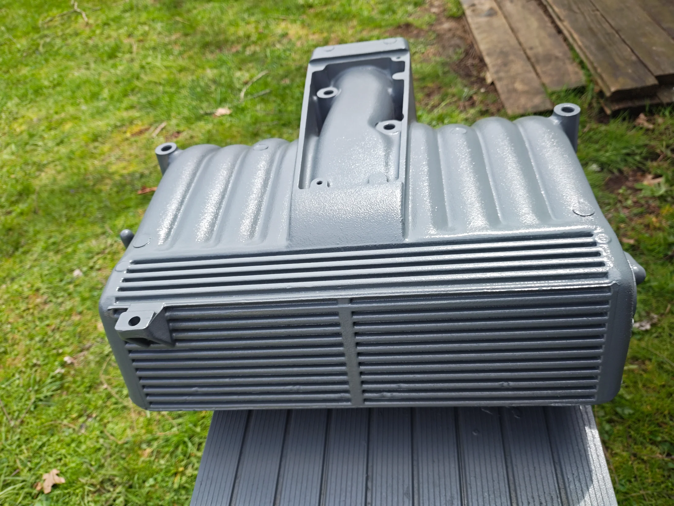

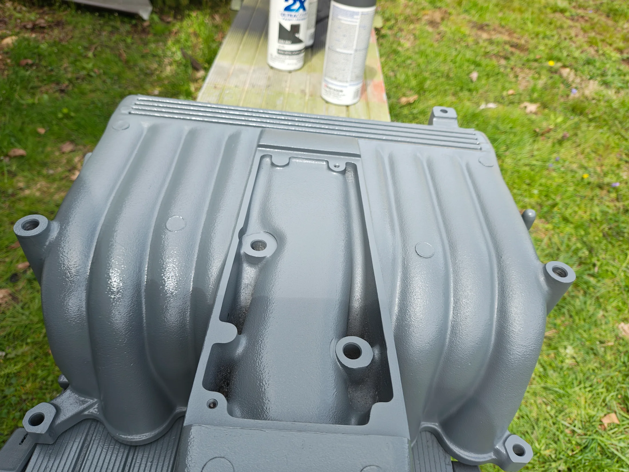

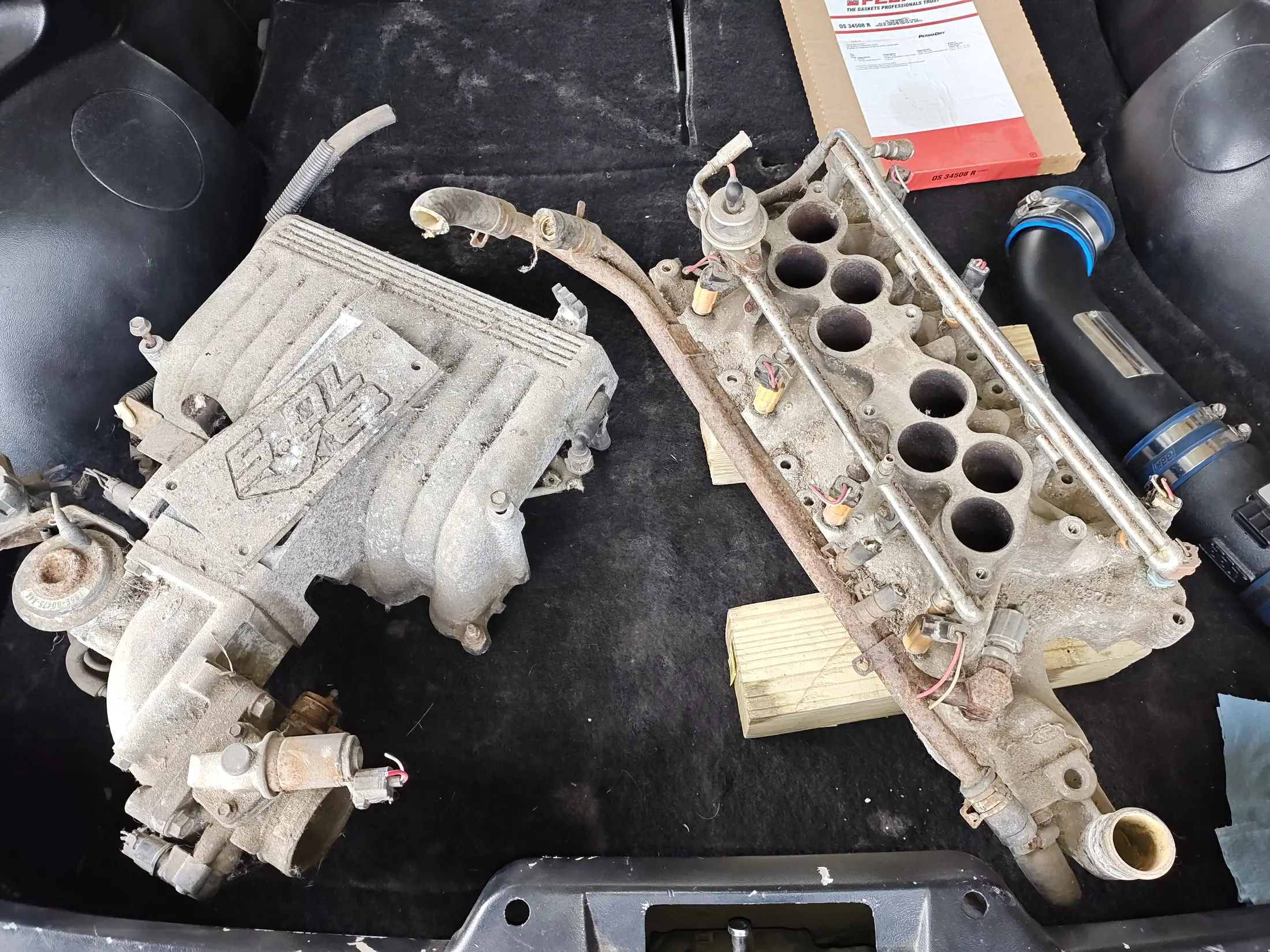

I used different wire wheels on my drill. And used an entire spray bottle of degreaser on interior. Had to get another bottle to finish the job. Picking up kid from school currently. Will post pics of finished product when I get home. Haven't done mating surfaces yet.
Reactions: gkomo

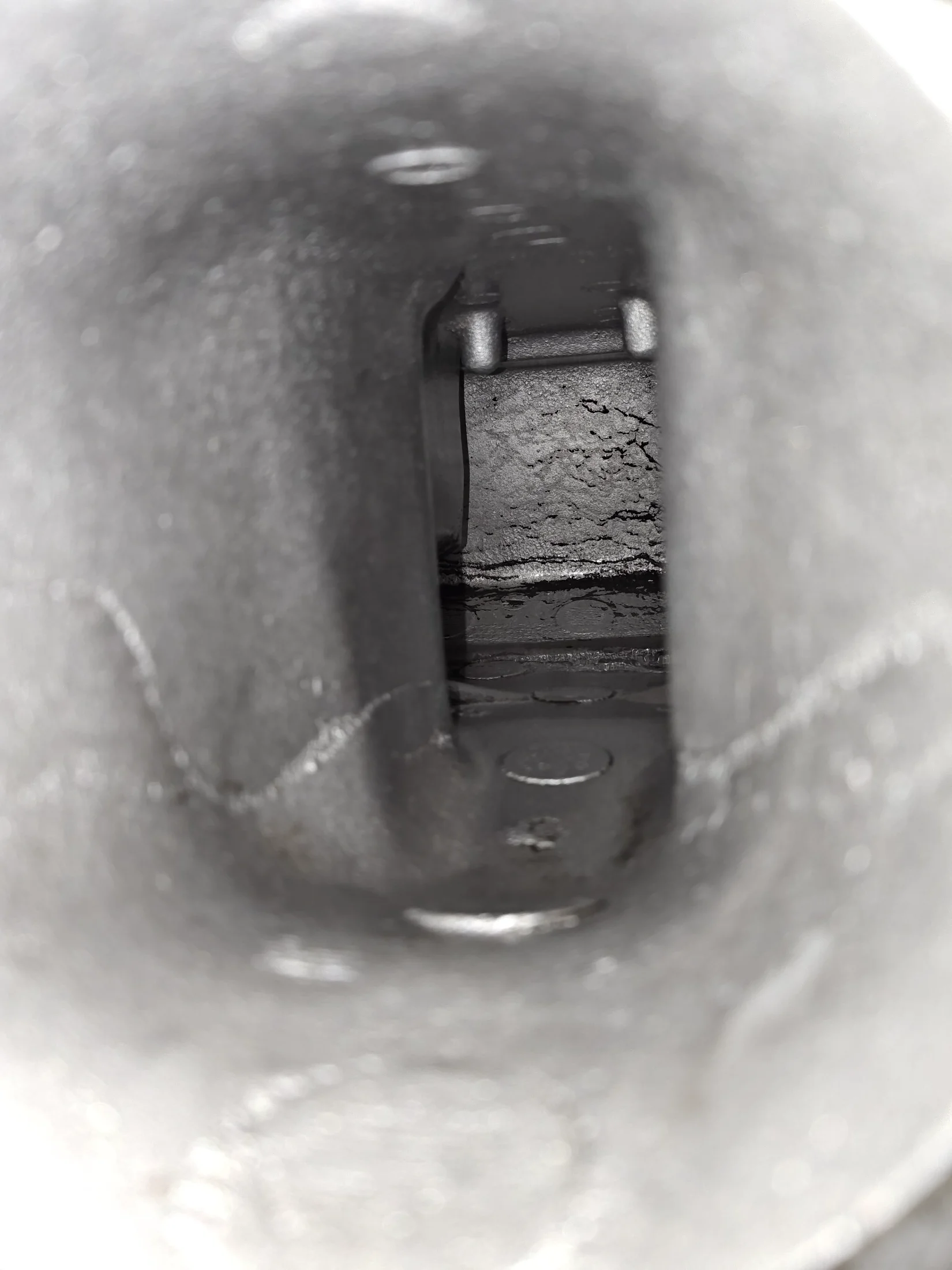

Cleaned up pretty good. Any ideas on how to get the crap inside? You can see it in the right side. It was completely black and coated with oil. Im surprised it turned out the way it did. Would like to get that last little bit in there. Thought about plugging vacuum tubes and dumping some marbles in there with a bunch of degreaser. :chin
