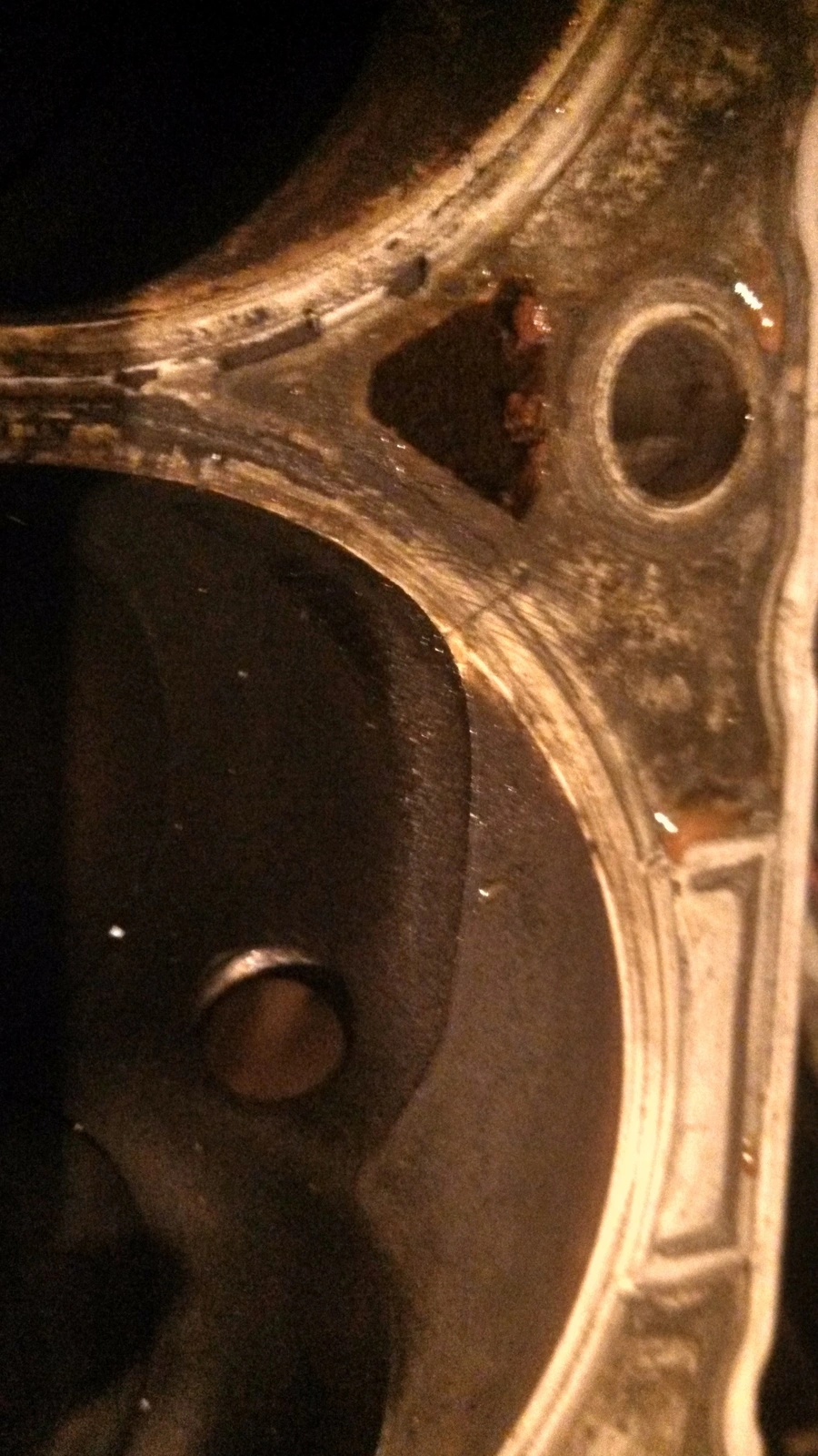

Well, blew the stock aod transmission a few months ago and with kids and work just kinda put the stang away for a while, finally decided to get her going again and bought a built aod for it, I decided to pull the engine and tranny so I could go ahead and replace the rods, mains, and head gaskets.
Well got the top end off and found this, is this repairable? Engine was running perfect with no issues, glad I found it though.
Any suggestions? Would it be easier to just buy a bare head and transfer my valve train over?

This was a common problem with some of the original casting from TFS. I would have the head pressure checked, you may be surprised to find that it doesn't leak at all. I have seen these with visable cracks worse than this and they seal with no trouble. Either way that is very repairable and the repair would typically be far cheaper than replacing the whole cylinder head.
They are the fast as cast 170cc version, dual spring, 10° locks, anyway after some sanding, very fine paper and no pressure it seems to be disappearing, gonna go ahead and take them to machine shop and have it checked, hopefully just have them milled a bit and re-install. Compression should still be OK, running srp flat top 2 valve relief, 58cc chambers, 347.
