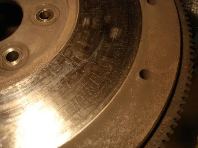

Cracks in my flywheel

I started taking apart my engine and noticed that my flywheel has hairline cracks about an inch long all over the face. What would have caused these cracks? I would figure that the flywheel is no longer usable, does anyone have a recommendation for a flywheel clutch assembly for the 390.

what you are describing is actually heat checking. before tossing the flywheel, have it resurfaced at a good machine shop. if the checking is deep(not usual), then replace the flywheel with one of similar weight. i prefer billit steel wheels, but a good aluminum wheel will work also, as long as it has a steel or bronze insert to handle the load.

like rbohm said, check to see if it can be resurfaced, mine had heat spots and cracks on it, i got an aluminum one and went to put it in and realized my old flywheel was balanced with the engine, so i couldnt use it. So i got the old flywheel resurfaced, and its good as new. Moral of the story, if it aint broke, dont fix it :p
I will look into resurfacing. I’m not sure how deep they are but I can feel most of them with my finger nail. If it can’t be machined I need a 0 balance flywheel.

Ok I found a place that is only 10 minutes or so from my school, Advanced Engine Rebuilding Inc. They quoted me $40. Has anyone in the Cape area heard of them? Here is a picture of the flywheel.

Would there be any real advantage to switching to a steel flywheel instead of having my cast piece resurfaced? Does it grip any better and will be more resistant to cracks? The car only has 50,000 miles on it. My clutch disk also needs to be replaced. It is fraying on the edges. Should I replace the pressure plate too? How is the stock diaphragm spring? At this point should I just replace it too? Does anyone have a recommendation on brands that won’t break the bank but will hold up to the occasional trip to the track.

Any flywheel can be resurfaced. The cracks are a result of heat and are pretty common. At what point you need to worry about them is up for debate, usually depending on your wallet and whether or not it's a daily driver. You can look at old pictures of where a flywheel explosion has sawed a front engine dragster in half, Big Daddy almost lost his foot because of one, hence he developed the modern rear engine dragster.
